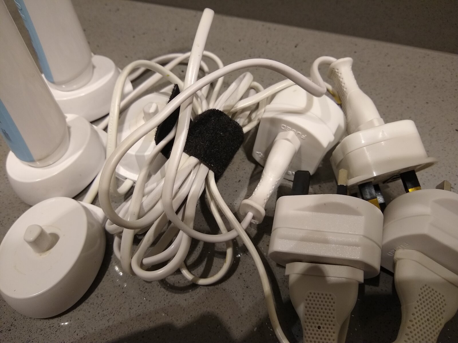

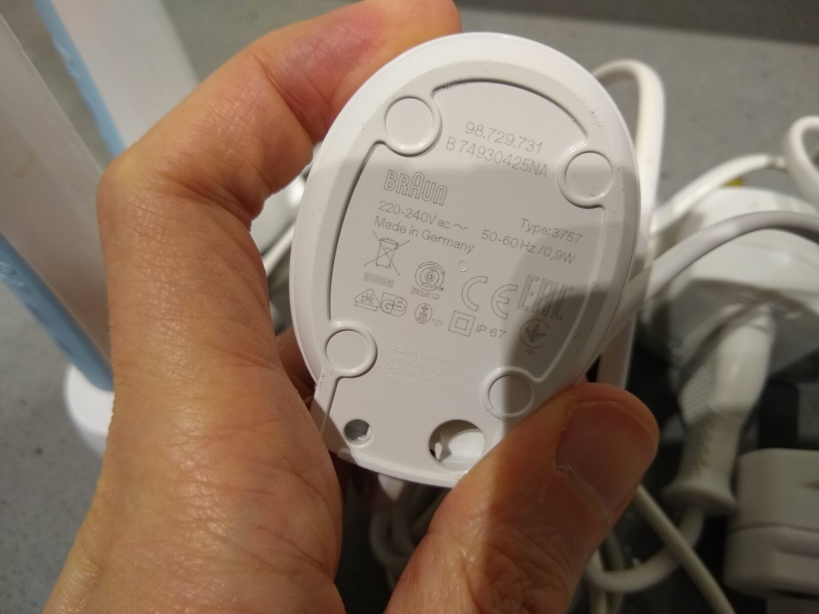

Hi All
I have four toothbrush chargers (240v 0.9w each) taking up a double socket (3xblock and a single). I just saw that the 3xblock developed a crack in the housing so instead of replacing I'm looking for a way to get these four chargers working off a single plug.
One option might be to use terminal blocks to join these somehow, or to solder and heat shrink. Because the wattage is so low I'm thinking that done the right way, this will be safe.
Any suggestions / advice much appreciated.
Many thanks

I think it's quite clear from the photos that OP is using 3pin mains adaptors and not a shaver socket. Best advice is use two chargers and rotate the toothbrushes around. We have two if these and only 1 charger. They only need charging every 5 days or so.

Good reality check - I'll just charge two at a time and rotate. Why didn't I think of that....!
Also liked the idea of just fitting a 3-pin plug and ditching the adapters.

you would have to be very neat and tidy with the cabling inside but you could wire all four to one 3 pin plug
