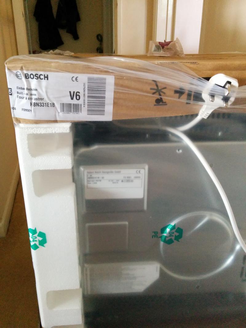

Hi all,
I have a old freestanding electric double over with hob that I was hoping to replace with a single built in oven and hob.
The old cooker is connected to a spur below the counter and a 6mm2 T&E tail to the appliance.
The spur above is connected to a red cooker switch with a 10mm2 T&E, which then leads to the CU on a separate 30amp circuit with 10mm2.
I purchased a 16amp 2.9kW oven, and 6.6kW hob. Sadly, the oven has been shipped with a 13amp plug(!), even though it never mentioned it would.
Before I send this thing back and waste time I thought I would ask you clever lot if it was possible to still hardwire this oven regardless? I don't want the extra expense of getting in an eletrictian to add addition 13amp switched FCU.
Surely if the load ia fixed then I should be good to simply hardwire both the exiting spur.
If you need any additional images, I will be happy to include.

If the instructions say that the oven must be protected by a 13A due, then the plug needs to stay. If you cut the plug off, then the only protection will be a 32amp breaker in the consumer unit, and that's not good.
The solution needs some minor electrical work.
Where the cooker connection point is, you need to remove this and change the back box for a dual box.
http://www.screwfix.com/p/appleby-galvanised-steel-dual-35mm/48234?_requestid=186841
Then, put a single 13A socket in one side of the box (for your oven). The existing cooker connection point will go in the other half of the box to feed the hob. That's it, job done.

Well the conundrum continues. I went and did just that, read the instructions. The instructions clearly say:
Do not connect the appliance with a 13a fuse?? Wtf Bosch. Its got a 13a plug and cable...

EDIT: Time to phone Bosch. There will be a helpline number on the instructions.
Confirmed by Bosch. I can use the plug that comes standard, or if simply remove the plug/cable and I am able to hardwire it. Confusing much!
Using a fused connection unit (FCU) and hard wired compared with using a plug and socket is nearly the same.
All fuses produce heat with a FCU this heat is dissipated into the wall with a plug it needs free air to remove the heat (or fan assisted where the oven has a cooling fan).
So the option is yours FCU or Plug.
Not really.
The fuse is to protect the cable.
A 13A moulded plug will have a 13A rated cable.
Get some 2.5mm² flex (heat resistant will be recommended) and a dual outlet cooker connection unit and connect both the oven and hob to the existing cable.

2.5mm protected by a 32a mcb ;) !!!!!

Are you sure about that? If Bosch say it is OK to cut the plug off, he would use the supplied 2.5mm² to connect to the CCU

433.3.1(ii)
So, replacing a double back box with a dual back box and fitting a socket is less hassle than replacing the cable, is it? ;) ;)
