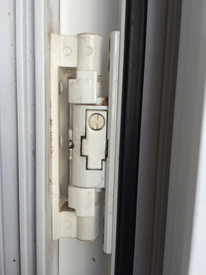

Could anyone please advise if this type of hinge on french doors can be adjusted please? There is daylight through at the bottom of where the two doors meet as one door is not hanging straight. any help and advice would be gratefully received so i don't freeze through the winter. Many thanks

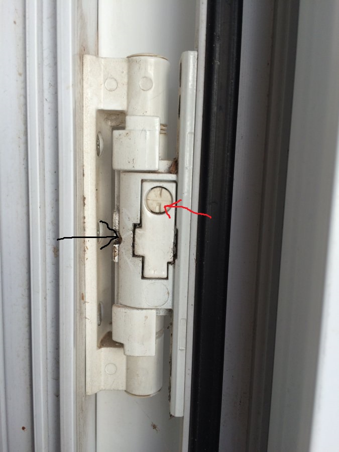

Old Profle 22 Hinge.jpg These hinges were fitted to Profile 22 doors many years ago. They can be adjusted a certain amount by using a small allen key where I have drawn the black arrow. The red arrow shows the piece covering the adjusting screw which when turned 90 degrees can be removed if needed, but you shouldn't need to do this. Also check that the glass doesn't need repacking.

Thank you so much Meldrew4291. I will give that a go tomorrow and see if I can adjust it as you have suggested. Very grateful for your reply.
