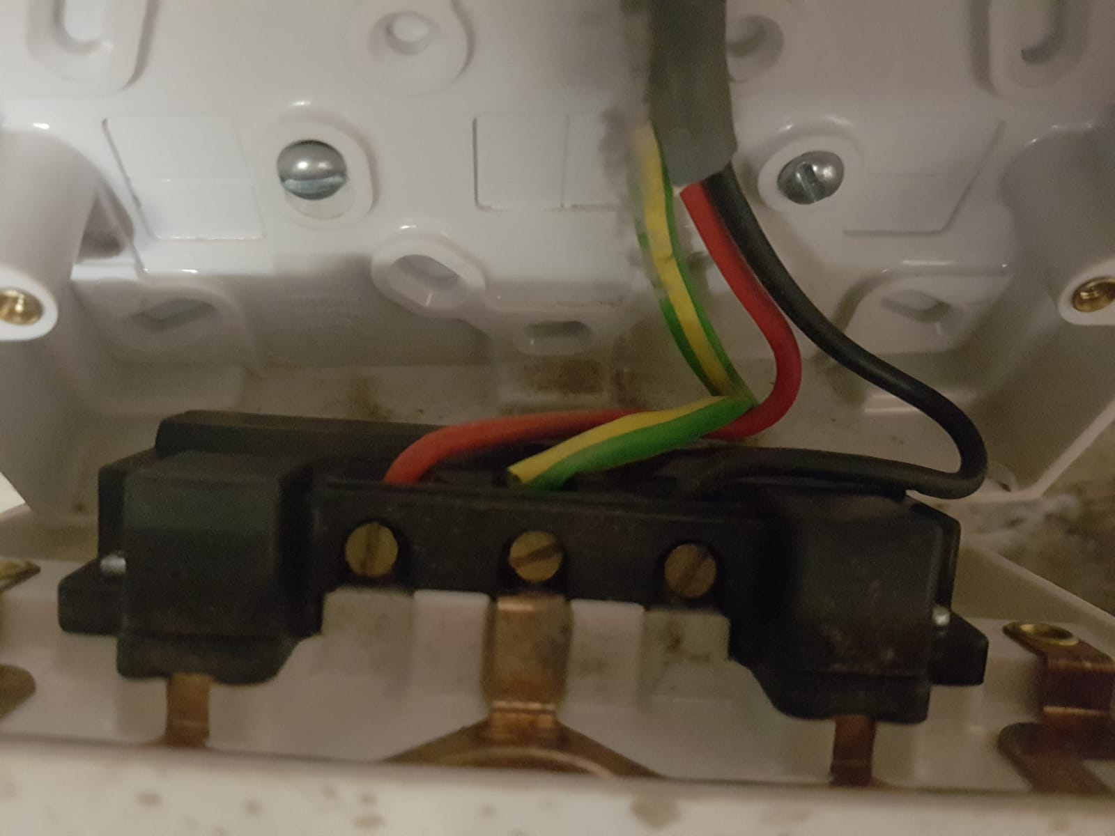

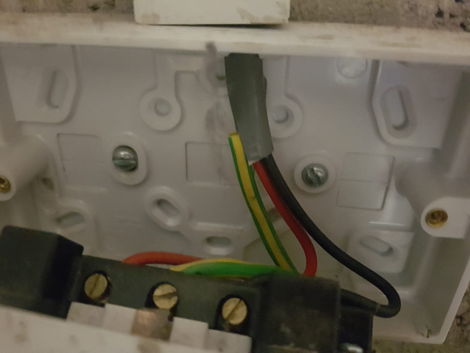

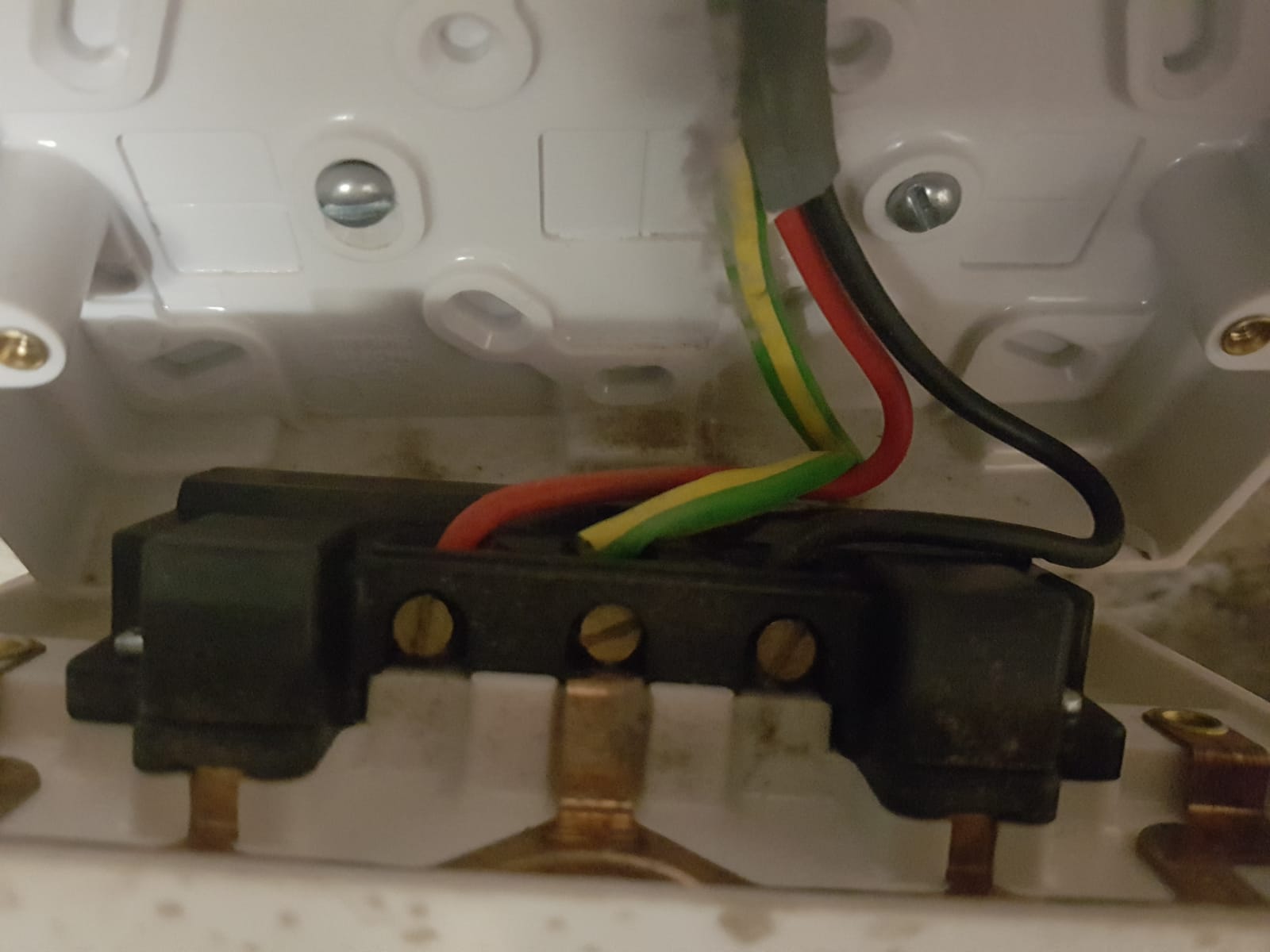

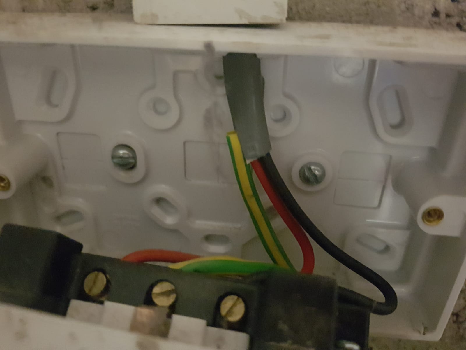

does every socket have a cable coming in and going out at the moment (i.e a Ring)
do you know what size cable it is ?
I am also wondering if ring or radial with 2.5mm or 4mm so no real answer as to regs, but only the washer is large load, so unlikely to be a problem, but pictures always good.

The socket where the appliances are just has the one cable going into it. This comes straight from the fuse board.
Looks just about 2.5mm to me.
I think you need to run another cable really. 4mm ideally.
Or change Mcb to b20 or 25

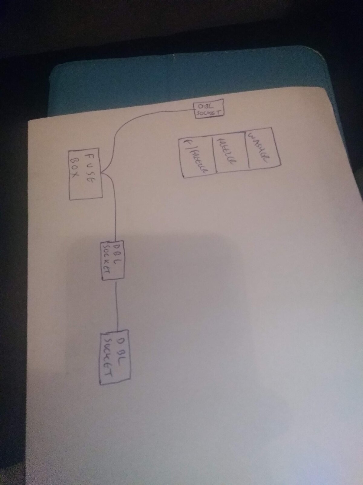

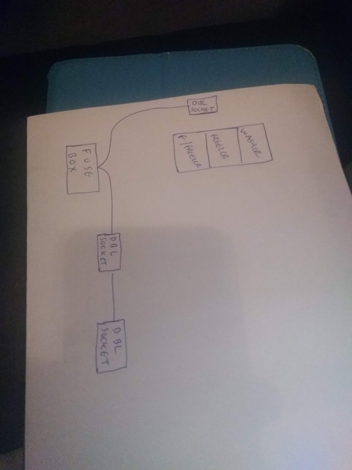

All 3 of the sockets on the rough drawing are served by the same 32A. How do you mean by between 2 existing as they are other side of the garage. Hopefully the drawing show what I mean.

That is a shame. Earlier posts implied that the sockets were completely separated. You can still convert to a ring by bringing a cable from the last socket back to the breaker on the distribution board. BTW, does the middle socket in your diagram have 2 cables in it?
