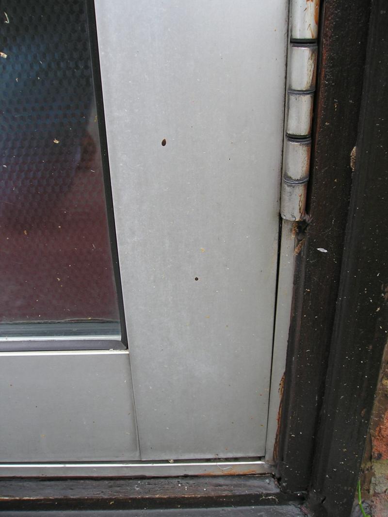

My front door on my porch seems to have moved slightly, and is no longer sitting 'squarely' on it's frame. Consequently, the door is not shutting propertly and intereferes with the frame when I shut the door.
The bottom-right of the door is sitting tight on the frame and the top-right has a gap.
It is a double-glazed type door and I have attached some pictures to show the problem.
Is there any way to make an adjustment for this type of door (I can't see any way to adjust it) ?

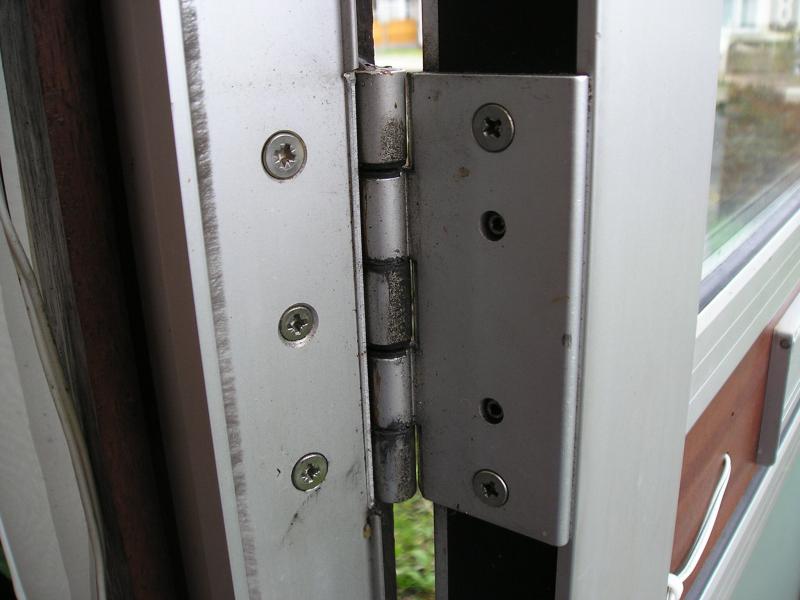

SILLY Q,but have you tightened up the top hinge?
is that a allen nut between the screws?if so have you tried adjusting it?
All hinges are tight.
I think there is slight wear on the hinges.
I was wondering what the Allen keys were for on the door-side of the hinges.
There's a gap on the bottom left side of the door so the bottom right hinges need packing out but undo the middle hinges first, if that doesn't do it then will need toe & heeling method
Loosen the hinges screws then tighten the allen key to pack it out then tighten the screws
You say "The bottom-right of the door is sitting tight on the frame and the top-right has a gap. "
Are you sure of this? The pictures seem to suggest the opposite (ie gap at bottom right). It's pretty well impossible for a plastic door to drop on the hinge side (unless the hinges are loose), but they drop like mad on the lock side at the first hint of sunshine. "Toeing and heeling" will cure the problem. See http://www.doubleglazing.com/diy_toeing_heeling.htm for details
The bottom right door edge is touching the frame and opposite on the left there's a enough gap to play with because the left side of the door is almost touching or rubbing on the cill. Failing that then toe & heeling
To clarify things, when looking face-on to the front of the house, the door has shifted anti-clockwise, by about 2-3 mm. (1.e. dropped on the lock-side). Doesn't seem alot, but it means that I have difficulty in closing the door.
By the way, the door is not plastic, but metal.

I have tried adjusting the allen keys.
They seem to do nothing at all (some were loose).
Tightening doesn't seem to do anything.
Whay I have noticed is, that there seems to be quite a bit of wear in the hinges, which have allowed the door to drop, and also there is movement cross-ways on the hinges.
I think I should replace the hinges.
