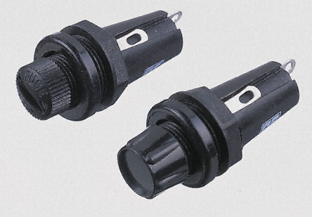

The solution I've thought of is to have 2 fuses after the fan isolation switch, one in each live. The switch will be outside the bathroom, so would panel fuseholders of this type:
mounted on a blanking plate be allowable?
Can the connections to the fuseholders be soldered, or must they be crimped?

Also the fuse holdes you show could not be connected to a 6 or 10mm cable
Yo - I just chose that image to illustrate the type of fuseholder I meant - others are available with larger terminals.
