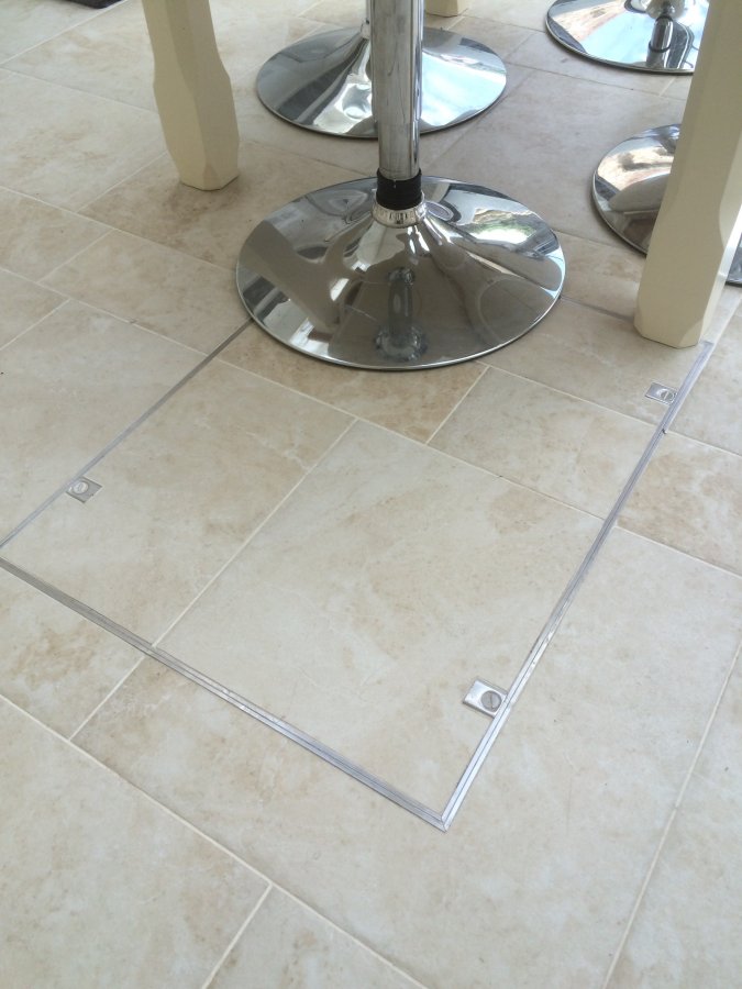

Internal manholes do have a bad press as people assume their house will flood with effluent the moment the drain blocks. But if they’re sealed and the seals and the drains are properly maintained/inspected there’s little risk of that. There will be issues with what types of floor finish you can stick down for example laminate will remove access so is a no-no and carpet would need lifting to gain access.
Yes - a double sealed access cover does the job every time. I have my favourite (sad but true) and done properly, they look smart too.

Tbh if we have a cctv drain survey done and if the small is ok (i'll go there and have another sniff around - will suspect something if they are overdosing on air freshners) then it may put my mind at rest but my mother wants us to run now. And I can imagine when it comes to selling it will be a problem. Especially as it restricts any further building work. Nakajo - does the double sealed access cover affect the level of the floor so will it be obvious that there is a manhole there?

Here's a photo of a typical double sealed access cover.
Actually, I don't like this one because the plates at the bolt fixings look a bit cheap. But there other makes available which look smarter.
