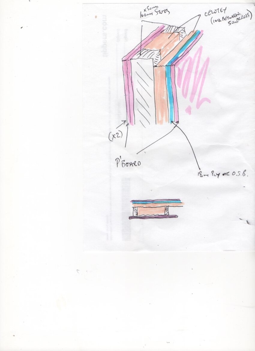

My question is about the above- stud wall, battens on the internal blocks for plasterboard and flooring.
Is it ok to batten the walls and erect the studwall to the concrete floor (with DPM) and then lay the timber floor joists up to the battens or stud.
Or should the floor joists be put down first so they are flush to the walls then install studwall on to the joists?

I would like to batten the garage walls and build the studs to the current concrete floor, then build the floor framework inside that afterwards, again leaving open so inspector can see where I will fill the floor with PIR.
It doesn't sound like doing it this way round is a problem, but any advice is greatly appreciated?

You will need a further say 50mm across the studs (as well as between) also. We use fire rated plasterboards on the garage side.

Wall first so that you have (vertical) continuity on the garage side.
Is it ok to just put strips over the studs then fasten the plaster board through the PIR strips into the stud?
You could, but this won't satisfy reg's. In fact, since last June, the requirement is even greater.
Our last stud (garage) partition form inside to out...
12.5mm plain plasterboards, taped and skimmed.
18mm OSB (customer wanted to fix anywhere).
50mm Celotex across the studs, all joints foil taped
100mm studs with 100mm Celotex between, all joints foil taped.
Two layers of fireboards with joints staggered, taped and skimmed.

I can understand the 50mm over the studs to prevent thermal bridging through the timber.
Did you box in the studwork with 50mm then 100mm in the cavity?
Also, I though the objective was to reach a minimum thermal value.
Did the BCO calculate the thermal value of that, or did they just pluck it out of the air?
And what was the purpose of the OSB?
Yeah. 50mm across with 100mm between.

No. I just went on past experience (vaulted roofs etc). BC were happy though.
Just a fixing benefit for the customer. Nowt worse than trying to locate studs 3 months on.

With the 50mm PIR around the stud, and the cavity filled with 100mm. Were you left with a 50mm void?
