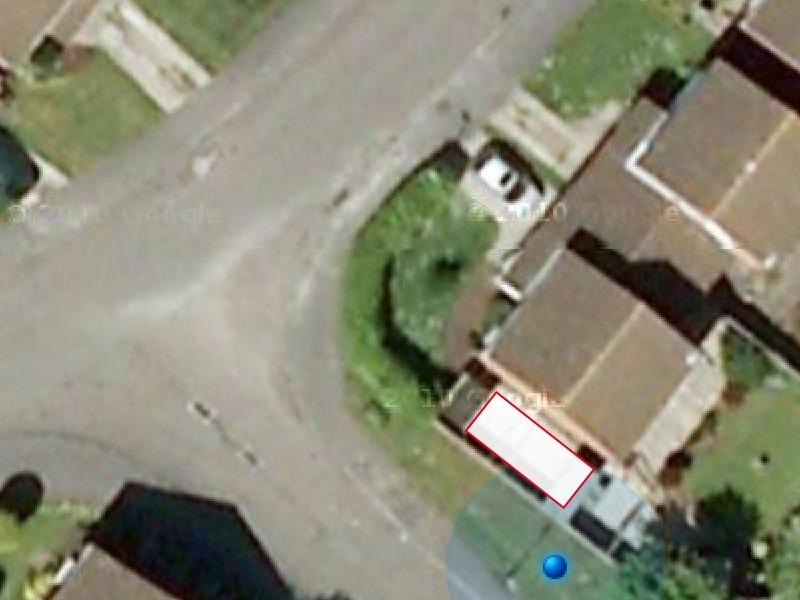

So I have looked and, from what I can see, have decided no planning permission is required if I want to put a 20' x 8' shipping container in my garden to use as 50% office and 50% storage.
The location is down the side of my house between house and boundary wall, you can see it in this old google maps view where the previous owner has dog kennels and I've drawn a slightly container sized rectangle:
Containers are 8' tall so it would stick out about 2' above the boundary wall but I will address that in another sub forum, here is my remarkably brilliant iPad illustration that may win some photoshop awards:
This is, IMO, an outbuilding and therefore subject to the following restrictions within which it fits. Is everyone here of the same opinion and therefore agree no Planning Permission is required?

Its a side fronting a highway, you need PP
Also, the containers will constitute operational development and not be outbuildings under PD

You may be more likely to get PP if you made it look less container-like
Yep, my thoughts exactly, hence I didn't want it to require permission!
I think, to top it all off, we're classed as an AONB too so the container look of a container is not going to float many planning permission boats.
Quite what is O, N or B about my house I'm not sure but I guess it just compliments the Chilterns!
Loads of space for a proper brick extension that would, IMO, gain PP with no probs but this was supposed to be a quick and cheap way of getting me out of the house. Looks like I may need to come up with another solution...
