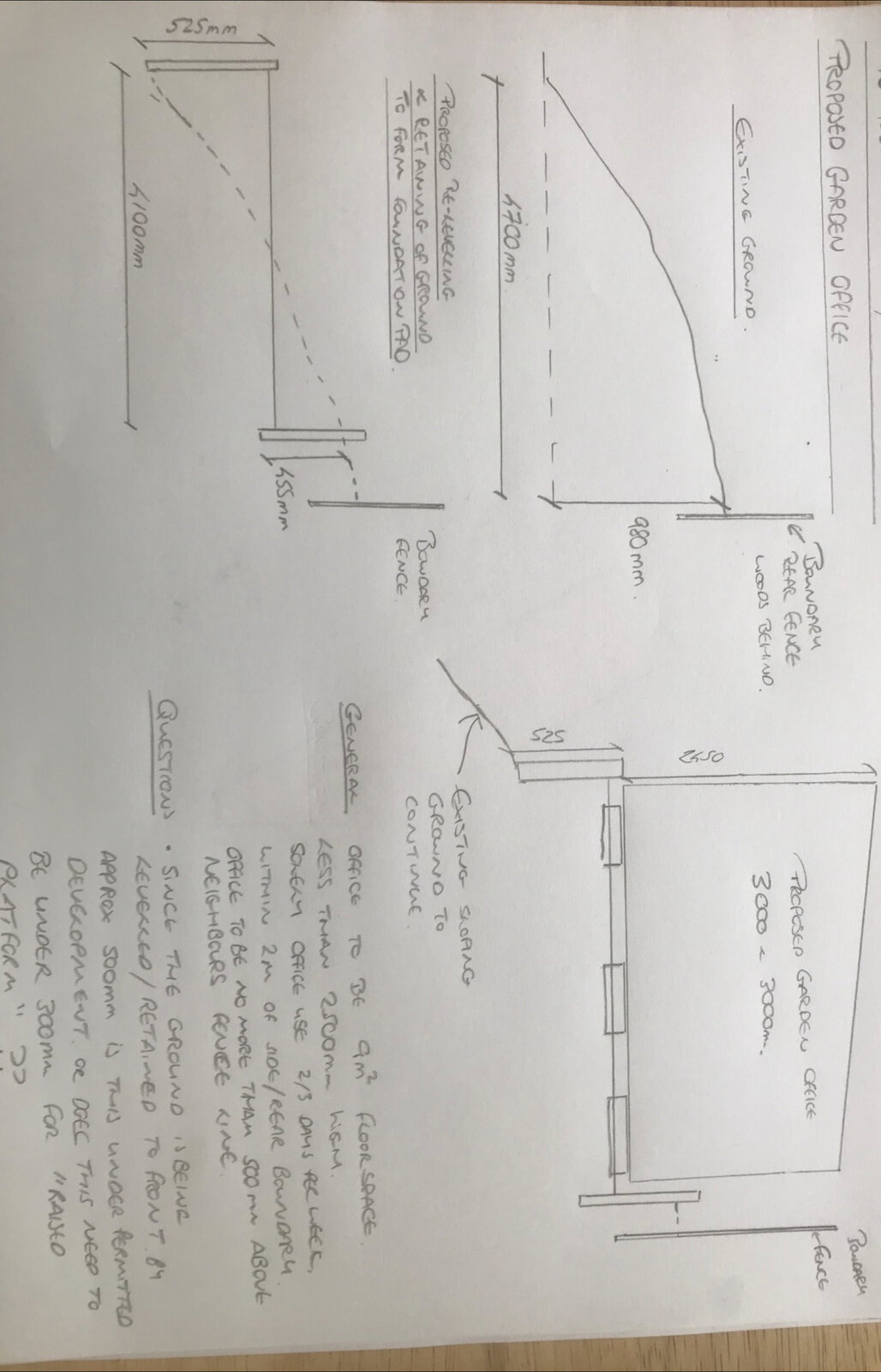

Hi all;
I’m planning on building a garden office on a steep slope in our garden and all aspects comply with permitted development apart from one area I am unclear on....
my intention was to cut/fill level the existing slope and retain it with a full retaining wall.
The front elevation of the wall will be approx 550mm off the existing sloped ground level, the rear cut in approx 495mm.
The ground will be levelled to the top of the retaining wall and then the garden office built on top potentially with a thin decking step to the front I.e. walk up a set of steps on the front 550mm elevation onto decking (Below 300mm high) then into office.
By retaining this ground have I inadvertently created a ‘raised platform’ over 300mm which is not permitted or have I created a retaining wall with land behind which is under 1m high and permitted....
Any help/advice would be appreciated.
Pete

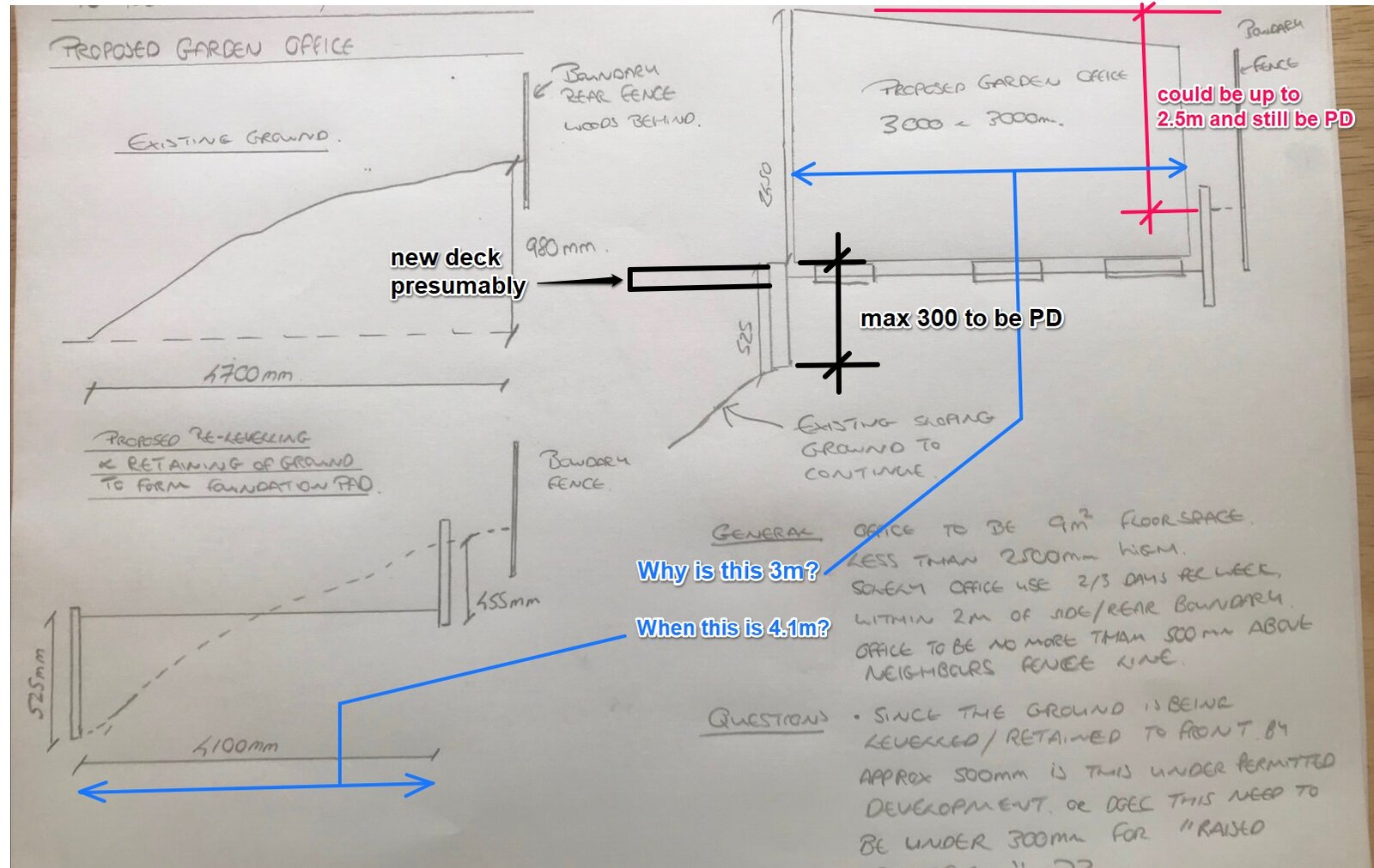

There's something not quite right about your dimensions - see the blue notes.

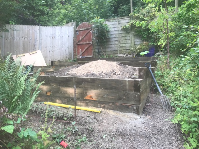

Sorry for the delay:
Freddie - the dims on the drawing highlighted were different as the office is 3 x 3 and I was intending to put some decking at the front of the platform so you walk up to the ‘raised platform’ up some steps then on top of th platform have approx 800mm wide full width decking before stepping into the office. In reality it doesn’t need to have decking and could ultimately be right at the front of the platform, to almost give it an infinity look....
the only reason for a retaining wall was for neatness and essentially allowing me to form a pad. My intention was to install 9 foundation piers under the shed. We back onto the woods and I had thought about cracking on however one of the neighbours is a councillor and militant when anyone has any building materials delivered!‍♂️ Although she hates any new builds etc she doesn’t care her conifers are so tall they pretty make her house a hobbit hollow...
As I’ve read a retaining wall can be up to 2m or 1m within a highway and be permitted development and its hardly a feat of engineering being made out of sleepers with drainage behind, my view was anything over a days graft could be classed as engineering but the full retention excavation etc was only a day by the time I’d mixed up the concrete and wheelbarrowed up up my ski slope garden....
The whole situation seems to be so unclear I decided to pay for the privilege to the council for their ‘planning advice’ service as it’s pointless me cracking on based upon my viewpoint.... I’ll let you all know once the council reply (or are they still on furlough...)

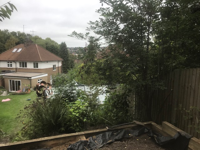

pic of my current state of affairs - although I’ve stopped works for the moment.......
I could always drop the level to 300mm on the retaining wall at the front, increase the wall height at the back then cut into the hillside - be a decent could of grab lorries away but probably cheaper than PP in all, plus my foundations wouldn’t need to be as deep as I’d hit the chalk a bit sooner..... ultimately though if I had the decking on top of the sleeper wall height this would again be over the 300mm height allowed ...!?!?
