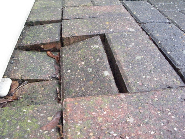

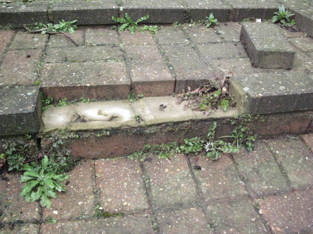

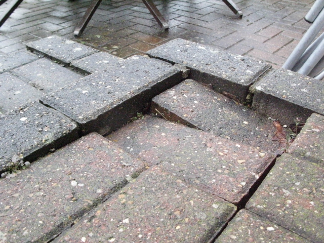

Hello, Wife is nagging me to repair lose and dropped bricks in the garden. Pics attached.
I have spare bricks and need to know what kind of cement please, how to go about it, how to secure them well etc. Look forward to hearing, nice Easter to you all.

The first couple of pics look like maybe they were laid on sand which has washed away, or something.
You need to first lift the loose / sunken bricks and see what has happened underneath.
Thank you Endecotp, it seems that it is as you say a bit wishy washy, It may be that the hardcore was not laid efficiently. It was I admit a fairly inexpensive job.
For the step, 3:1 building sand and cement. Chop all that old mortar off first.
For the others it should be just concrete sand. Compact the sand down well with the end of one of those bricks or something to somewhere near the correct level, then a fine layer of sand just the bed the brick on
But just a get a bag of building sand and use that for all, and a bit of cement from somewhere.
