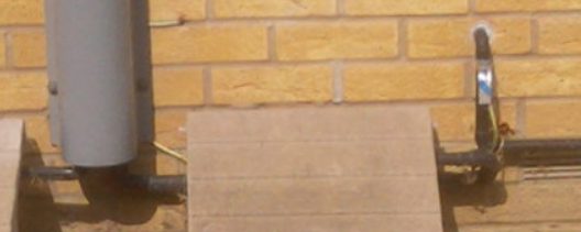

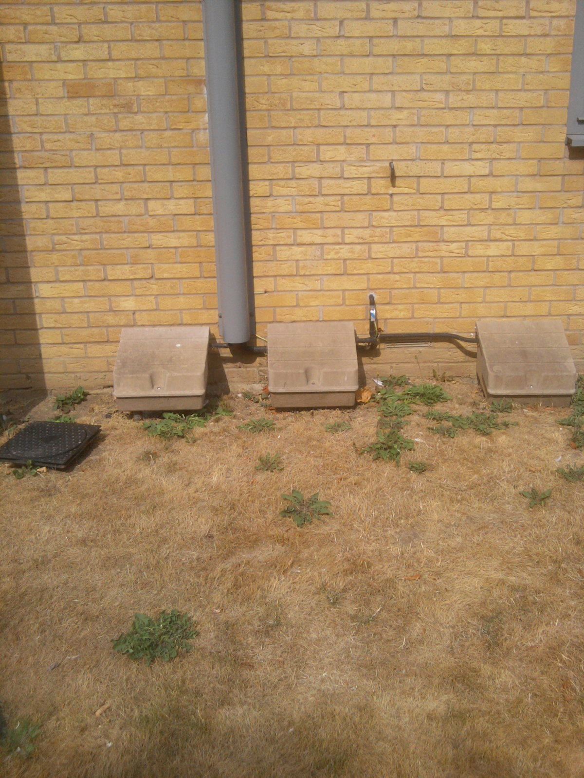

I've been back on this now and can confirm the gas pipe is bonded after the internal valve where it enters the flat.
Pic shows different meters to the sets I looked at before at another area of the development, it shows pipes are bonded together at the meters (some is inside capping) then they appear to be bonded to ground floor flat
Bonding the three gas pipes together at ground level is probably acceptable provided that the electricity supplies to three flats have the same Neutral.
If each gas pipe is bonded to the Main Earth Terminal in it's own flat and the flats do not have the same electrical supply Neutral then any connection between the gas pipes at the meters will be a connection between two different network supply Neutrals.
If the Neutrals are not at the same potential then significant currents will be flowing from one gas pipe to the others through the pipe to pipe bonding cables.

Where do the neutrals come into this?
All the earths are on a common bussbar.
The cable going through the wall could have been the easiest way to correctly bond the flat on the other side.
The cable going under the capping does not seem to be necessary.
The same for this one although it is not clear.

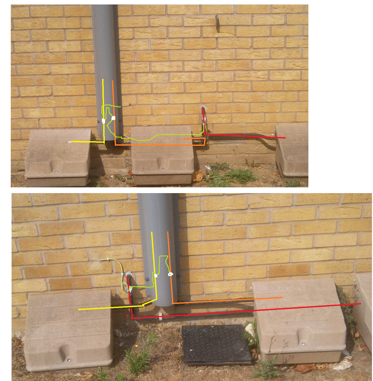

Under the capping are 2 more earth clips, all 3 pipes are bonded together in both of these sets of meters.
The block referred to in OP, at least one set of 3 are not bonded together and one set of 3 is, hence the thread.
EDIT: approximate arrangements
I would think someone has just not understood "bonding" and has thought everything must be "earthed" - or, at least, connected together with green and yellow cables.
