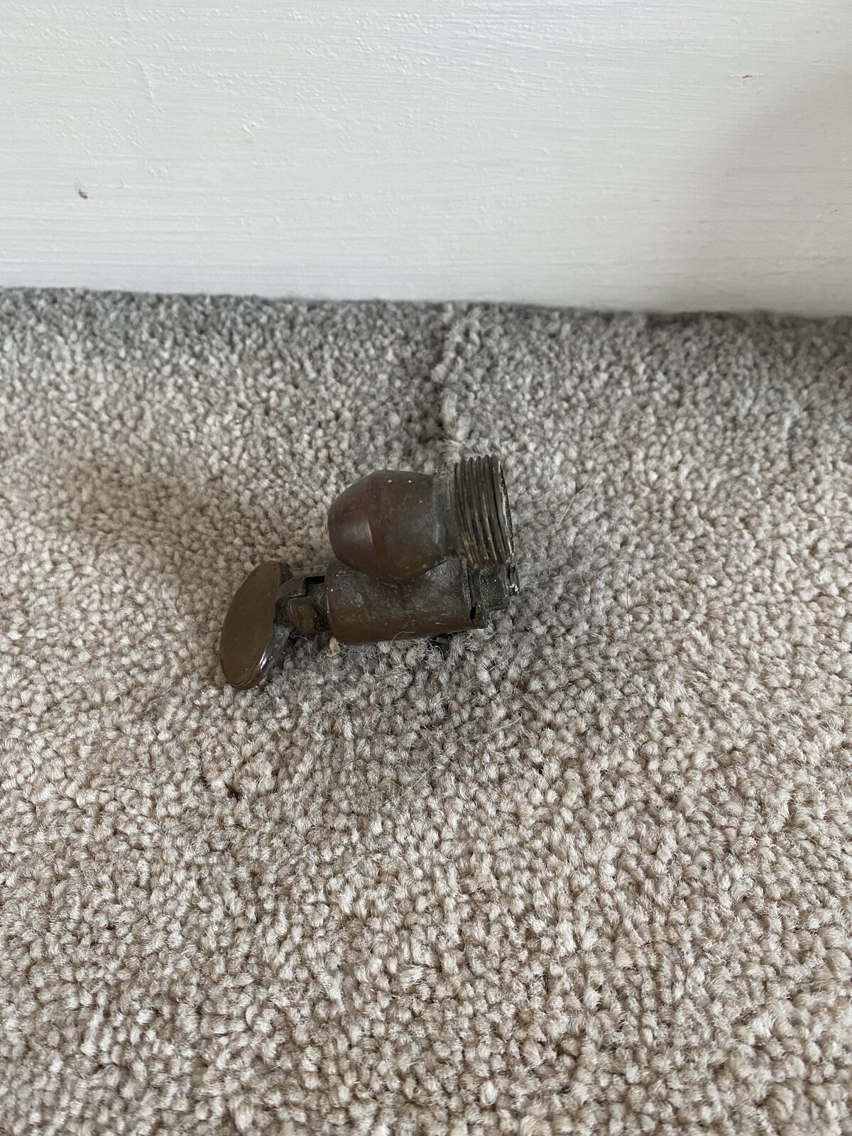

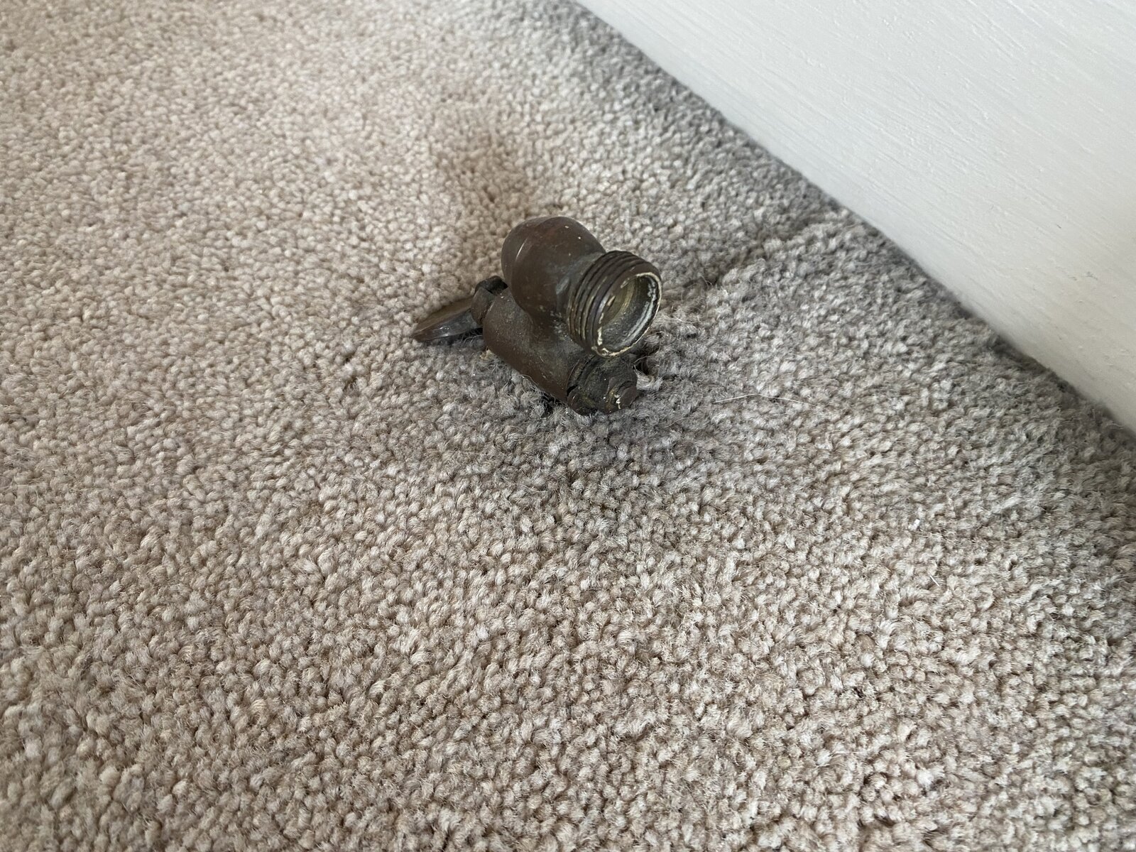

Hi All
I'm new to the forum having bought my first house a couple of months ago and am looking to get stuck into some DIY in the new year.
My first project is to redecorate a bedroom. There is what looks to be an old gas fitting poking out of the floor. It is next to a now blocked up fireplace so I presume it was something to do with a gas fire. Nothing happens when the flap/switch is turned so I presume it has been disconnected.
Would it be safe to cut this off below the carpet? It would look a lot neater.

Yeah, looks like an old isolation valve, but I haven’t seen them used for fires. I know you said it doesn’t do anything when operated, but better safe than sorry, I would get a gas safe registered engineer in, as you can’t leave an open end - dead or not.
Presumption is the mother of all disaster....

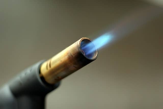

This is a modern day gas poker. Just lie that on the log bar and it soon gets the fire going.

Thanks guys.
If there is no way to tell whether it is still active/connected to the gas supply then looks like the only alternative is to get someone to come and cap it off.
Obviously it depends how much access you have around your house. I can get under my ground floor and can see where every gas pipe runs - the new ones to the boiler and tumble drier, the older one to the hob and the really old lead ones running to where the old gas fires were - these were cut off at the supply end years ago so I was safety able to remove the whole lot.
If you can't, I would strongly recommend that you get it traced by the gas engineer and (even if it costs a bit more) cut off as close to the incoming supply as possible, not just under the bedroom floor - the fewer live gas pipes running round your house the better.
As mentioned, if you can trace the pipe back to show it has been disconnected then just remove everything. If not then get someone in, don't cap it yourself, you never know what's been done previously.
