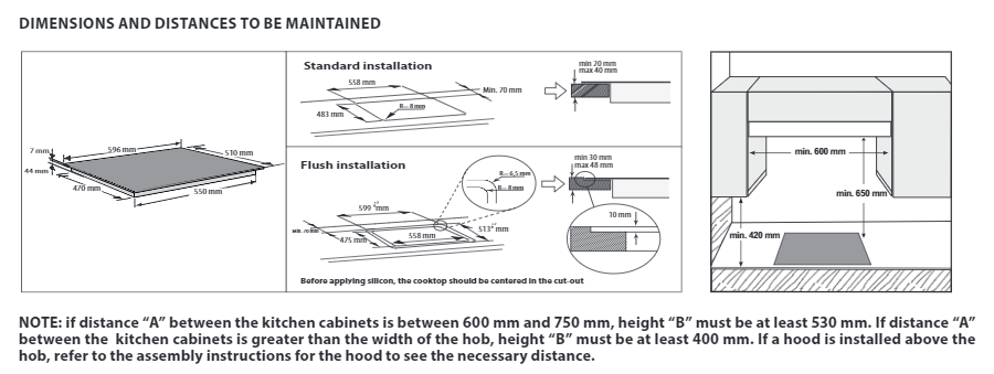

Hi, i'm fitting my kitchen at the minute and i have instructions for the gas hob which seem contradictiory. The plan is to have an extractor fan unit 600mm wide directly above the hob, with wall units either side.
The hob instructions have a diagram showing a min distance of 420mm between worktop and the bottom of wall cabinent either side is the distance between wall units is 600mm wide.
However it also says
"NOTE: if distance “A” between the kitchen cabinets is between 600 mm and 750 mm, height “B” must be at least 530 mm. If distance “A” between the kitchen cabinets is greater than the width of the hob, height “B” must be at least 400 mm. If a hood is installed above the hob, refer to the assembly instructions for the hood to see the necessary distance.
Am i missing something, the hob is 596mm wide, so if distance A is 600mm or greater then it satisfies both conditions right?

Do you have anything in the instructions that shows the A and B measurements? What make/model of hob? You could confirm with the manufacturer?
Hi, A and B are not marked up. I assumed that A is distance between the wall units to either side above the hob (marked as min 600 on the sketch attached), and that B is distance between the worktop (or hob) and bottom of units.
Its a Hotpoint HGS 62S/BK hob.
Not the clearest instructions. Might be worth contacting Hotpoint then? I would personally just use the min guidance, but not sure of this A and B business, sorry I can’t be more helpful.

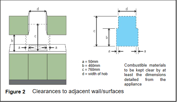

If it's any help, I have a Hotpoint hob (PAN 642) with the wall units 800mm (A) apart. Their bases are 460mm (B) above the worktop. The units don't get very warm when the hob is in use.
From your instructions it seems if A were 600mm (i.e the unit side-wall vertically above the hob edge) then B should be at least 530mm. That seems reasonable to prevent heat damage to the unit.

What i dont understand though is say A was 700mm, it would be wider than the hob but would satisy the criteria for both 400mm and 530mm (i.e. A is between 600mm and 750mm , but its also wider than the hob).
To complicate further, the image shows a minimum of 420.
Think an email to Hotpoint tech support would clear this up. I agree the installation instructions are incomplete on this
I think the hood distance is influenced by whether there is a gap between the hood and wall cabinets i.e. some heat can escape around the sides of the hood.
