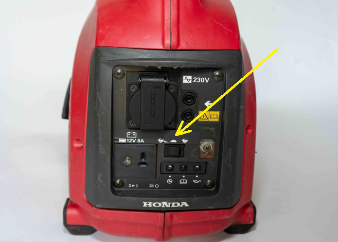

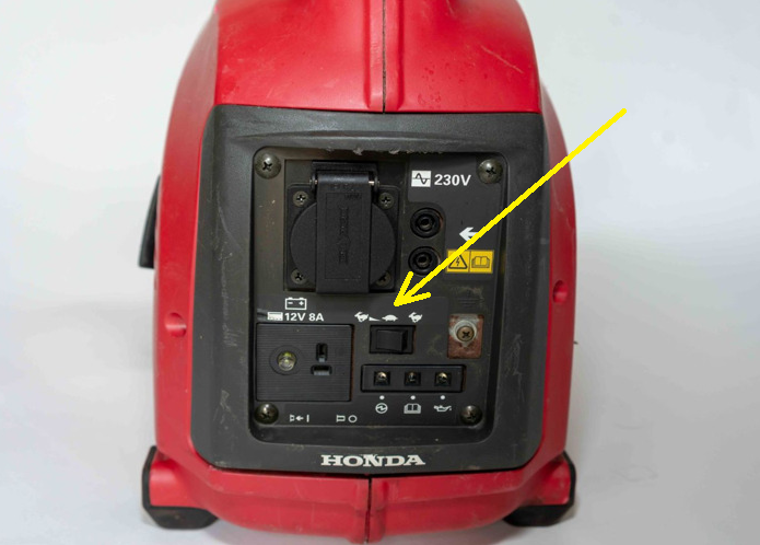

Some Honda generators have a switch with a hare and a tortoise on them. When the switch is to the tortoise, it idles slowly and then increases RPM as the load comes on. With it switched to "hare", it runs at constant speed. The latter uses more fuel, but is handy if you have a big electrical load, which would probably stall the engine if you switched it on and it was only idling. Does yours have such a switch?
No if not wrong but I can`t see anything like that. There only a lever moving from 50Hz to 60Hz
Ah, OK, must be a different design. It would be pretty obvious if it had one - they're on the control panel:
