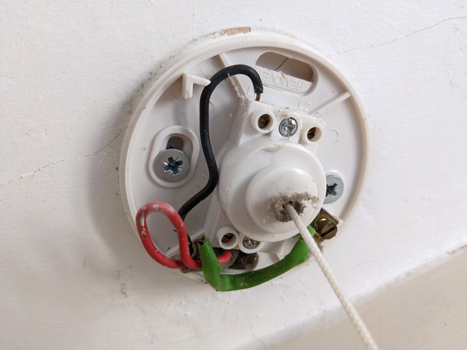

Ok, the only problem is I'm not exactly sure if this would work with my current wiring, pics attached.
So the pull cord activates both the lights and the extractor fan, once the lights are off, the fan still runs for a minute or so, so probably on a timer.
Those are the only wires I can see on the pull cord, so just wanted to check if it's a simple swap for one of those receivers and then mount the kinetic switch anywhere on the wall, or is the installation of the receiver not quite straightforward, as some say neutral required, some say neutral not required.
I have replaced other light switches inside my house, but they were just a straight swap.
So black wire is connected to L1 and red wire to COM L, earth is earth.

Just guessing as I have never seen one but would think you would need a live & neutral supply to the switch part which you do not have at the current switch (just a switched live). You may be able to bring one from the light or the fan.
Those receivers require L,N,SL and are intended to be installed at the light, where all of the required connections will be.
Hmm, means I'm stuck with this pull cord?
Can't even use the switch with integrated receiver that says neutral not required, as in having that switch mounted on the ceiling?
That might work, or perhaps not.
Devices like that which don't require a neutral obtain their power by allowing a small current to flow when the switch is off.
That is fine with an old incandescent lamp, but anything used today such as LEDs are very likely to flicker, flash or work in other undesirable ways. As you have a fan involved there, it's anyone's guess as to what will happen with that.
