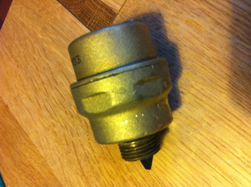

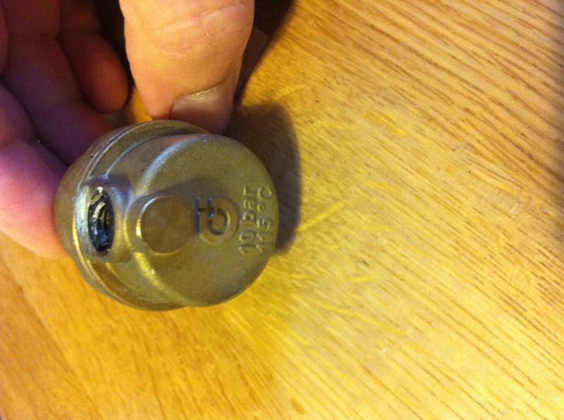

Andygasman2010, we have 3 double rads and 2 single rads, The part he took of is below (i would hope he put the same part back on!), vessel presure was checked by him when the system had no pressure in it but not sure if the system was open, is there an easy way to clean the braided hose?

Thats an auto air vent.
