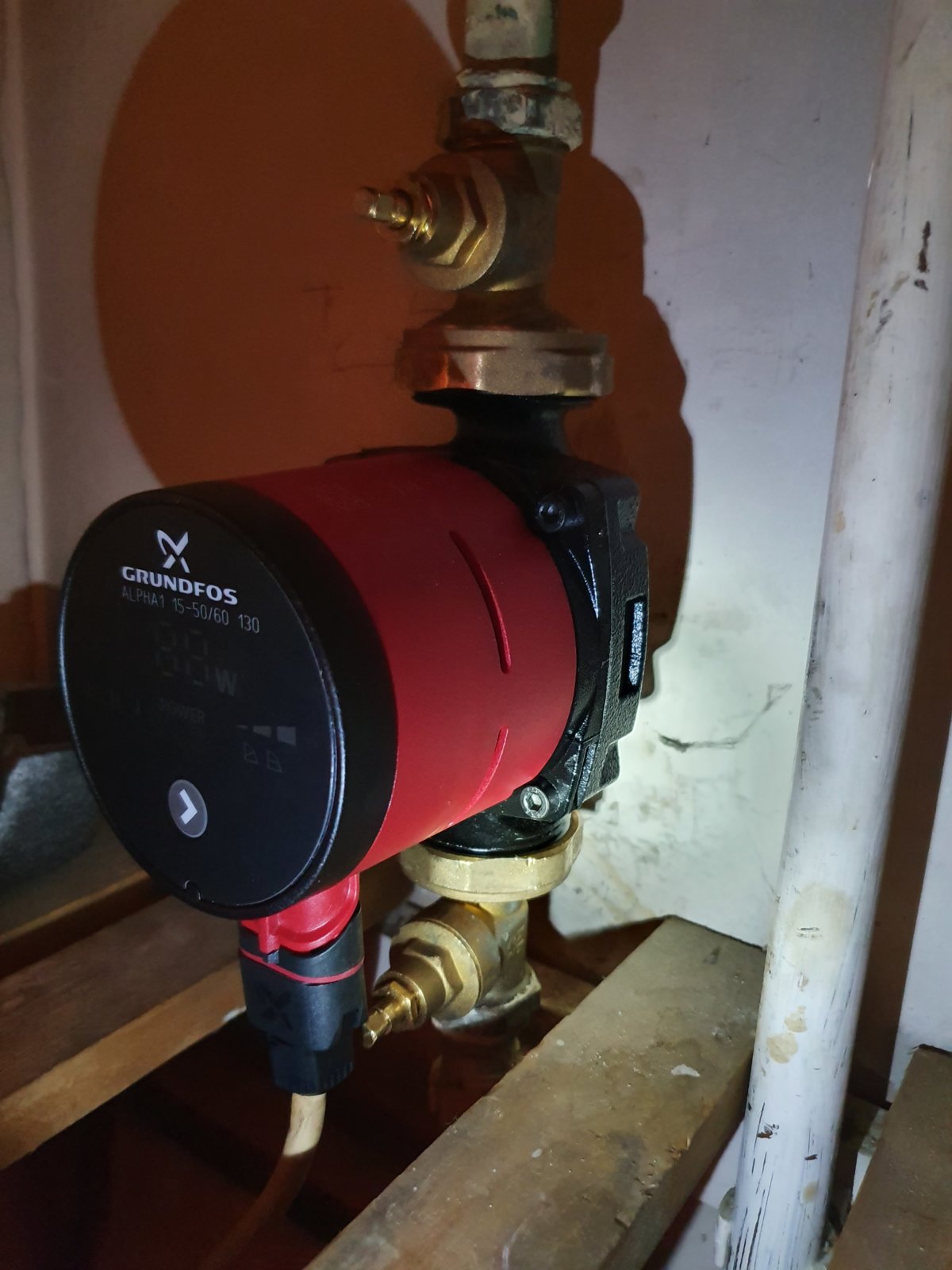

A photo of pump position and arrow indicator might be best?
Please see pics arrow pointing down

Thanks, so it appears it could be the correct orientation. However those pump iso valves don’t look fully open, which would cause frictional resistance noise.
Hi cheers for the speedy response they are fully open now both sides where only a half turn off full open ...when the pump is on 3 though theres still a humming noise all rads heating up quickly though this morning

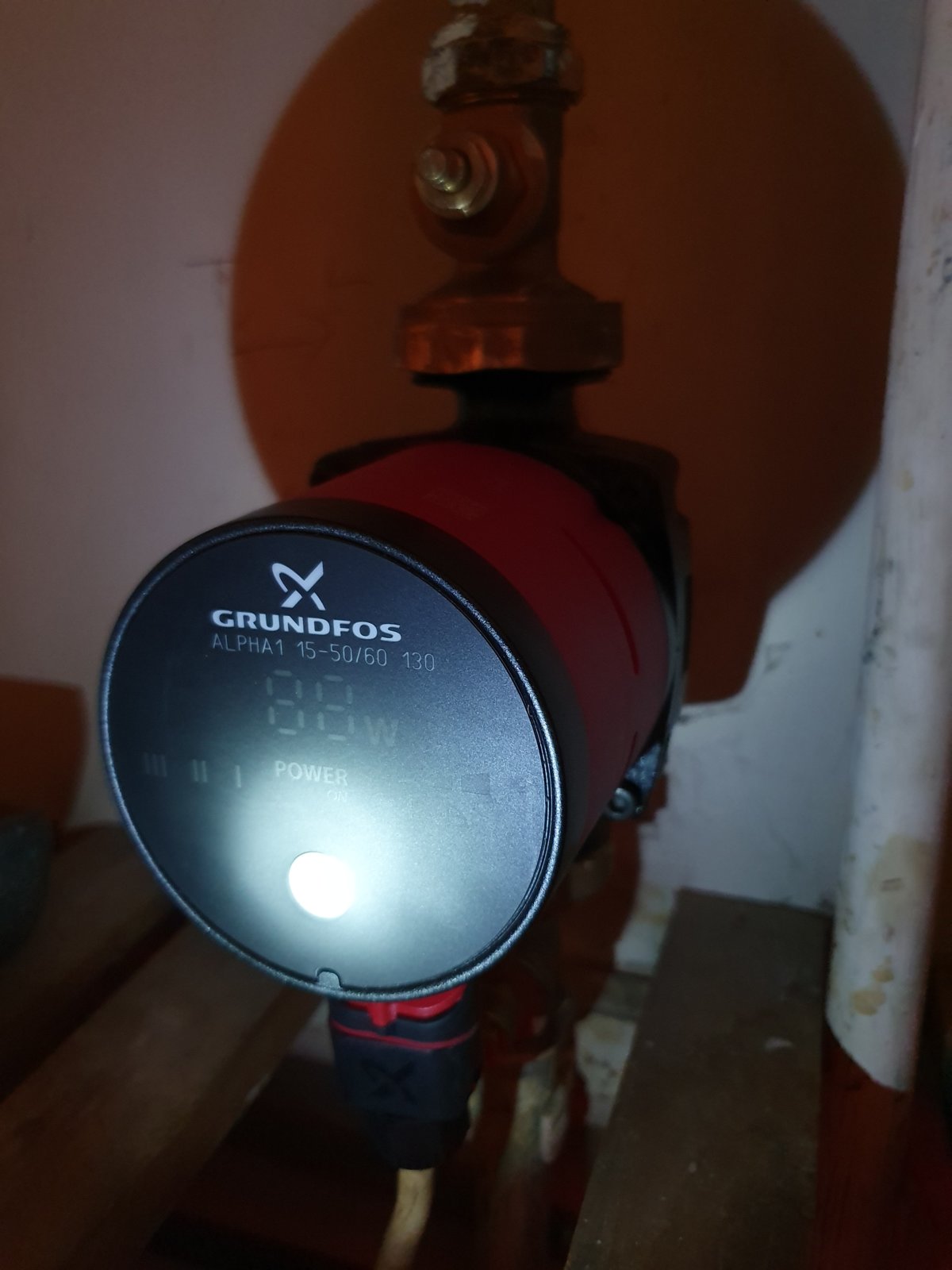

Oh and the pumps only pushing 26w on full which on info says 34w

It heats the system on 3 but really hums definitely not a whisper operation ...

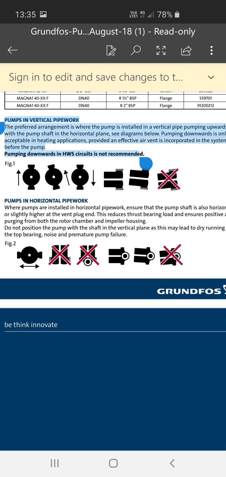

Just read this on their website saying the flow arrow should be pointing upwards ...cant understand that the original grundfos was pointing down so i turned the new one to match

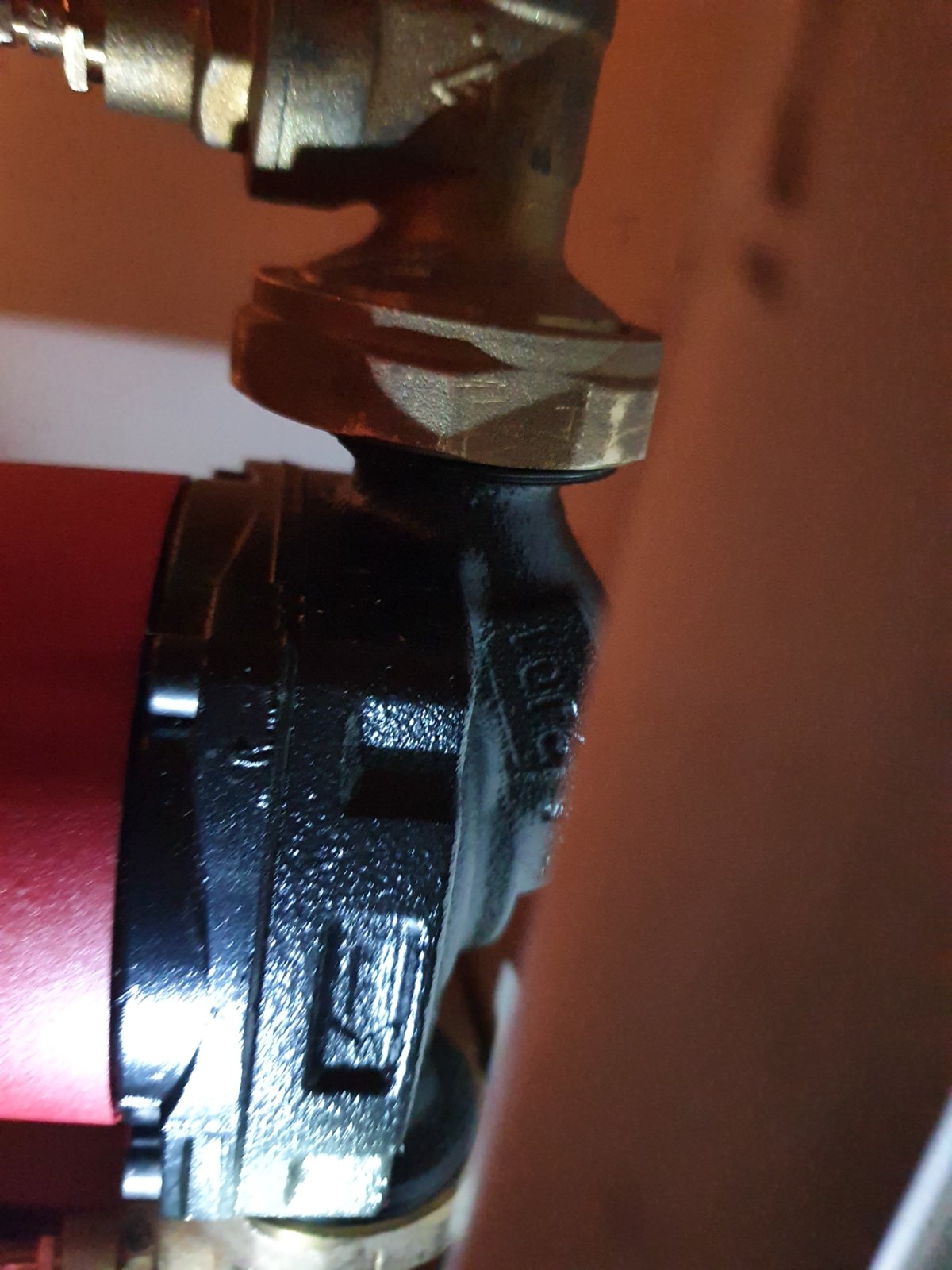

.i fitted it myself after turning the head so that the flow arrow matched my existing pump
Turning the head does not alter the flow direction in any way, the pump body denotes the flow direction, your pump is upside down

So are you saying the flow should be pointing up not down
I did a straight swop when i put the new one in making sure the flow arrow faced the same way as the original sempt to work quietly for a few days but now its humming load ...all rads heat up and are balanced
So when it came in the box it was pointing upwards
I took out the 4 bolts on the face and turned it so it matched the one that was on then rebolted the face .... so the flow arrow is going down ...totaly confused now ...everybody told me the flow arrow had to go the same way

No flow should be pumping down
