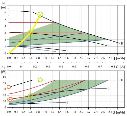

I had an additional rad fitted about 8-9 months ago the pump ran at 45W (way too noisy) when on III and 19W (Quiet) when on II. Just recently British Gas came out to fix a leak on on a bleed valve near the boiler. I've since noticed that the pump sounds a little noisier than before and is running at a lesser power draw.. ie 33W on III (still too noisy) and at 13W on II which is noisier than before but bearable. All rads heat up but it feels a little slow
Those power ratings suggest that there is no circulation. The BG engineer has turned a valve off and forgotten to turn it on again. Get them back.

I thought the same thing. When you say speed 3, I am assuming you mean the one marked III - the outer of the three fixed speeds - and not one of the two constant or two proportional speeds.
Here are the charts for the pump showing (top) the head v flow rate, and (bottom) Watts v flow rate.. Your original data are circled in green and the new in red. The yellow curve on the top chart is an estimate of the "system curve" for you installation. It shows how the pressure drop round the system varies with flow rate. The working point is always at the intersection of the system curve and the selected pump curve. As you can see the power on speed III only drops to 33W when the pump is dead heading, i.e no flow; similar for speed II.
Hey thanks for that detailed info, yes it defo looks as though the current flow is weirdly on the zero..:unsure: so strange.. I've turned it off for now and will see what BG say first thing in the morning. They came out pretty quick last time....

Hurrah so its resolved!
BG came and the engineer removed the pump... turns out the impeller was sludged up with a coating of crud. She cleaned it off reinstalled and it now runs sweet and like a dream... Full speed on all settings without any of the noise that I had before.
