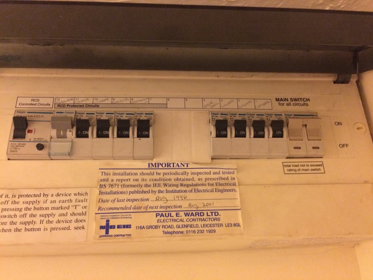

Hi,
I have a Hager consumer unit and need to replace a Hager 32A MCB (link below) with a 45A MCB. This is required by my Mira (Shower Manufacturer) in order for them to come out and repair a faulty shower. The Hager MCB's only seem to be available in 40 or 50A.
http://www.hager.co.uk/product-cata...-6ka-type-b/mtn132/42123.htm?utm_source=print
Does anyone know if other manufactures 45A MCB's will fit, or whether there would be any issue with fitting a 50A Hager MCB. The shower manual is fairly specific that a 45A rated MCB is required.

In theorety you should not do that, even if it will 'fit'
... or whether there would be any issue with fitting a 50A Hager MCB. The shower manual is fairly specific that a 45A rated MCB is required.
Electrically speaking (and in terms of the Wiring Regulations), there would be no issue provided that the cable, as installed, was meaty enough to be adequately protected by a 50A MCB (that would have to be checked). However, Mira can make up any rules they want!
Kind Regards, John
Assuming you have a 'split board' with two RCDs, your choices are 40 or 50A
If you only have one RCD and some circuits just protected by MCBs, Hager make a 45A RCBO
ADN145 is the part number
Here's a picture of the consumer unit, its the grey MCB on the left that needs replacing. I think this is the one that is only available in 40 or 50A?
The cable is 10mm2, with this in mind will a 50A MCB be ok?

Correct. However it could be moved over to the right hand side of the board (where there is no RCD and then the RCBO would do the job of the RCD and MCB. About £22. £20 more than an MCB but it depends how finicity Mira are being.
What size cable is it? If it's 6mm² you can't use a 50A anyway so that's out. A 45A is fine on 6mm² dependant on installation method of the cable
Yeah that should be fine on a 50A, if it's definitely 10mm², begs the question why it was put on a 32A in the first place!
You could use a 50A with 6mm² as long as the shower is rated less than the cable. It can't cause an overload.

You could, theoretically, but it stands a significant risk of causing hassle/argument if, say, there was a subsequent EICR, since I am fairly sure that many do not think beyond "Iz≥In≥Ib".
Furthermore, invoking the 'exception' to which you refer still requires that adequate fault protection be present, and that has the potential to be a problem with 6mm² cable, at least with a TN-S installation. The 'maximum Zs" for a B50 is 0.87Ω, and 6mm² cable has an R1+R2 of 12.65 mΩ/metre. That means that in the 'worse case of TN-S (Ze = 0.8Ω), one could not have more than about 5.5 metres of 6mm² cable - and I don't personally think that one should (in a TN installation) rely on an RCD as the primary provider of fault protection.
