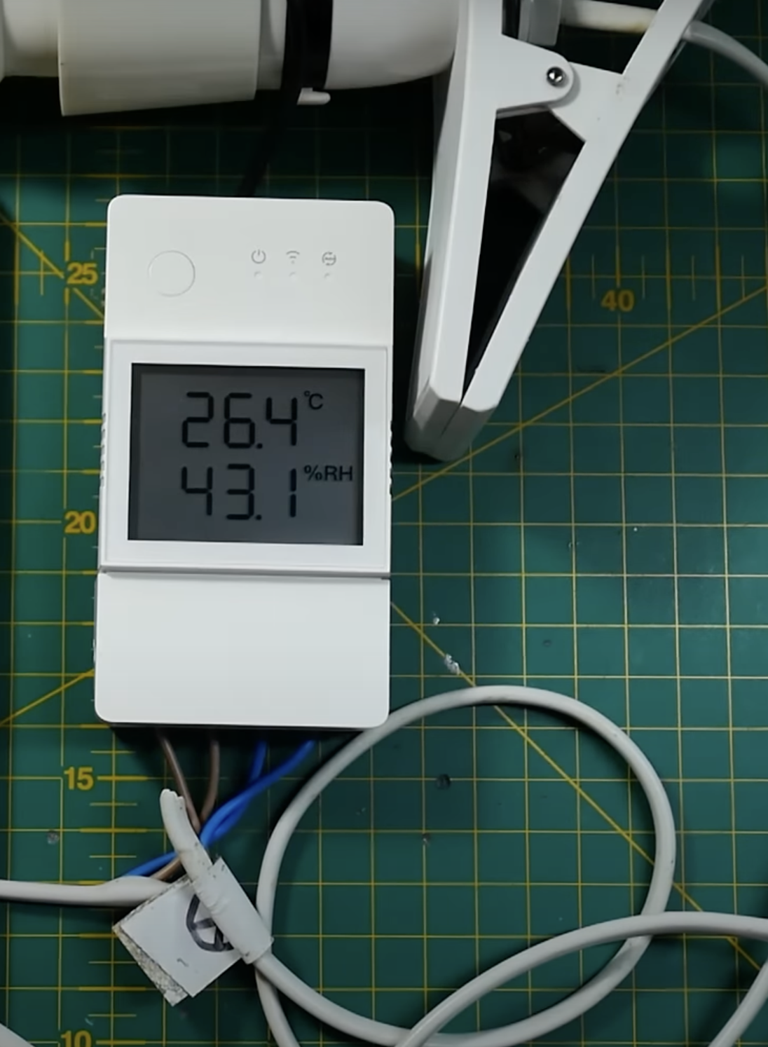

Hi folks,
Have an electrician coming round soon to do the second fix of my outbuilding but need to put up the plywood walls and hence do the socket cutouts etc before he comes. One of the cables running from the small CU feeds an extractor fan, which I want to control through a humidity sensor like the Sonoff THR320D. From what I can find on the net, it runs 'in-line' with the T&E cable (one end in from the CU and another out to the fan) which means I would have to cut 2 small holes for entry and exit of the cable through the ply? Unless anyone has any better ideas?
Secondly, as per an example internet pic below, it seems the switch just has the actual individual cores running into it individually, which looks a bit raw? Is this right, as the rest of the switch is designed to be on display but the wiring part looks like it's meant to be hidden inside a box or behind a wall?
Appreciate any advice or if anyone's got something similar?
Those particular Sonoffs have a DIN rail mounting and are designed to be mounted in a separate enclosure.
Can you post an example of the kind of enclosure it goes in? I would have thought it defeats the point of a display if its not on display. And the physical switch is useful to use a physical switch if need be.
I'm looking at trying to have it surface mounted on display rather than in a box.

But, without the enclosure, the device won't have double insulation, or cable retention.
You might be able to find a way of mounting it beneath one of your ply sheets, or it should fit in a 2 gang back box.

The pics do look iffy right? It’s the live and neutral cores on display without flex insulation. Can’t believe it would have been difficult to design it so the flex comes out a pair of glands at the bottom. Or even to exit at the back so it becomes like a big standard socket.
We ONLY fit them inside an enclosure requiring a tool to open due to the lack of double insulation.

I've got a couple of the cheapo relay units. They don't like continuous heavy load (2kw fan heater), fine at 1kw though. The wiring method is a pain- not only the visible cores also nowhere to connect or terminate earth so enclosure is required- nuisance cos you then can't get at the manual override.
