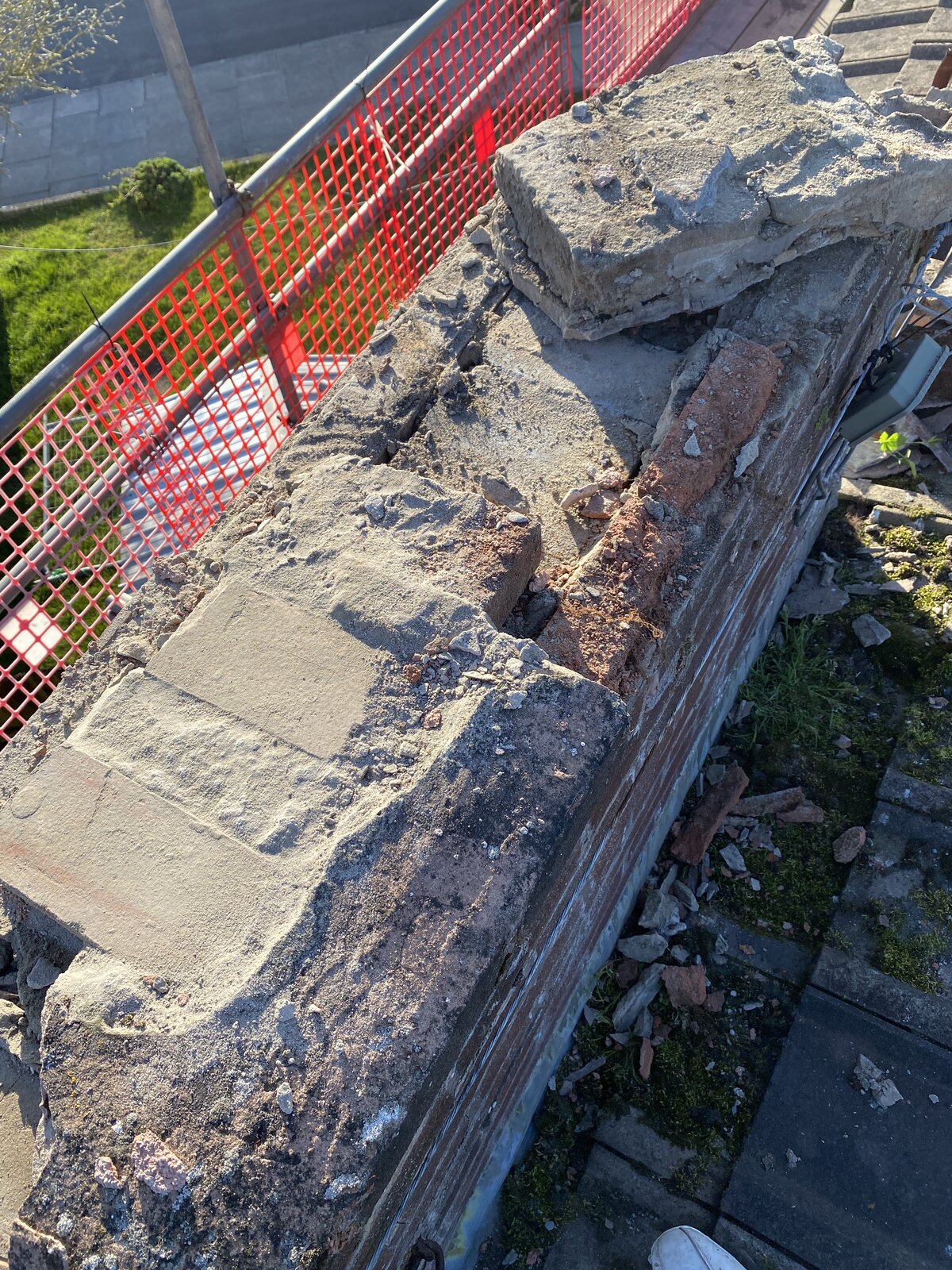

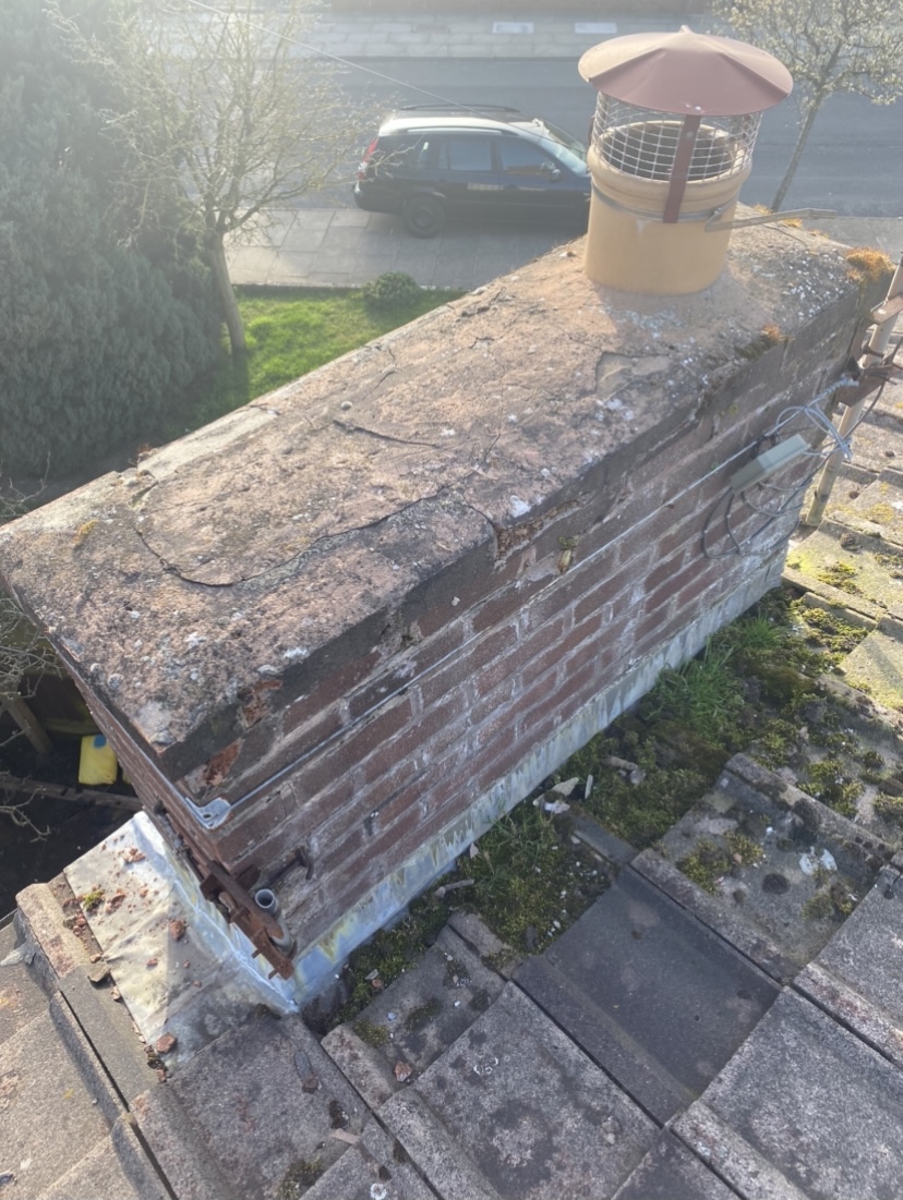

Hi All,
My chimney is in a bad way.

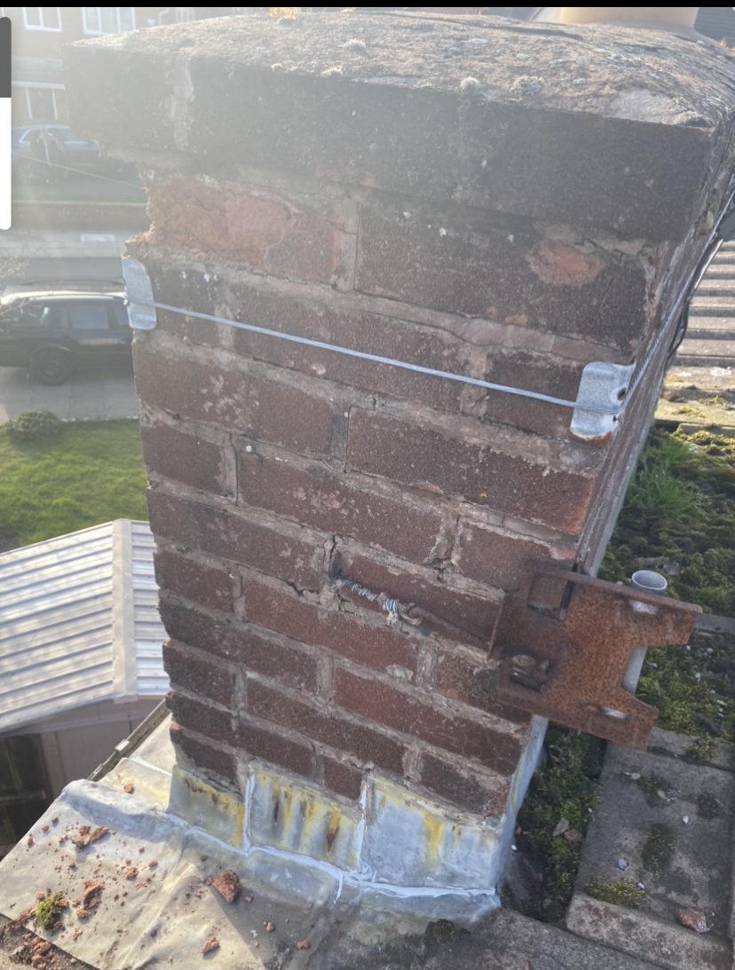

I'm just about to do the roof on this side of the house, which will included replacing all the lead...but before that I want to sort the chimney out. The house will be getting rendered including the chimney, but I think I need to remove/replace the blown bricks and the haunching.
I was going to remove the entire top layer of brick and replace with blue engineering bricks and 4:1 mix - sorry if this is a stupid question, but do the bricks go all the way across under the haunching? If not, how else is the central part of the haunching supported in place?
Repoint the rest of bricks with 5:1 mix.
Regarding the haunching, I see that 3:1 mix is recommended. Could I add some tone to that to make it grey?
Finally so you think the chimney pot will be salvageable once I start removing the existing haunching, or should I just order a new one and be prepared to replace?

Rendering chimneys should be avoided as they can become a regular problem when the render starts to detatch very soon and paint peels. If you are dead set in rendering, use a sulphate resisting cement and replace any blown bricks, and consider a render that is low maintenance and does not need painting - even if different to the rest of the house. If bricks are loose, render will crack and pointing won't hold them together
Two course of blues should be laid to avoid frost problems - with a good oversail from the render face, not just the brick face
Sharp sand in the flaunching along with building sand is just as important as cement - 2:1:1. Why would you want to dye it grey? Flaunching dries grey and the pigeons wont mind,

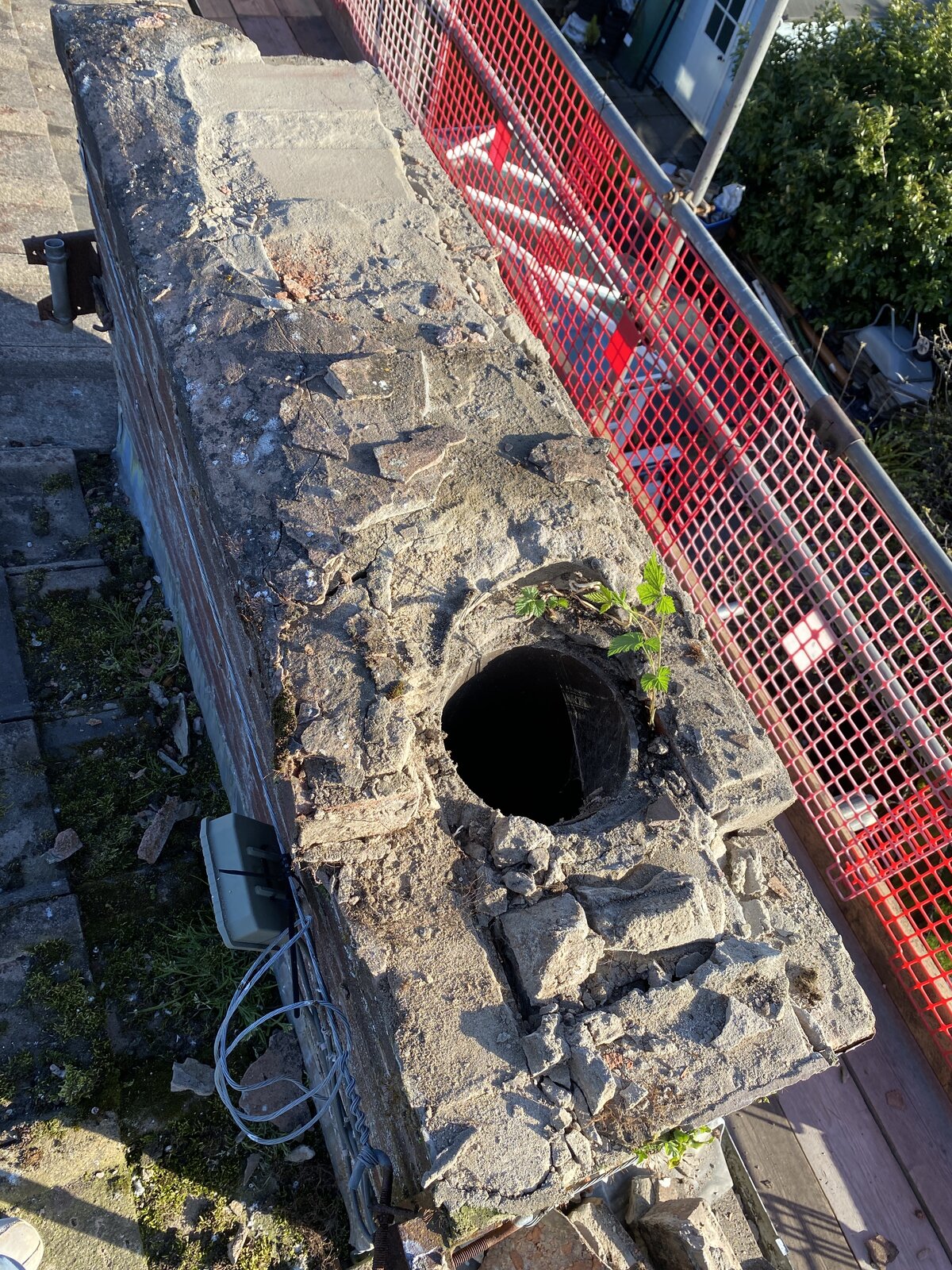

That looks like a 3-flue stack so there will be bricks (whiffs) across the stack between the flues. The pot should be reusable if its in good condition now.

Bit of yanking by hand has led to this...definitely worth sorting before it fell down.
Fair play to Mother Nature and a blackberry plant growing inside the chimney pot
Thanks guys, but I do have a gas fire in the living room with a flue that is connected to the one chimney pot, so I think I need to re-build as was.
I'm only going to rebuild the top part Woody.

All I can do is replace the removed bricks, repoint the whole chimney and cross my fingers regarding the render. I'm getting the pros to do the render with the meshes undercoat and silicone top coat.
I've got custom lead back gutter and front apron coming from leadworx for the current size, which should help with ensuring it stays water tight.
Now I understand the issued, it a different situation I would tackle as advised, but I don't think I've got the time to do it as suggested.
The only positive I guess that I do have is that the chimney is completely separate from the rest of the house walls due to the fascias/soffits so there will be a break in the render from the rest of the house. If it does start to fall off at some point in the future, then I could take more drastic action with the chimney when time allows.
