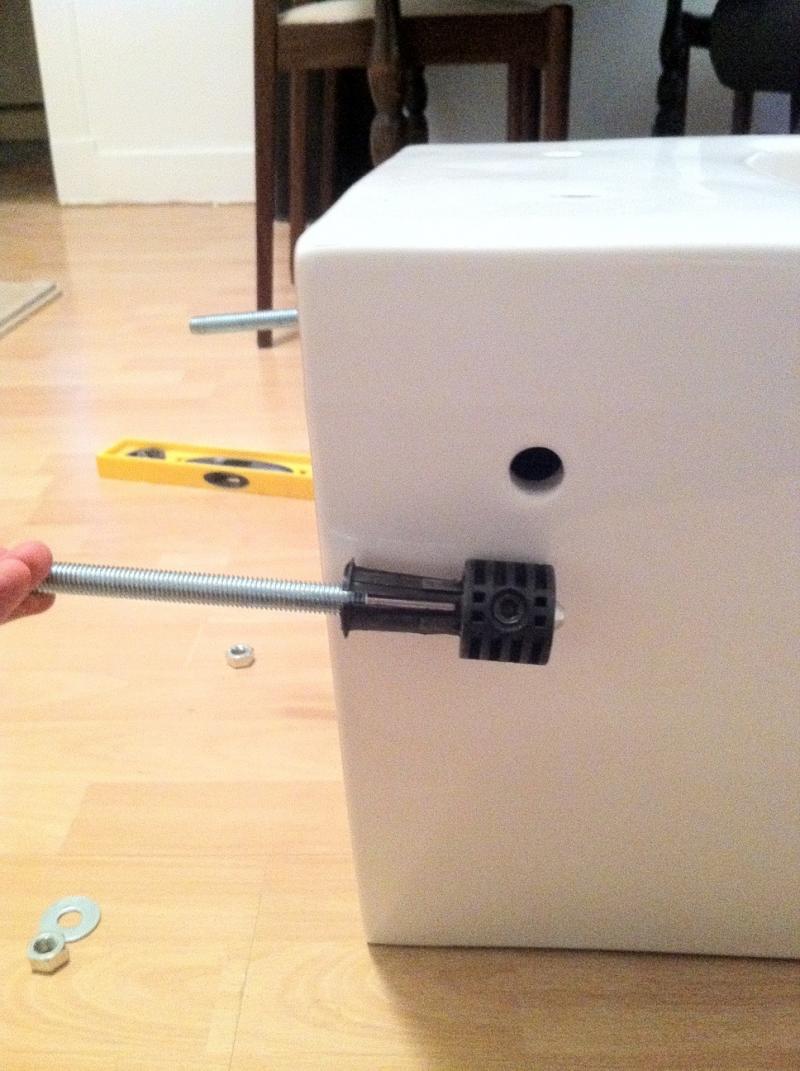

Hi all,
Spent today attempting to install my new wall mounted toilet. Bought a Grohe rapid SL which I manged to connect without too much grief despite instructions being bloody awful! The toilet is from Bathaholic.co.uk which is compatible with the cistern
The main problem i'm having now which has haulted all progress is with actually connecting the pan to the cistern - The connectors/bolts that connect to that back of the toilet are really loose and just dont seem correct.
I have been given no paperwork for this part of the installation and really could do with some help from you guys. Ive taken photos which I hope will clarify my situation.

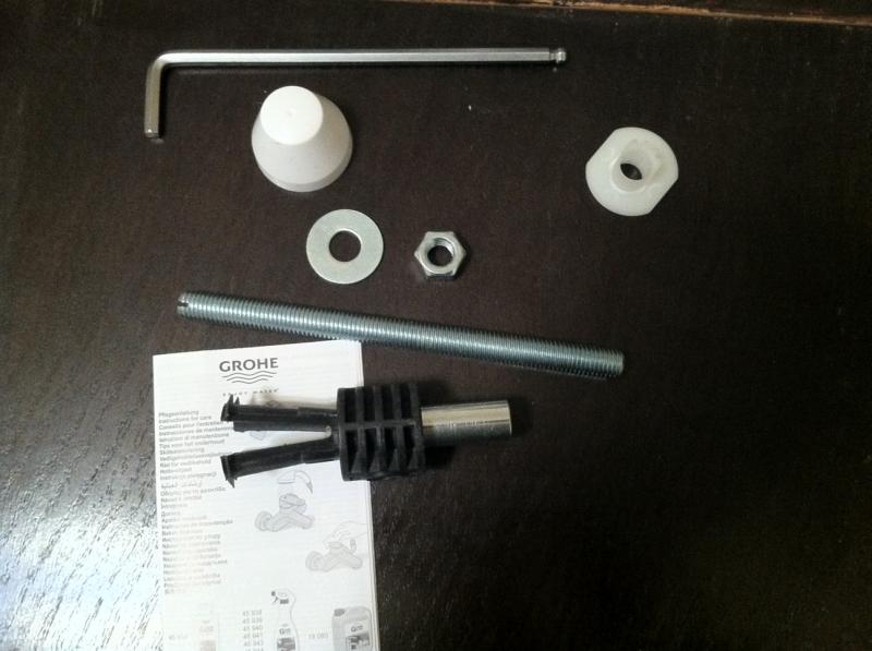

I dont know if im missing the obvious but I cant suss this one out. The connector seems to consist of a long threaded rod which screws into the cistern which joins onto a kind of connector which I assume goes through the holes in the back of the pan. Once the black rubber but goes in it doesnt come back out however there is a lot of give and its far from secure. Have a look at the pics and if possible let me know where Im going wrong
Cheers

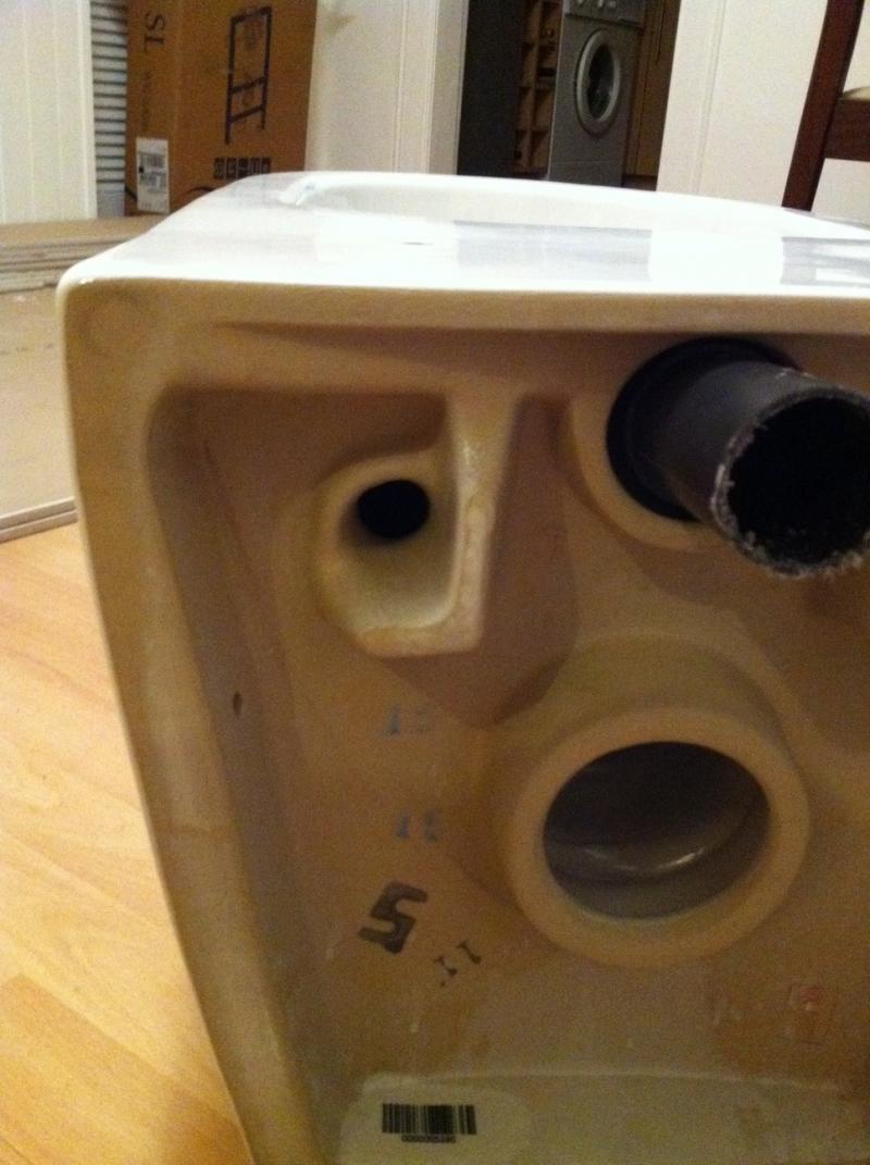

did you chew that flushpipe off? every heard of a half round file

The flushpipe is still to be filed and tapered at 45 degrees.
The whole issue Im having really is what the hell are these black plug things and how do they work? And your answer is they have nothing to do with the hanging of the pan which makes sense but also makes me think what the are they for then?

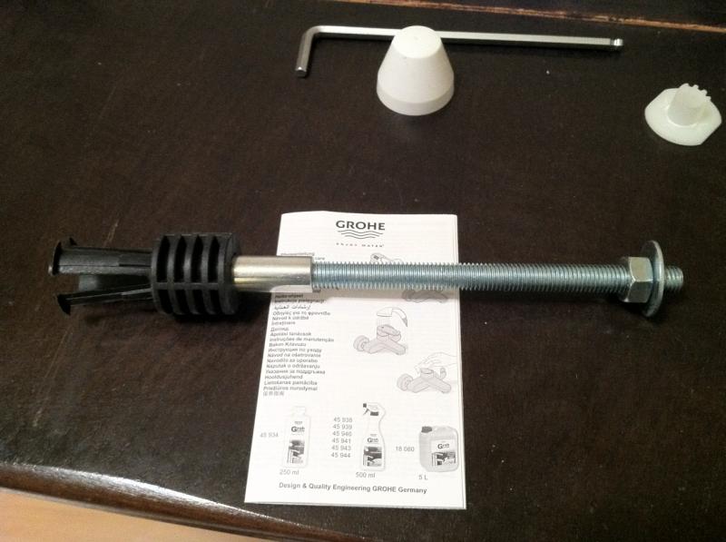

Denso13, the pdf you posted is the same as the instructions that came with the cistern - I have all the parts plus these 2 additional black rubber connectors as pictured. I have tried to connect with and without the black connectors and both occasions failed miserably. I honestly feel like a part is missing or something...

If yes, perhaps the black plastic fittings are meant to be 180deg about.
From what I see that would in my mind be a safer method to hold the pan, but would need access pan side.

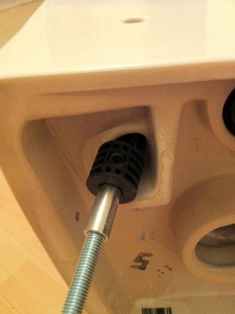

The only access I have to the bolts is from the underside of the pan. As the pan is only raised 5cm off the floor once its in position I have no access.

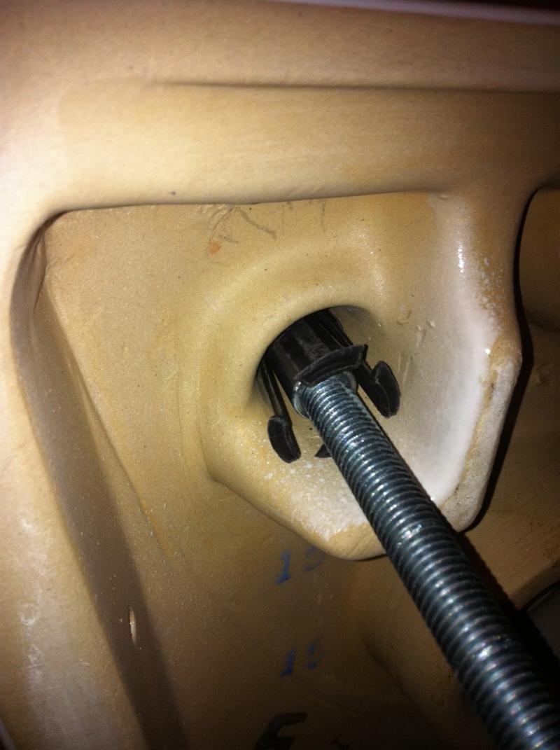

There are holes either side of the pan where an alan key can be used to loosen the screw on the rubber 'rocket' connector

I would suspect that the 'Rocket fitting' would be fitted with the three fingers acting to hold the thing in the hole from inside the pan this would them mean that access via the panel mount would be required to tighten the bolt, thus pulling the whole lot into compression.

There is access via holes for the alan key to tighten the screw
Despite this im still having issues. Firstly, I suspect the black 'rocket' connector was back to front in my original post. I still think the hole at the back of the toilet is simply to big for the connector. When I screw the thread into the rocket bolt it still moves about 10 degrees in each direction...?
More pics added - appreicate all comments so far
