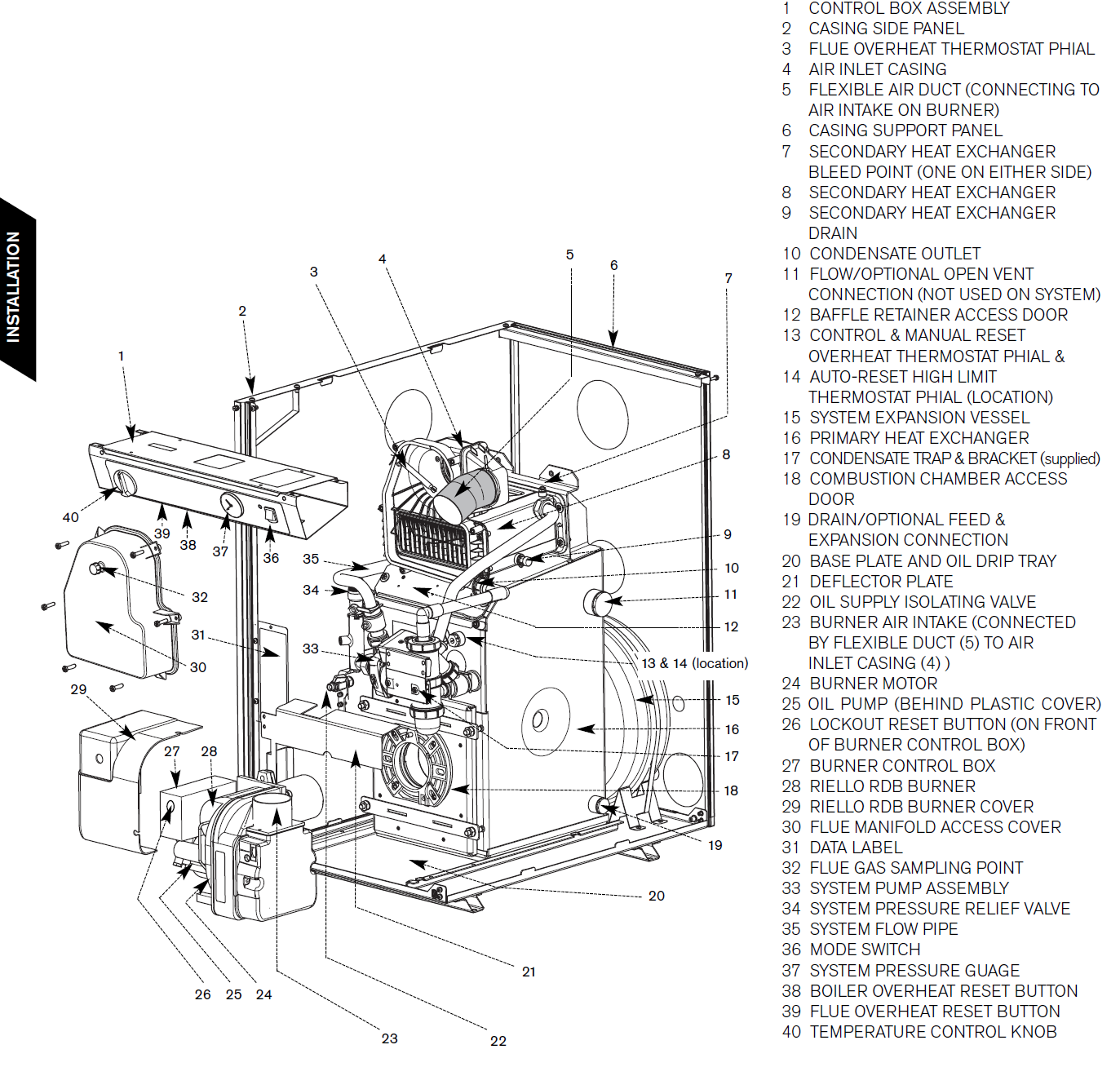

I have an ongoing problem with the above boiler. When set to work from demand via the timer or when manually switching it on the boiler will not run for any length of time unless the boiler control thermostat on the boiler is turned to max. The lower the control is set the short time it will run then stop. If I turn the control up to max it will run again for a short time then stop, I assume this is the boiler control thermostat shutting the boiler off as if left to cool for a while it will again fire up and run. The boiler itself and the radiators will heat up fully.
Also, about half the times it is supposed to fire up via the timer or the one-hour boost the boiler won’t fire up. It sort of locks out but the lockout light on the burner reset button is not eliminated however pressing the burner reset will start the boiler if the boiler the boiler control thermostat is set high enough.
We had it serviced in August and after testing it was not used again until about three weeks ago. The tank is full of oil, new filled in Sep. I have spoken with the oil company and they say they have no reported problem with that batch of oil.
We had the usual service engineer who services the boiler out to look and after spending some time with it basically giving it another service, fitting another nozzle even though the one fitted in the service hadn’t been used, and fitting a new photocell the problem remains and his conclusion is because of various parts being obsolete due to age, it was installed in 2008 he thinks we need a new boiler. Frankly, I’m not buying that and sent him away.

I'm not familiar with oil boilers, but if a gas boiler behaved in a similar way I'd suspect some impediment to circulation causing the boiler to cut out as the return temperature was too high. I other words, the heating / hot water (boiler primary) circuit wasn't able to get rid of the heat fast enough. 1. I'd be looking for:

If the burner lockout light is not illuminated then its not combustion failure (except the light is "blown") and pressing the reset shouldn't do anything. If the boiler is cutting out on the overtemp stat then it doesn't self reset but another button, (normally under a a plastic cap) has to be pressed but there will be no combustion failure light.
How is the air intake arranged on that boiler, is it taken directly from inside its enclosure or piped in from outside, was any flue gas analysis carried out?.

Which burner is fitted? Picture would be useful
If its like this then check the flexible hose between the air intake and the burner, check outside for any obstruction, temporarily remove the hose from the burner intake, leave the enclosure door open and fire up the boiler.
It also shows (3) a flue overheat stat, possibly this?.

there are two reset buttons under two thermostats, one for flu manual reset and the other for boiler manual reset.
the third thermostat doesn't seem to have a button to press just a plastic cap. son there is a button under that cap? it is on the high-limit thermostat.
it is just like that, so i guess the air intake is via the case. All the hoses look in good condition, clean and not blocked.
If it was an overheating problem would not the boiler overheat reset button (38) need to be reset?
I've never had to touch this button.
The only button I've had to press is the lockout reset button (26) when it has failed to fire up on demand from timer and it hasn't been lit up.
