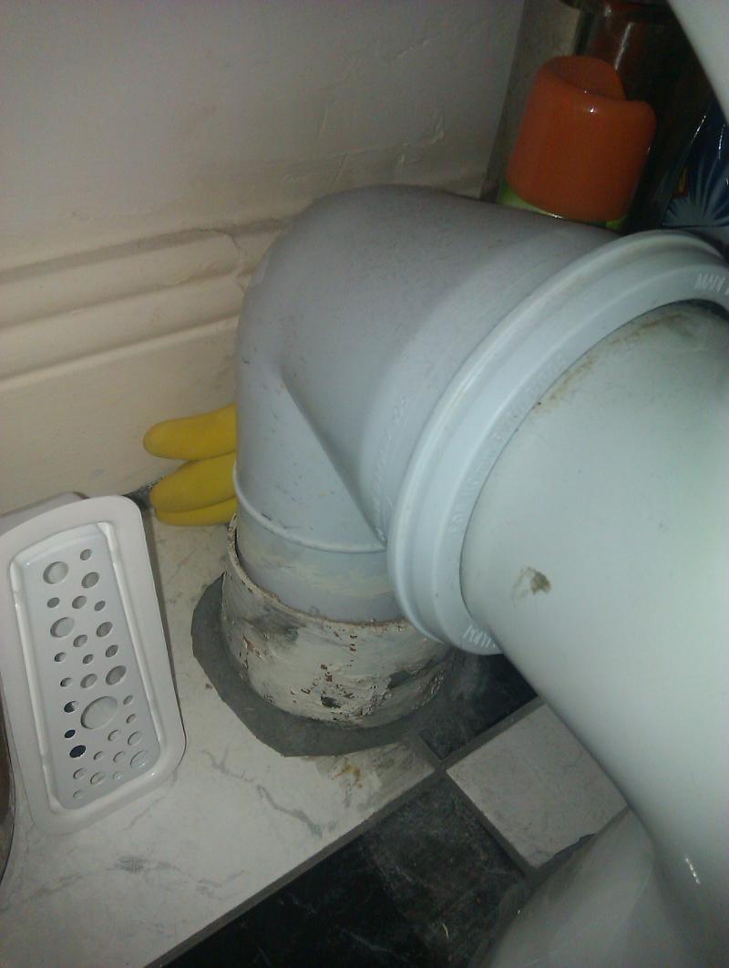

Also I had met with a builder who said that he could use the same waste pipe as in the current toilet and attach another pipe to extend out to new toilet under the stairs - does that sound right ??
I think I now need to get interior design advice next on where to best place furniture ect !! ...
No. What is the pipework arangement to the toilet? Is there a soil stack in there? Floor to ceiling? To a toilet above? Is the downstairs floor wooden? Mind, if its modern, even if its wood, it'll probably just have polystyrene underneath so it means nowt. Is there a cavity under the floor?
If the pipe goes up to another toilet, chances are you wont be able to carry it across to under the stairs, because it has to negotiate the landing, which sometimes have complex joist arrangements, and there isnt much space between a floor and ceiling for the soil pipe to fall sufficiently. Then theres the joist direction - this could be an issue. Soil pipe CANNOT go through joists!!! ;)
If there is a soil stack, you could leave this in place and make a feature column out of it. But not ideal if you want flexibility in the space. You'd have to make alternative arrangements for drainage under the stairs, perhaps tapping into the soil pipe under the stairs or using a macerator (yuck).

Your post made me realise I dont have a clue about toilets i thought it would be easy job to move to move toilet across the hall.
As it stands I want to move to toilet across the hall to under the stairs.
Currently my upstairs bathroom is directly above the downstairs WC and above the upstairs bathroom is my ensuite on the 2nd floor (2story house)
Im attaching a pictue of my downstairs bathroom if it helps. I thought the builder was going to take up the tiles in my WC and take up wooden floors in hall and run pipe under the foor :confused: Perhaps im a bit niave to think its that easy.
House is 7 years old so floors are concrete.
My waste sump is out my back garden a metre from my patio door if that makes sense.
Cant answer any other questions i'm afraid will have to go and ask builder how he proposes to do work. What will I ask him.
Heres a picture of my current toilet if that helps
