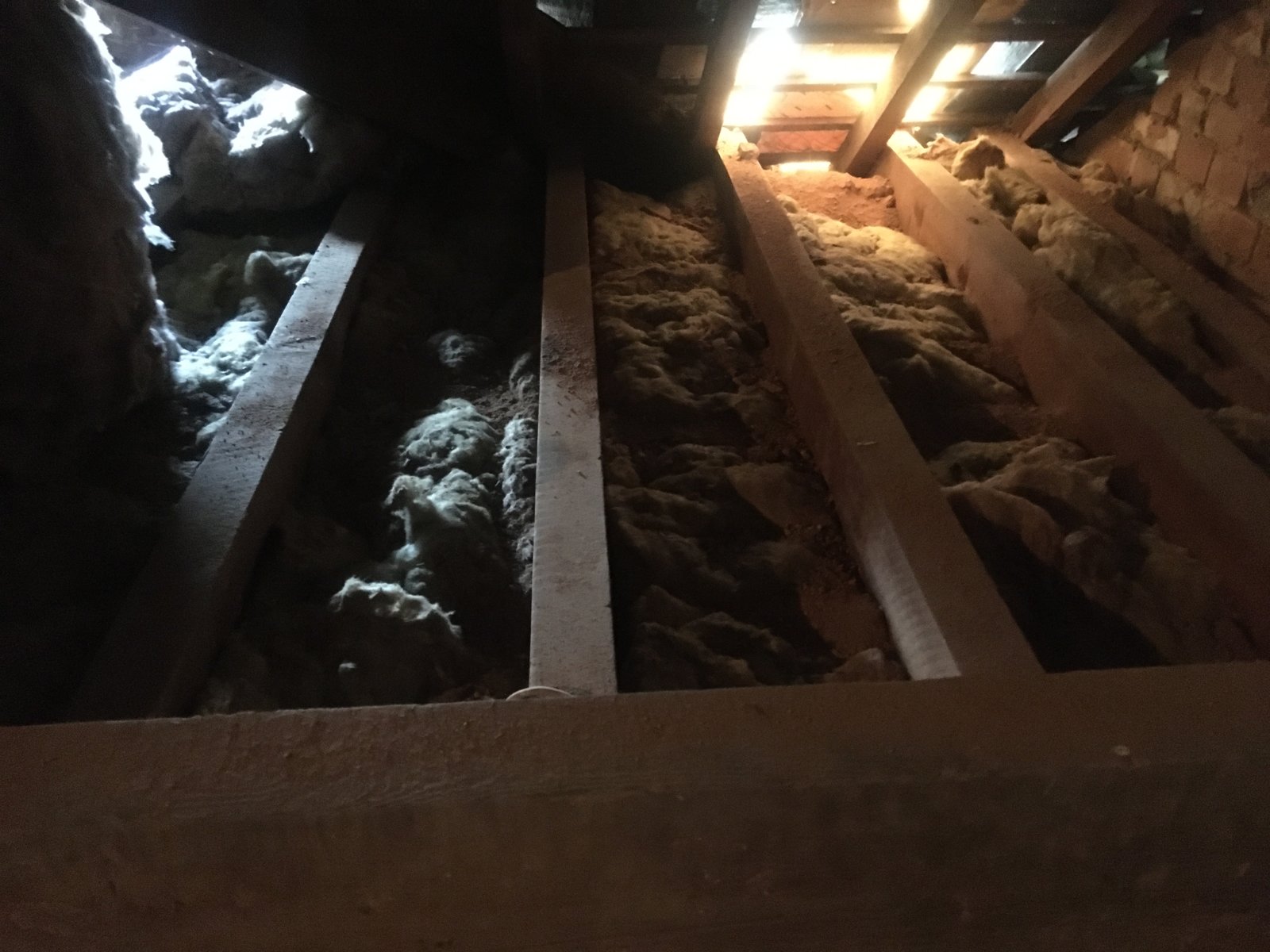

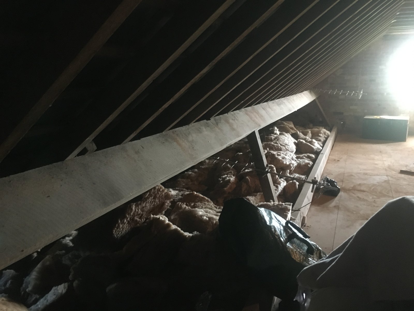

Hoping this isn’t structural, because i would like to move it to make our loft conversion a little larger. If I kick it, it moves a fair bit. Haven’t gone in with the crow bar yet because I was hoping to find out what it is first. Is it a roof binder? It runs at 90 degrees to the floor joists

Thanks Noseal, There is indeed another on the other side.

If your intention is a loft conversion then no part of your present flooring arrangement will stand BCO's or structural scrutiny.
You dont need a SE - you simply need a properly worked out set of drawings before making any next move.
Dont touch the binders, they have no hangers, and if they did have hangers then all weight would be transferred to the unsupported purlins,
and might lead to possible joist sagging with a heavier floor load.
The makeshift floor you have at the moment is literally, a storage shelf - its not a structural floor.

If they have been "approved" then have they have been approved with or without the binder?
Binders, as the name suggests bind ceiling joists together to stop them bowing and cracking the ceiling, and are used when the joists are too slender to support themselves. I can't believe that an engineer would "approve" ceiling joists for use as a floor when they are supported by a binder - elese why would the binder be there in the first place?

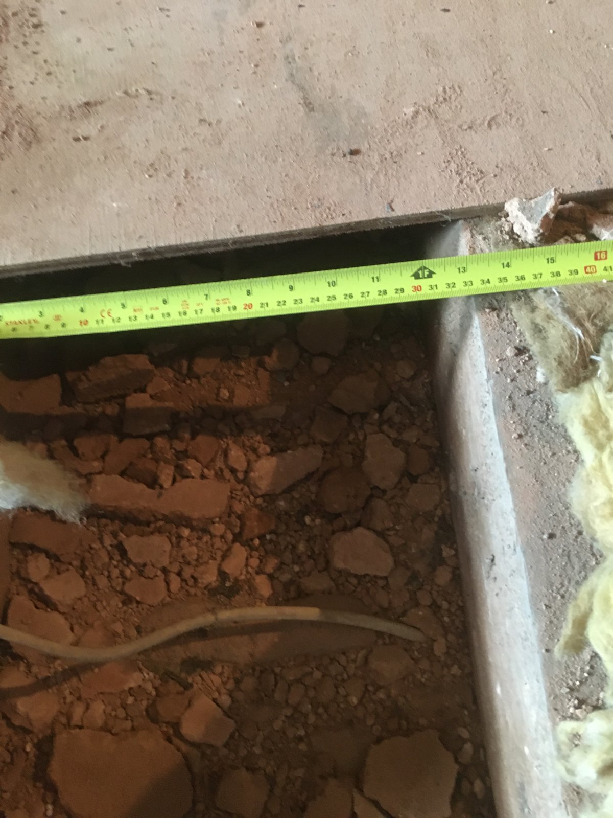

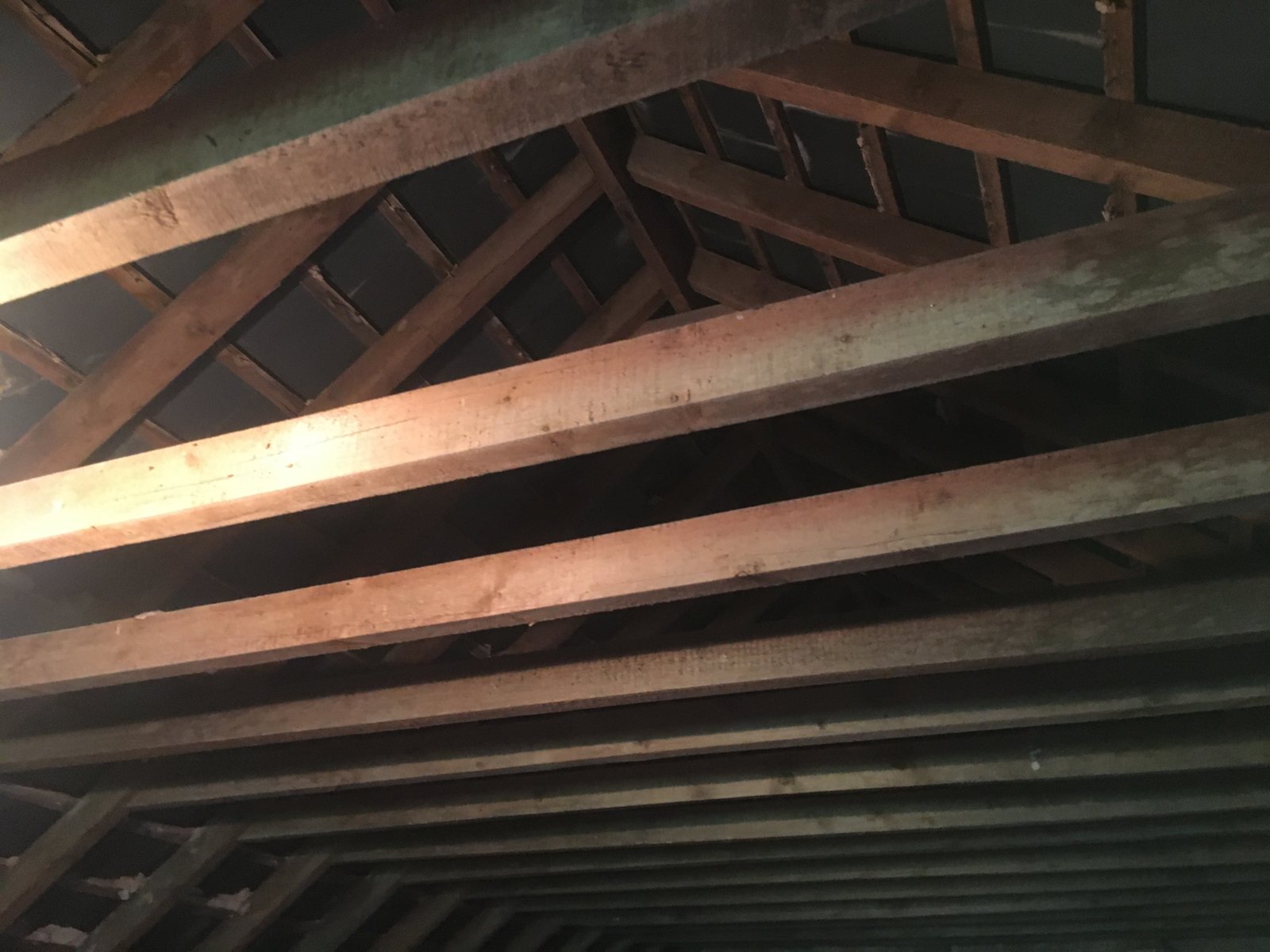

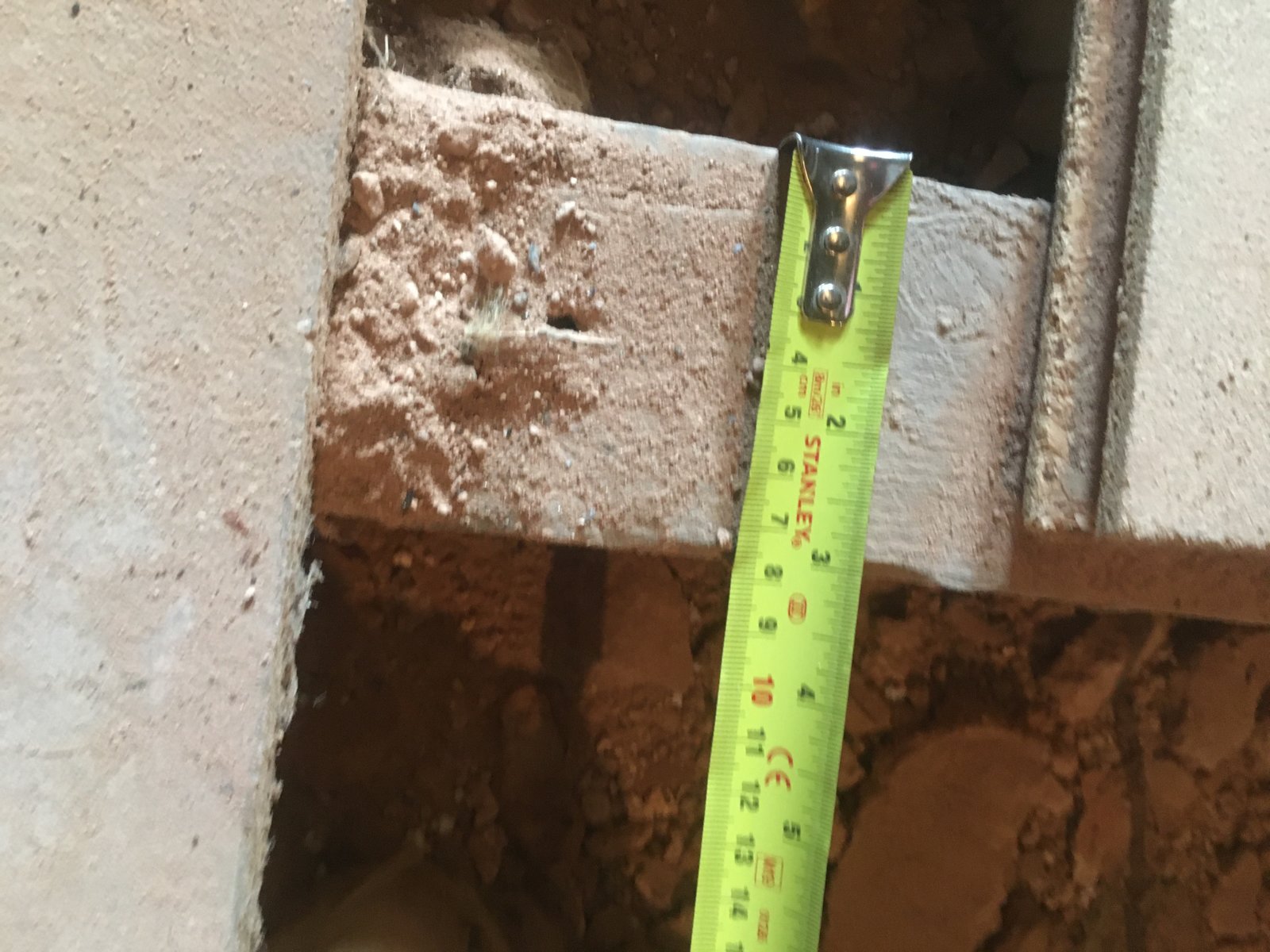

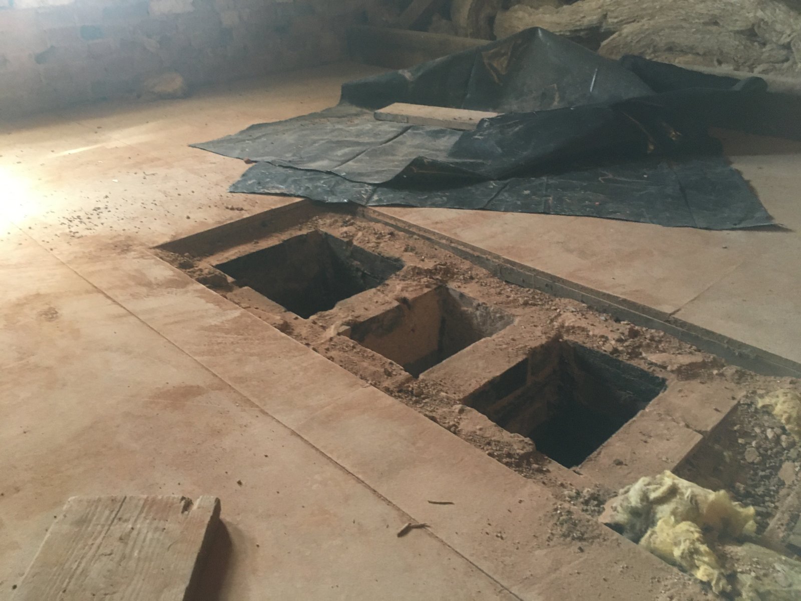

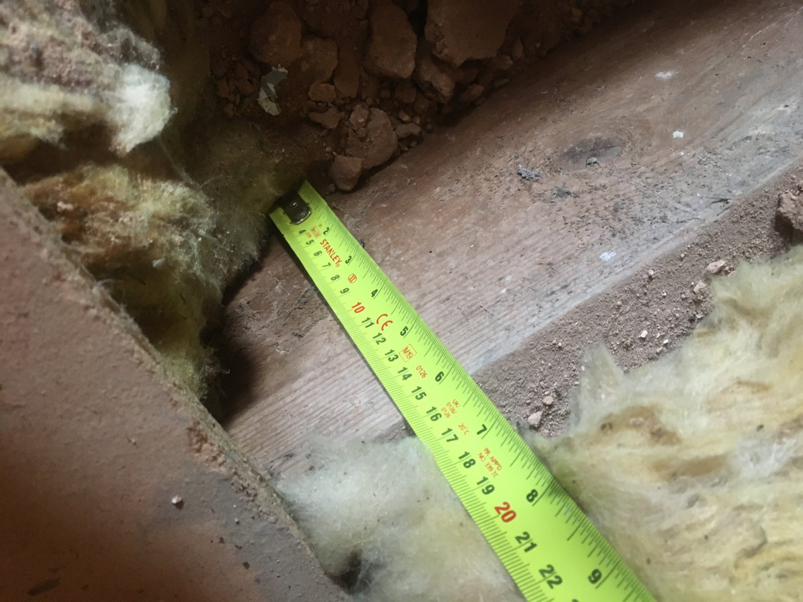

Just been up with my tape measure and the loft floor joists are 3" x 6" with 13" spacing.

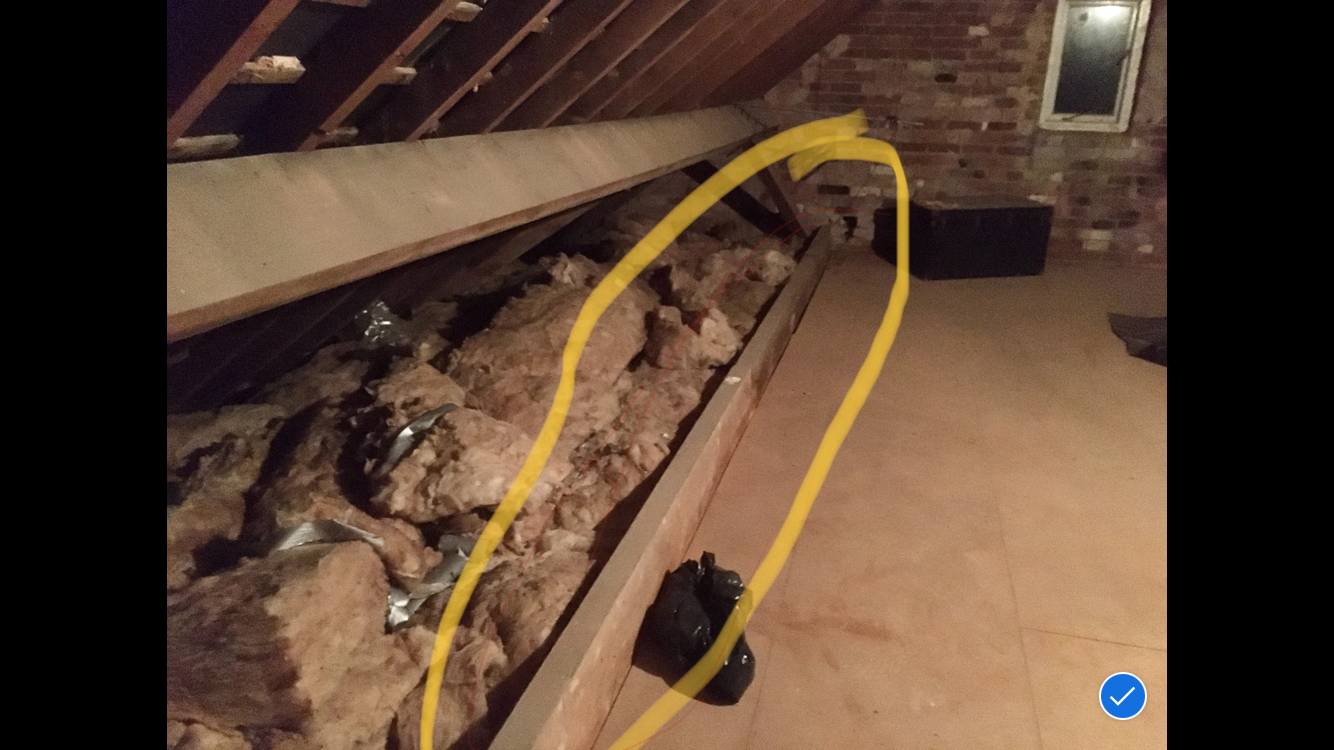

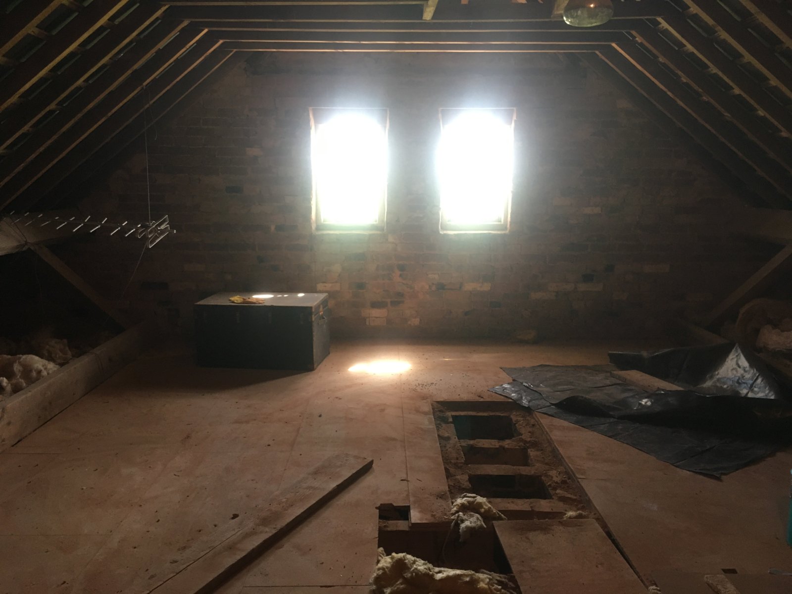

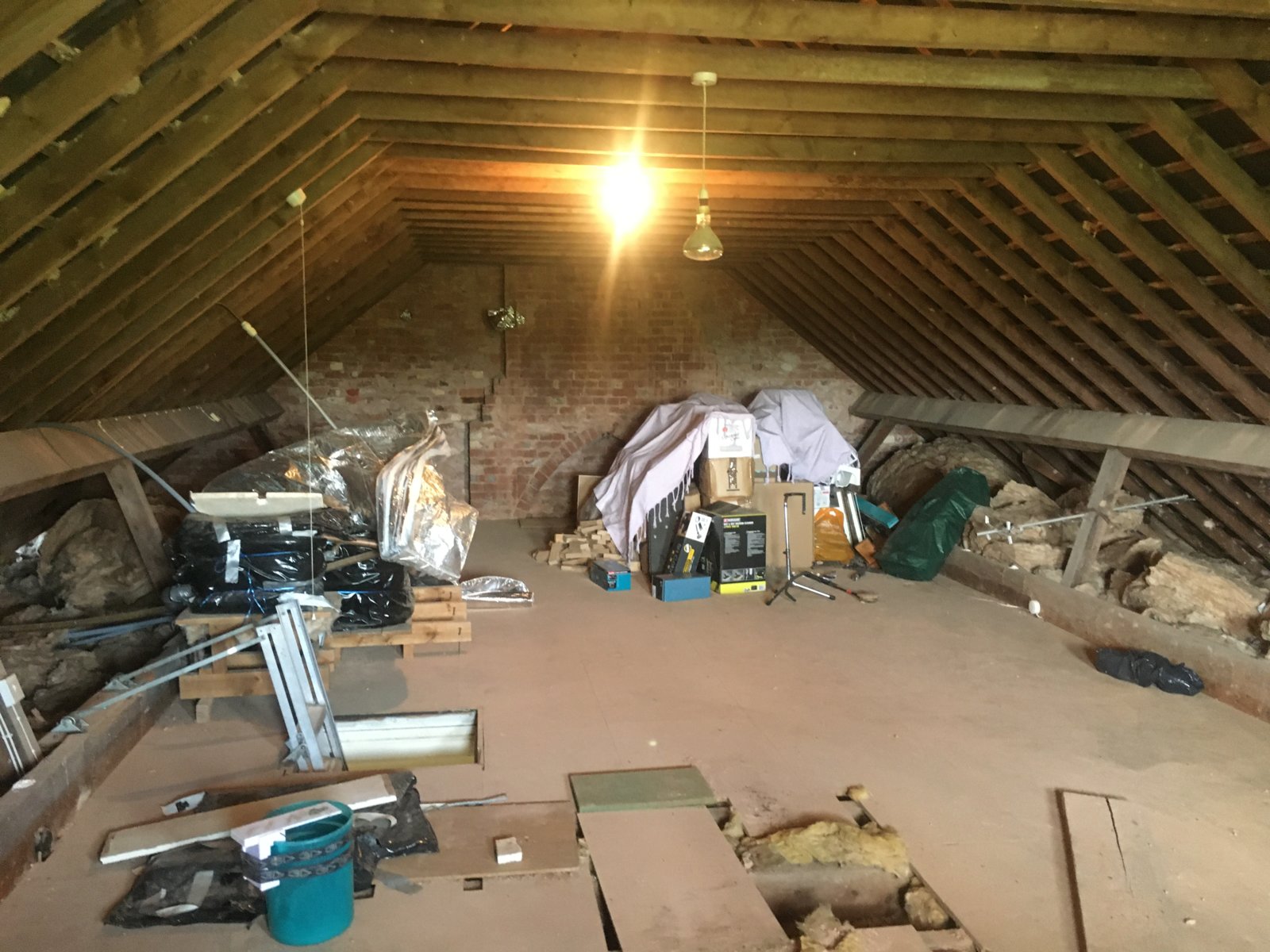

I took a few more pictures whilst I was up there. my question in this thread has already been answered now. but if anyone has any words of wisdom on what to do with this space I would be very grateful.

My assumptions were wrong - 3" x 6" is a surprise and they will span halfway across fine - so i now assume you have supporting walls below?
3" x 6" wil span about 11ft 6" and i guestimate your total span at about 20ft.

The binders may have been moved back in the past - perhaps to give more floor space.

Yes we have brick supporting walls below. Total joist span is 9m ish (30ft) from inner cavity wall to inner cavity wall.
Do you mean the 'binder' span is 9m ? What is the maximum span of the 'floor joists' on to a brick partition wall ?
Looks like you have found an old chimney there, that could be your new dumb waiter!
