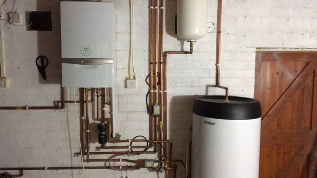

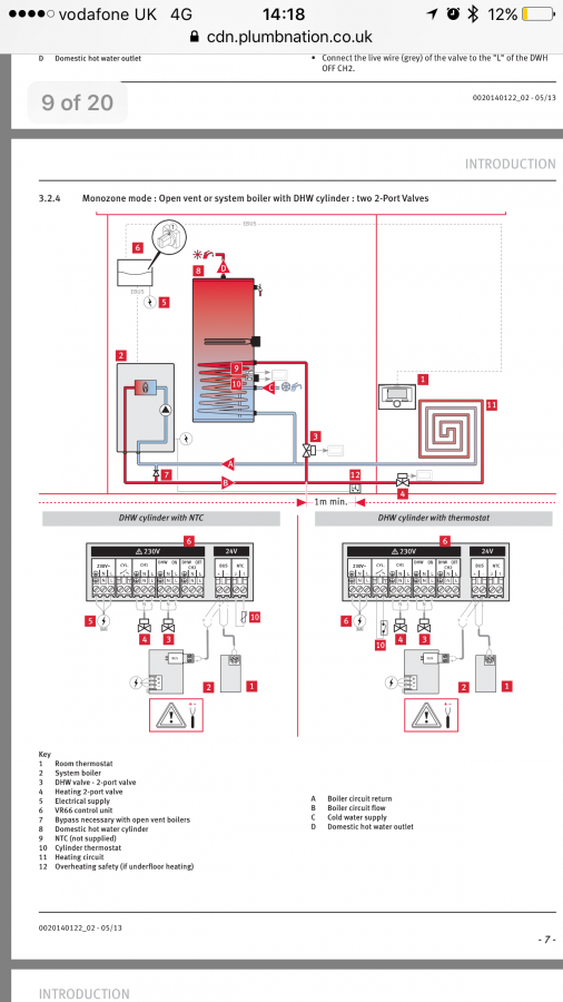

Ok my set up is as in the picture - i am wiring a vr66 to a unistor boiler and a vsmart.
the boiler is current wired to the spur. by a electrition
1) the unistor came with a probe, i presme thats a NTC?
2)i presume monozone mode with two port valves is the correct part of the manual i am refering too?
3) the spur is linked to to the vsmart and the boiler - so 2 3 core wires should come out the spur?
4) should i run wires under or over pipe? whats best practice
5)
here is the process i will be taking.
1) wire central heating valve to CH1
2) wire the hot water valve to DHW ON (DHW off does not need to be used?)
3) wire the bus to the boiler AND the vsmart thermostat
4) wire the cylinder probe to NTC
5) wire the 230v to spur.
6) make sure bus is in monozone mode
7)Hope it all works!
do you agree?
6) any other tips or hints so it dont go wrng or to make it look neat
