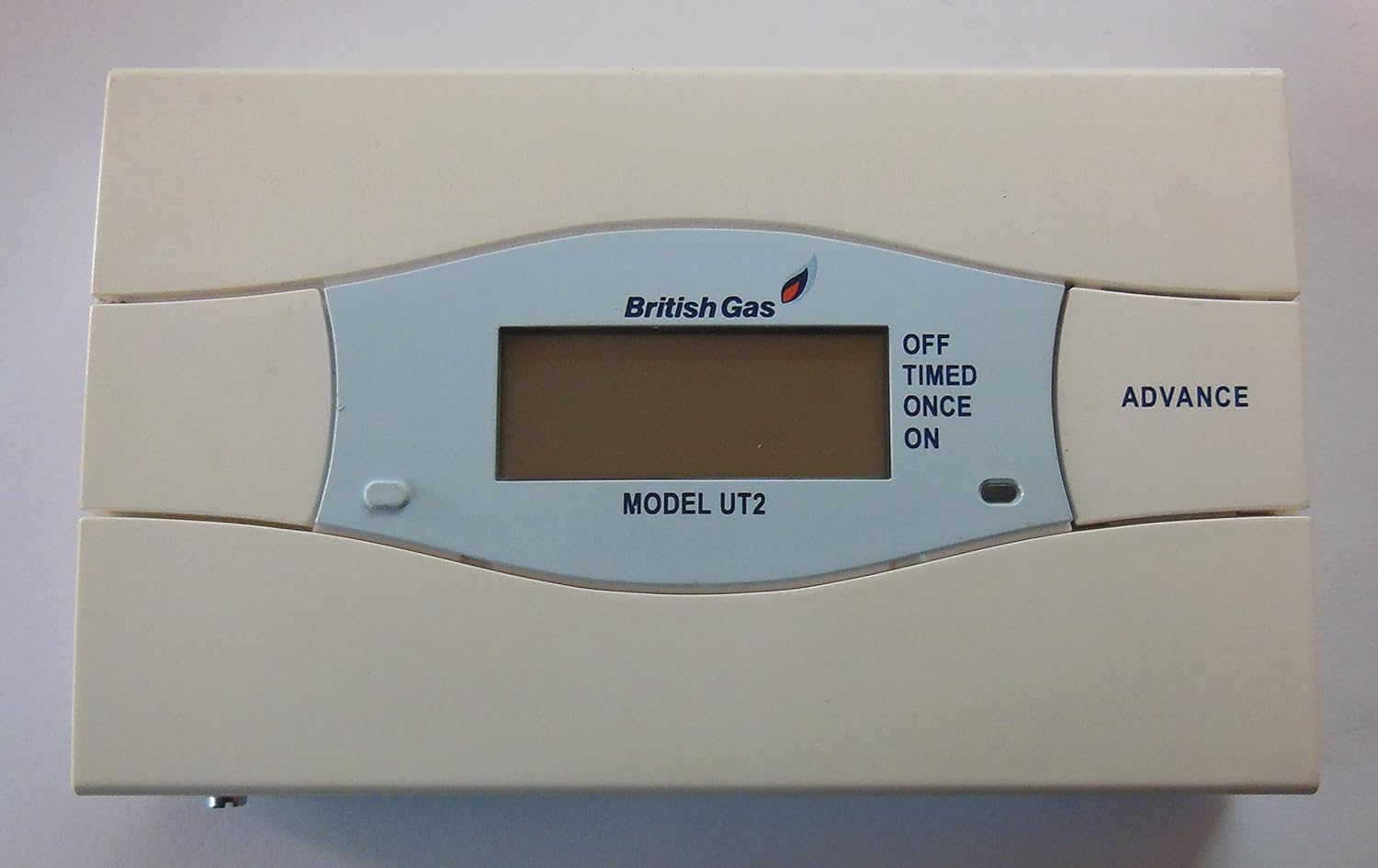

It's a UT2, so it only has the option to turn on the 'advance' function I believe? I've attached a picture of the model below. I will try and get you a picture of the wiring on both backplates but will have to order a small set of screwdrivers as the cowboys from BG have positioned the boxes so close together that I only have an access of around 3" between each box to try and get to the screws underneath.

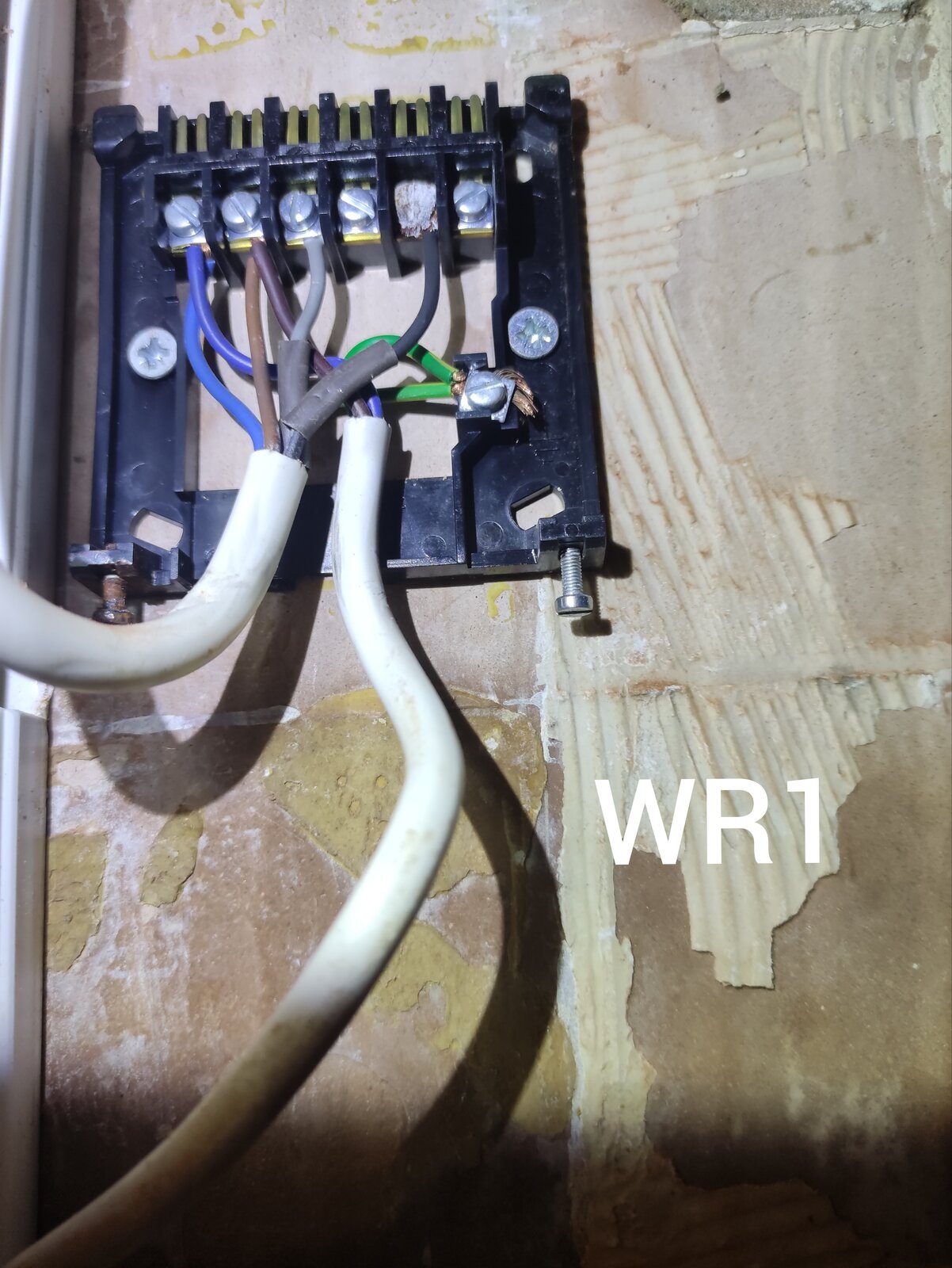

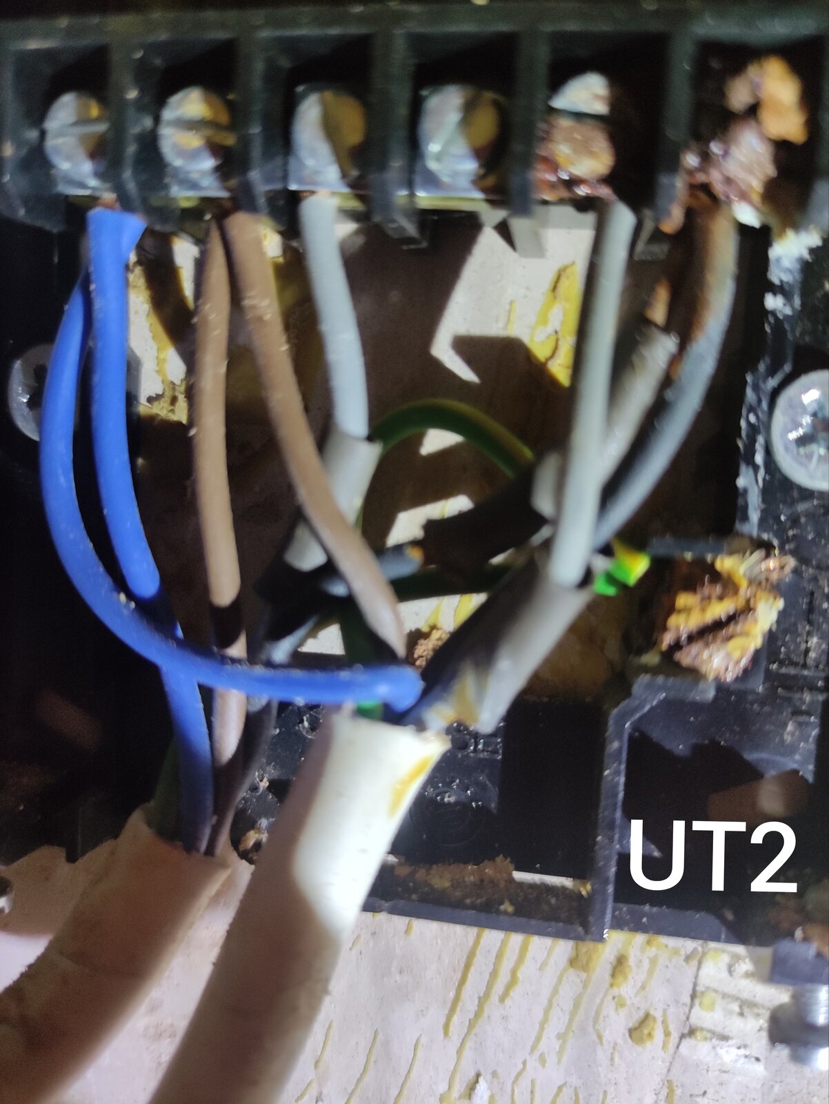

Here's pictures of the wiring going into the backplates of the UT2 and WR1
A wider photo of your controls may help us understand - does the cable from the FCU (fused connection unit) connect to the WR1, before daisy chaining to the UT2, and boiler?

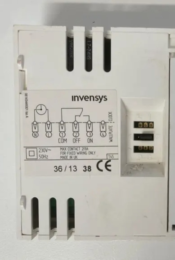

The schematic for the UT2 should look like:
The spare terminal 4 looks as if it is being used to link the thermostat into the circuit.
Given the corrosion on the UT2s back plate, I wouldnt reuse it.
Your WR1 backplate looks ok though.
And if you swapped the cable connected to the UT2 for the cable connected to the boiler (matching the existing wiring colours), the Hive receiver should work!
I.e.
I hope that makes sense! :)
You are correct. There is an isolating switch below the WR1.
So, if I unwired the UT2 and took the wires out of the UT2 backplate (which are going to the boiler) and wired them exactly as they were (colour wise) into the WR1, it should work?
I guess I would leave the isolating box wired up to the WR2, but remove all the other wires in it's backplate so that the boiler wires replace them?
Yup!
and double yup! :)
