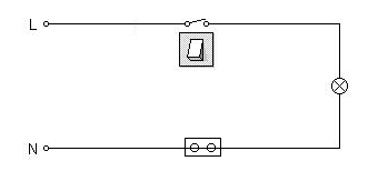

Hello,
I'm having a bit of a problem in fitting a dimmer switch and would very much appreciate some guidance.
In my lounge I have 2 ceiling lights which are controlled by a single on/off switch on one wall - there are no other switches in the lounge (or elsewhere) that controls these lights.
The house is circa 1993 and there is a steel-box in the plaster wall where the light switch is mounted.
When I open the light switch box, I see that there is the following:
1 - an Earth wire, yellow/green, that is terminated onto the steel box via a brass screw.
2 - a grey, 2-core cable, with black and red wire inside it.
3 - ANOTHER grey, 2-core cable, also with black and red wire inside it.
The wiring to the on/off switch is as follows:
- BOTH of the black wires from the 2 grey cables are joined and in a connector block, they are not wired into any part of the on/off switch.
- BOTH of the RED wires from the 2 grey cables are connected to the on/off switch connection points.
So, now I am trying to fit a 400w"2-way dimmer". This has the standard 3 connection points 'Common', 'L1' and 'L2'.
I have tried what I thought would be the logical way to connect this dimmer, and then every other way that I could think of, and nothing works! To make matters worse, now I cannot seem to connect the two red wire back correctly either.
What am I doing wrong?!?

Thank you for your comments Ban-All-Sheds. In answer to yours:
- I thought the logical way would be that as described in the fitments guide, from the dimmer switch manufacturer. Evidently logic does not apply in this case.
- I should have said "every way that a dimmer switch could be fitted, again according to the instructions in various fitting guides from other manufacturers". Ditto re: that logic too.
- At this point, rewiring the on/off switch as it was before does not restore its functionality.
- 2 wires? in the picture above, if you look carefully there are actually 5. I will detail them again. There are 2 red wires, and 2 black wires. There are 2 earth, wires within the grey cables that have had the green/yellow earth sheath wrapped around them. So strictly speaking, there are 6 individual wires, but for the purposes of this discussion, it would be logical to say this earth wire could be considered as 1.
Note that this picture is how the on/off switch is wired.
Thanks again for your help.

What I'm not understanding is:
- When both Black wires are joined via the block, is this a supported, functional configuration?
Yes, it's the arrangement in which power is being brought into the box on one cable (red live, black neutral) and the other cable runs from the box to the light. The neutrals (blacks) are connected directly together leaving the live (reds) to be controlled by the switch.
All you had to do in your case was remove the two red wires from the existing switch and connect them to the Common & L1 terminals on the dimmer - Assuming, as has already been mentioned, that the light is suitable for dimming and the dimmer rated for the wattage of the lights.
- On the videos on YouTube, the electricians only ever seem to have ONE red and ONE black wire (and an earth), which they wire up as you have mentioned above.
That is a different method of wiring in which the power is taken to the light fitting, the neutral connected directly to the light at that point, and a single cable (with red, black and earth) taken to the switch. Normally in the U.K. the red wire is bringing the live supply to the switch and the black is the switched return taking power to the light when turned on.
Either method is perfectly acceptable; they're just different ways of accomplishing the same thing.
