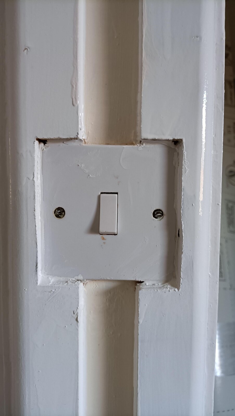

but look at the state of this "light switch"(bad cuts, gloss used as a filler, runs on frames which are also on the door - which no longer closes) - when previously it was screwed into the wood frames itself and filled with grout at top and bottom in-between the frames, painted the same color as the wall.
had I had the offcuts I could have fixed it myself by restoring the frame, back in with sawdust and glue, sanding the frame, re-painting, and fixing the plate into the wood, but I don't have them...
surrounding plates I've looked at don't have enough room (side bits too wide on them) , so I'm wondering if any "real joinery experts" can please tell me the best way to fix this 'schoolboy error" ?look - cuts like dog's back legs, uses gloss paint as filler..
I have many years of building trade experience and have installed a kitchen before. and know of a way to fix it, but would like to hear from the experts...
edit: I reiterate: the rest of the kitchen is of a high standard. THIS is the only issue (so far) but its almost finished
advice from anyone would be appreciated..

If you have had many years of building experience and that picture of the light switch is the standard of the rest of the build then the whole lot needs ripping out and starting again. I'm no expert but even I can tell that the installation of that switch has been done by a road sweeper and he probably doesn't sweep roads that well either.

Perhaps it might have been neater to fit one of those thinner light switches in between the architraves, and not butchered them.
Like this

To have a light switch there is really a poor architectural detail, so to make the best of it it would probably have been better to make-up a single part architrave for both door openings then install a pattress light switch in rhe middle as suggested above (bearing in mind this would require a sparky). Failing that, maybe take the light switch off, install the architraves then add a timber patress between them where the switch is and reinstall the switch on top of the patress (which also requires a sparky).
Cutting round like that suggests that they were either under pressure to get the job done (often the case), or they simply didn't have the required knowledge or experience to come up with a better looking solution. Maybe both. The cut quality is awful either way
Maybe take the switch out, install a timber filler, neatly, with a hole in it with the wiring, fill and sand, then fit a pattress switch?

Maybe a spacer to bring the switch out would hide the bodgery to a degree
Make an mdf square plate with a chamfered edge.
paint it and fix across the architraves then bring switch through.
you could fit a thin batten to cover the recess full height, stopping at the new plate.
Dont bother filling, that’ll look a mess. If going down that route I’d rip off architraves and fit new.

Where the architrave meets the door frame, it very much looks like the decorator (theirs or an earlier one) didn't bother sanding the excess plaster off. Often, in time it blows and results in jagged cracks.
I am confused though, neither the switch nor the screws look new. The painting is pants but was the switch already there? If yes, did it previously have a plastic surface mount back box? If it did, then they might not have been the ones that cut the architrave
