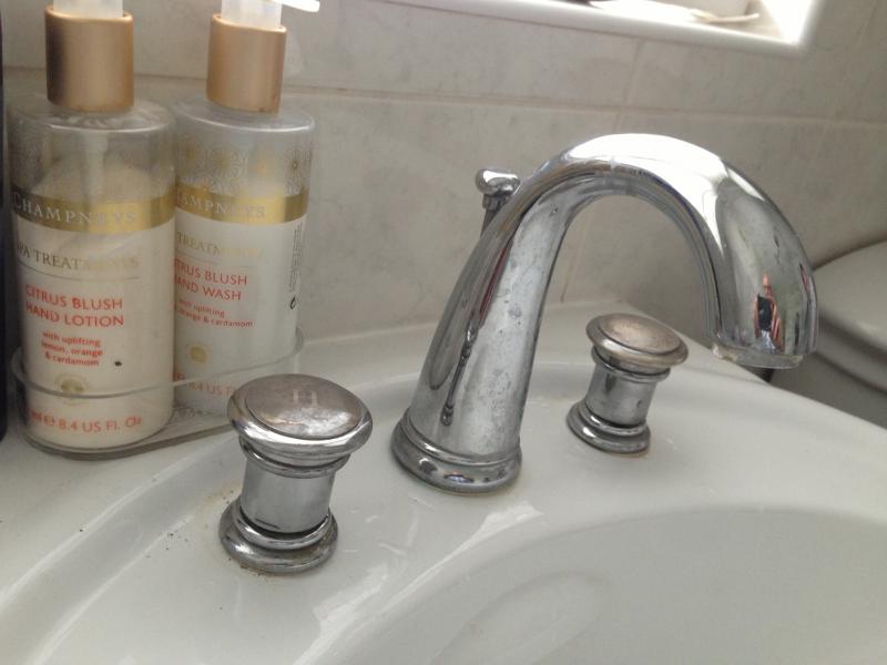

Does anyone know the name of this mixer tap?
It is fitted on a vernon tutbury sink but the receipt my son has mentions a domina tap set
The problem with the tap is a serious drip on the hot side,I've not come across many of these so any advice/ help / instructions would help.
Tia
If they are traditional screw-down taps then change the washer or, if quarter turn then change the cartridge

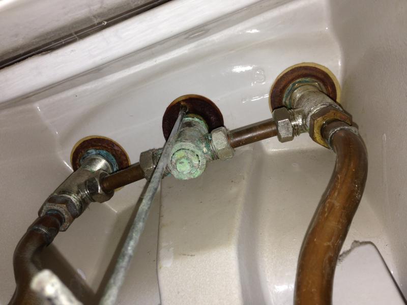

That was the very thing I was attempting to carry out but if you look at the underside photo newboy you will see they are slightly different. They are not a cartridge type.
I have fitted a set like this a long time ago but for the life of me I can't remember how to strip them down to get at the washer
Cheers anyway
Underneath isn't relevant!

You think the "h" cover unscrews rather than flipping off?
Not arguing ;) but I think they flip off - try prising round the back carefully
Hi nige
I've been back twice and had no joy at all with prising or unscrewing

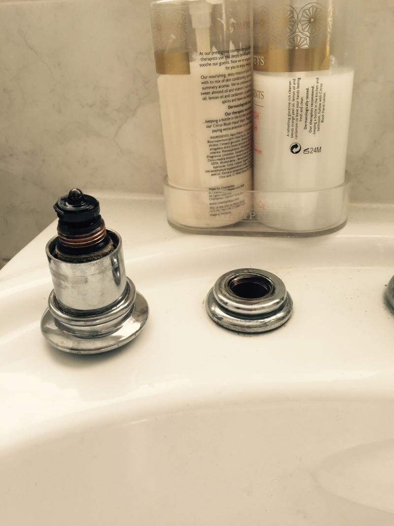

He identified the taps as jacuzzi Modina, the taps probably arnt made anymore but the company that bought the company etc. is silverdales in n- u- Lyme 01782 717175
Like the bathroom guy, they advised pressing down on the top of the tap with the heel of your hand, possibly with a marigold glove on for friction and twist/ turn. As the photo shows this worked and allowed access to the washer
However as before the hot tap is still a problem as I think I slipped the jumper but for now it's working
The cold side was no problem to rewasher
