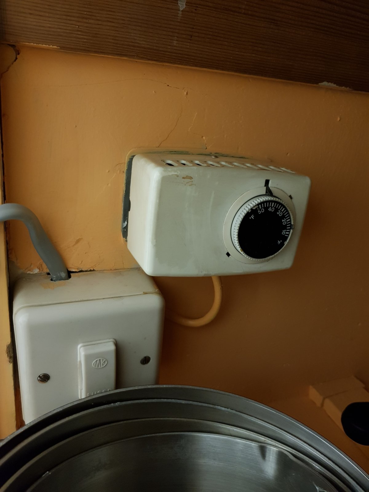

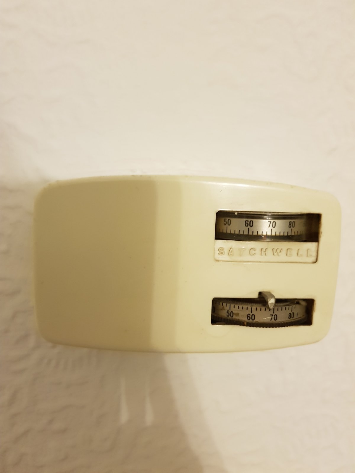

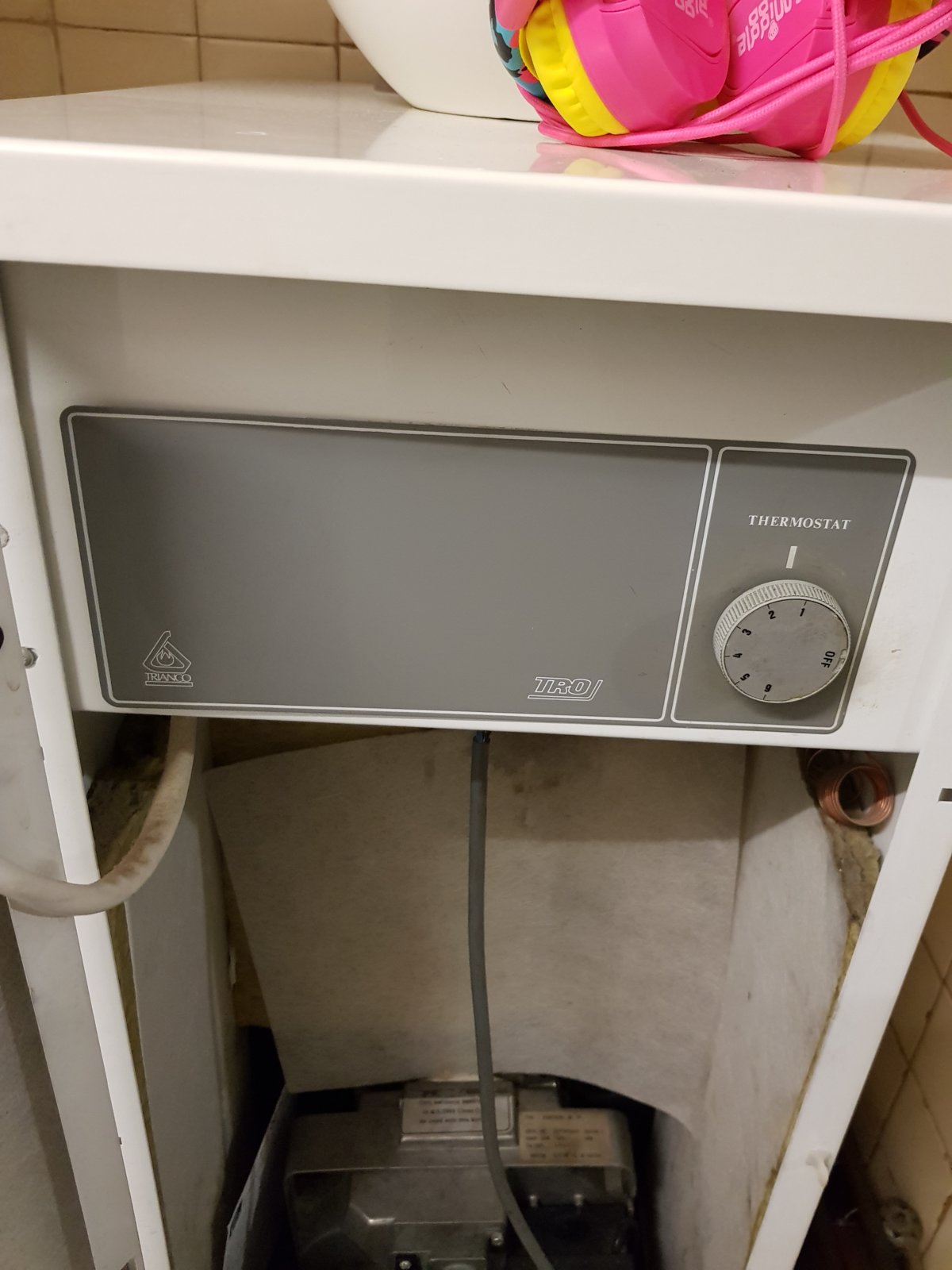

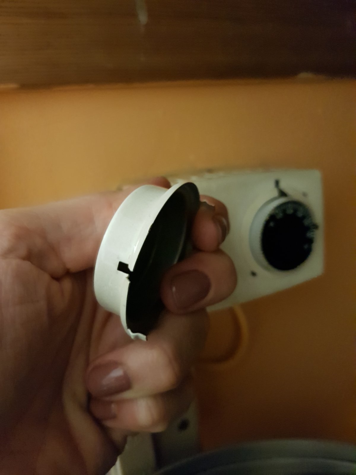

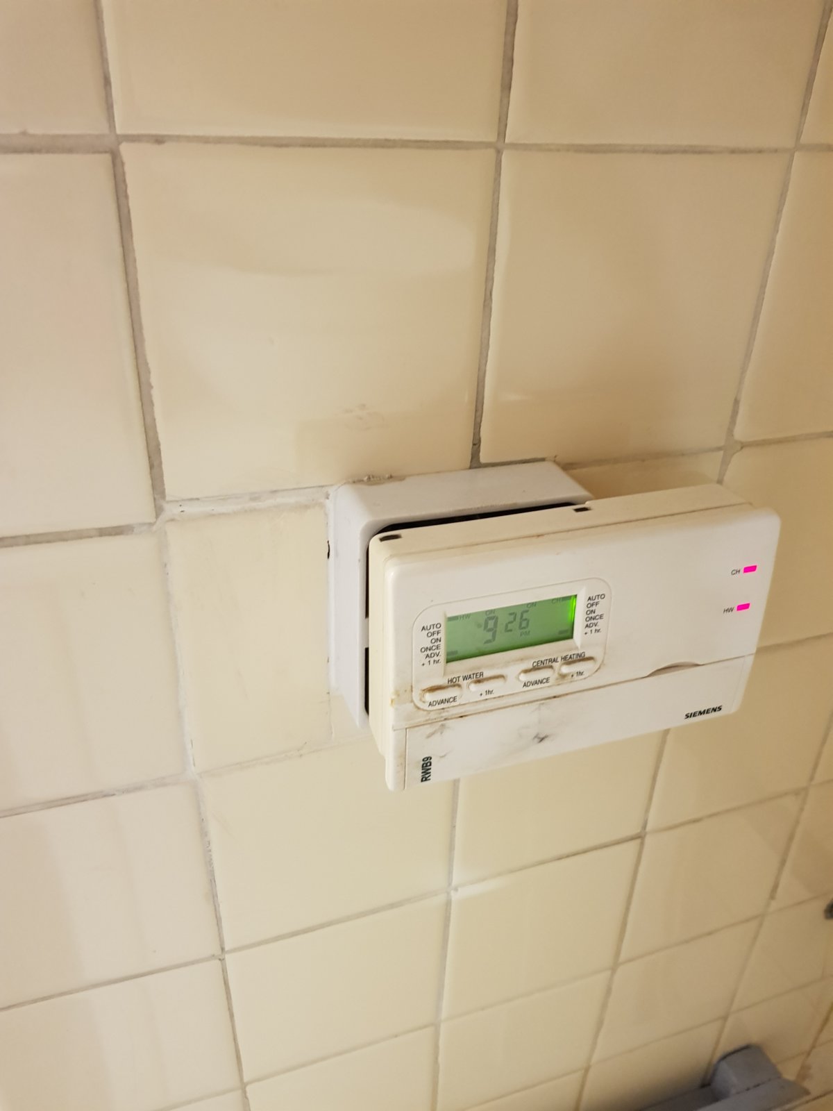

We have recently moved into an old bungalow with oil central heating. The boiler and thermostat are ancient, probably installed c.1970. It appears that the heating only works when the hot water is on and both the heating and hot water are unbearably hot. I have tried to adjust the room thermostat but makes no difference. Can any one help how to use the thermostat so I can turn the temperature of heating

If everything is unbearably hot and your boiler thermostat is turned down to 1, that suggests a faulty boiler thermostat
The thermostat you've broken the cover off is a frost protection thermostat
Does the Satchwell actually turn the heating on and off when you turn it up and down? It may be as simple as it turning the pump on and off
Probably you have gravity hot water, and pumped heating. The room thermostat with the horizontal numbers will just turn the pump on and off in relation to room temperature. To reduce the temperature of the cylinder and the radiators, turn down the knob on the boiler, but you will not be able to turn it to less than 65o C.
First of all, it would appear from your pictures, that you have two different room thermostats installed (Photo1 and Photo 4) so maybe one of them is not connected anymore, or is used as a frost stat (is it in an outbuilding?) If so it should be set to about 5 degrees as it is only there for frost protection. If it comes on it will override the other controls and keep the heating going.
Also, you don't post a photo of any hot water cylinder thermostat. So, if there isn't one, there will be no control over the hot water temperature. It will just slowly get hotter and hotter until it reaches pretty much the same temperature as the setting on the boiler thermostat. oilheads suggestion will fix this, but reducing the boiler temperature will also cause the temperature of the radiators to drop, so the rooms will take longer to warm up.
