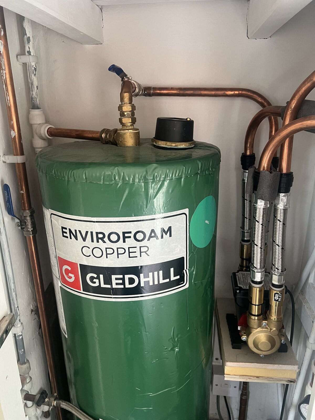

Hello everyone.
Hope anyone can help me please. I got a plumber to install a shower pump Grundfos STP 3.0 B to get enough pressure to run a shower and hot water in the basin on my new bathroom. Also bought this one since later I plan to put a new shower on the old bathroom (currently it has an electric shower).
Problem is that, this pump which is supposed to have a low noise operation etc (many reviews online state how quiet it is), it’s nothing like that for me. It’s really noisy and it’s does this pulsating on/off vibrating noise…really loud…so much so that my neighbour can hear it on the other side of the wall. Even worse is that, even if I turn the shower or hot water basin tap on for 10 seconds, it then continues to do the same loud pulsating noise for a good 20minutes after…nothing happens when I turn the cold water tap. Surely this is not normal. It was not a cheap pump!
Is this a sign of a faulty pump or installation issue. What shall I do?
For info, a photo of the set up. I also put a new hot water tank next to it and the cold water tank is in the loft directly above this photo, maybe 1.5/2m above.
For info, I’m completely ignorant when it comes to these things as well, which doesn’t help!
Thanks in advance

Oh dear, that's an installation issue I'm afraid, what a muppet. That pump will happily and wildly resonate it's head off, in what is in essence a resonance chamber of an airing cupboard with it hung to a wall that will just amplify it, especially if the walls are plasterboard.
That needs to be on the floor on a nice thick piece of concrete. Especially if it's got 3 bar worth of horses.

Yes….if I turn the hot water tap or the shower thermostatic valve (even if on cold) on the new bathroom that is furthest away, even if for 5secs…it starts but then stays on and off doing that horrible loud noise for at least 20 minutes (counted today)!
I thinking about trying to put the pump on the floor (it’s timber tho) on a bit of carpet maybe? It’s on rubber feet so it can’t be screwed down or anything I assume.
Alternative I could try and get a concrete slab, cut a piece just to put it down underneath…but the space is quite tight in the cupboard floor.

The other issue is that 3bar pump will empty that cylinder and the attic cistern in not time at all. Do you know what size the attic cistern is and the size of the HW cylinder? Given the pump is half way up the cylinder the pump could also be drawing the water level down to below the level of the pump in minutes, causing air to be drawn in and causing cavitation and that would cause all sorts of running problems and possibly the behaviour you are describing.
Who fitted the pump, did they come recommended? If the pump is drawing in air or running dry it can easily be damaged in no time at all. Do know you will always have a certain amount of noise when the pump is running - your is rated @<70Db @1m

A very good point - It should have been fitted from the side entry
But the tank does have a side entry...ive checked. I would have to create an opening...sounds like a very tricky job.
Im really hoping that putting the pump on the floor will resolve it. Fingers crossed!

It should come out of the side otherwise you will have air in the pump - Do it once and proeprly

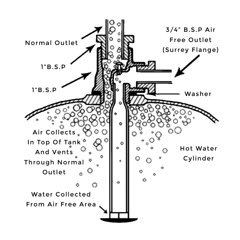

But shouldn’t then the tank have an entry/connection on the side? Is it normal and easy to create one on a round copper cilinder? This diagram shows from the top!?
It does have a warwix flange so that is there to minimise air getting to the pump.
Does or doesn't? An essex flange could be cut into the side of the cylinder but may not be needed.
The trouble with a 3bar pump is that is moves water very quickly, it can in some instances draw water faster then the cylinder and the attic cold water cistern (CWSC) can replace it. Without being onsite it is really hard to suggest whether the supply and pipework is suitable to feed that chunky pump. I presume the supply to the cylinder from the cistern is 22mm?
I'd certainly move it to the floor to start with, then see how things go from there. I'd also run the pump on an outlet to test it's max output and see how the supplies deal with the draw. Can I ask, is your BIL qualified/experienced?

you already have a flange fitted at the top of the cylinder. Trouble is - it's been plumbed the wrong way round. The air-free outlet at the side of the flange should be connected to the shower pump to prevent air reaching the pump
No it hasn't, the flange they have is a Warwix flange, not a Surrey (S) flange. A warwix flange vents to the side and the dip tube air free water is the centre tube, a surrey flange is the other way around, as per your diagram. Have a look at the flange that is fitted to the top of the cylinder in the first pic
Surrey Flange, top vent --------------- Warwix flange, side vent
