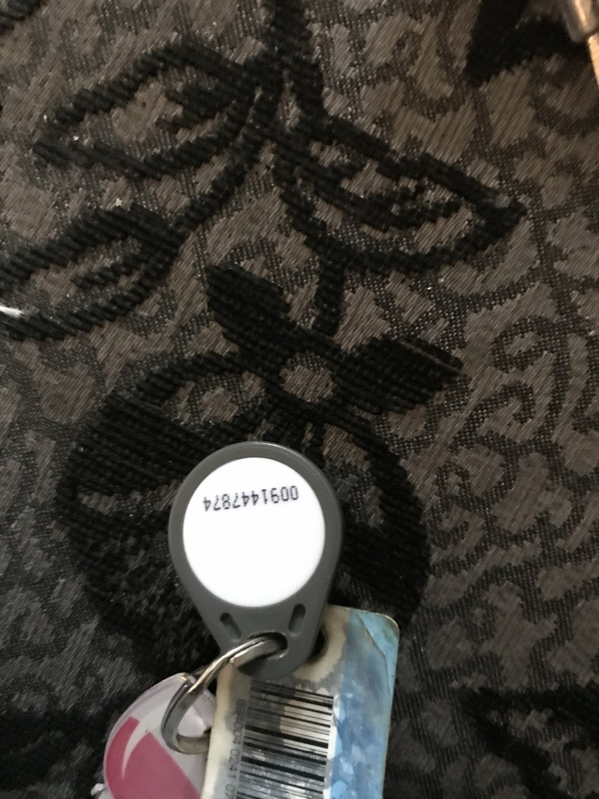

I’m programming the above and got a bit stuck
The entry and exit timer seems to be on final door close is there somewhere in the program that will just do the time and also is there somewhere a program to turn off the banner when set so I know it’s set thanks
Cheers for that do you know if there’s anything on the banner goes off when armed and do these tags work with this system tried but not getting anywhere it says present tag now
What’s that fob from ? Other system / access control ? ....the only fob s that I know to work ( seen ) are ACT access fobs
If it doesn't register the tag isn't compatible, many of the kits come with a pack of 5 prox tags.
Texecom tags don't usually have any printing on.
So as pointed out where has the tag come from?

Sorted the tag one user 1 program time lock it seems to reset now without going into service but still don’t have to scroll through events to reset ?
