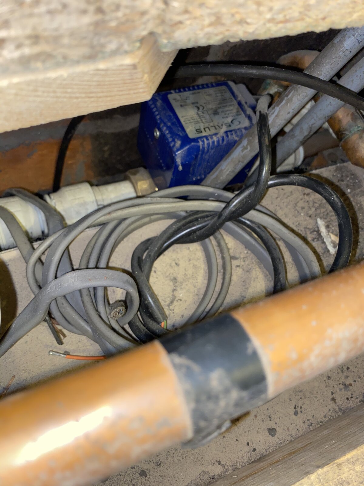

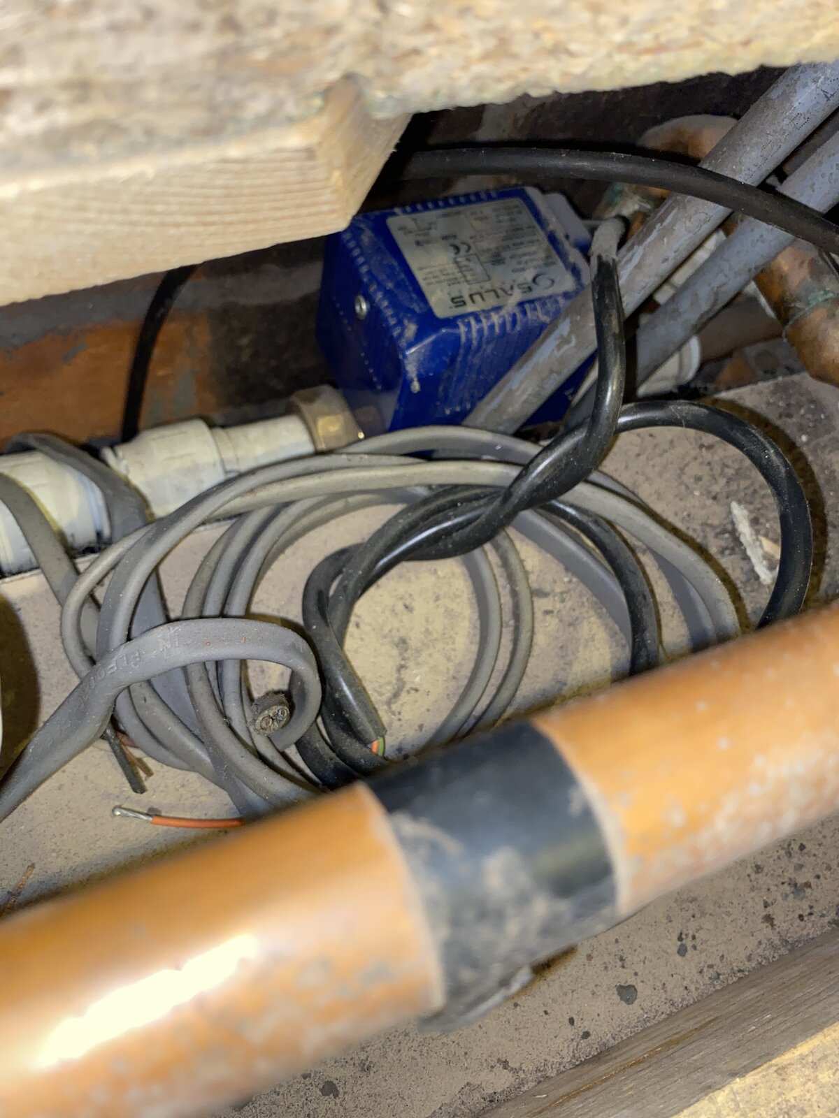

Two things, one no reason why a programmer designed for CH and DHW can't be used to work two zones, but second is this picture.
2c3d8f42-0445-4d45-a2bf-c12cc3af9a24-jpeg.211855
That black coiled up cable seems to have an orange core, so looks like the wires for the motorised valve, you said you heard it ticking, was that simply expansion of the pipes, or the valve moving, as to if when combi fitted pipe work left behind, or if it does some thing don't know, when my dad had new central heating fitted they left loads of the old pipe work in place, not connected to anything.

If it were me I would check to see where that cable with orange core goes, it looks like a motorised valve cable, maybe there is a second valve?
It is the cable for the motorised valve, in the previous post I said from what I can see the valve wire is not linked up to anything. So if the valve is just sat on the pipe and not wired up, I’m guessing it’s already set to open constant?
that picture help more?
The more I look at the picture and think about you saying about old pipe work, the more I think maybe it was from before they changed to a combi, because if you look closely behind you can see the bend or the pipe coming from above going down and behind the valve.

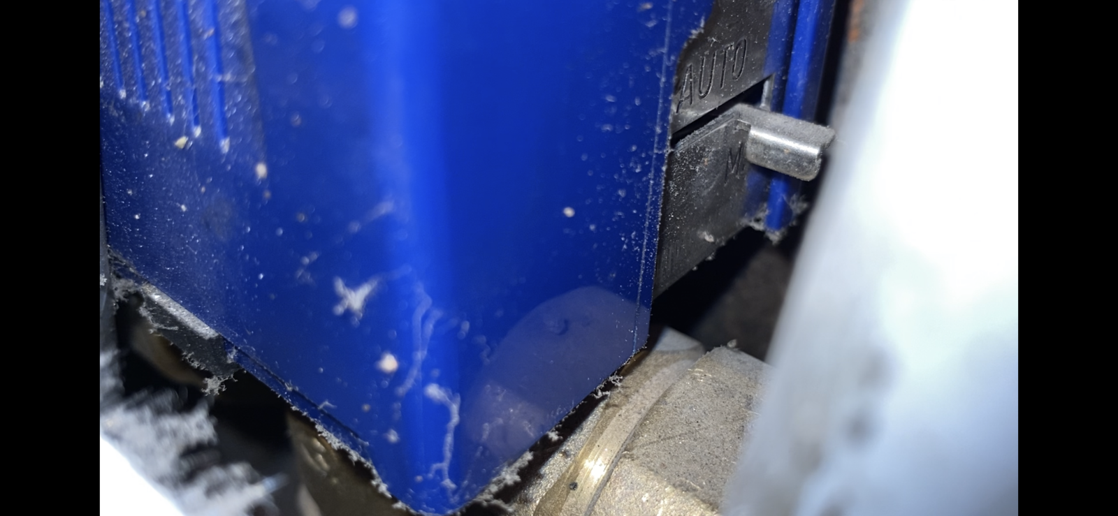

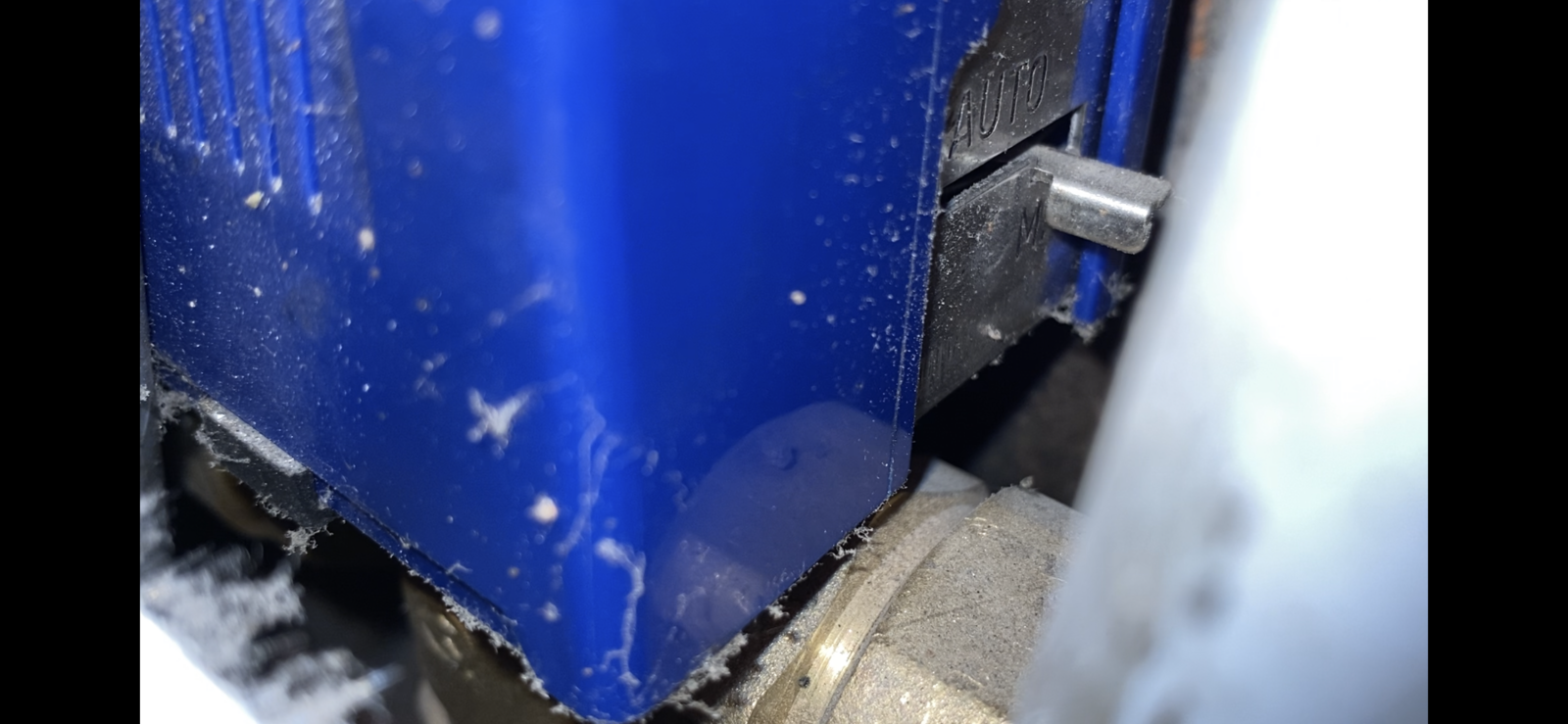

Just took another look at the two way valve and it was already set to manual on the side of the box, so it should just be a case of wiring up the new hive and getting rid of the old thermostat.

Just a little update on the final result of having the hive installed. The British Gas engineer come out, I told him about the radiator in the front room being controlled separately or so I was told by the previous owner, he told me this isn’t the case after looking at the wiring, and decided to by pass all the wiring downstairs that ran up to the boiler and where ever else downstairs by cutting the power to it all and installed the hive hub directly next to the boiler in the loft.
Everything seemed to be fine till later on and I realised that my front room radiator would not come on at all, so I give hive a call back who are useless, they passed me from
Pillar to post and told me the hive is installed fine so that’s all they care about. Said I’d have to wait until January 21st to have someone come back out.
So after having two engineers tell me the front room radiator was not controlled separately this was the only thing that I could think would be the case why it wasn’t working so I had to pull up my front room carpet and hunt for a zone valve that I thought would be the issue... turns out there was one controlling the radiator separately so I switched it to manual mode, which fixed the issue.
