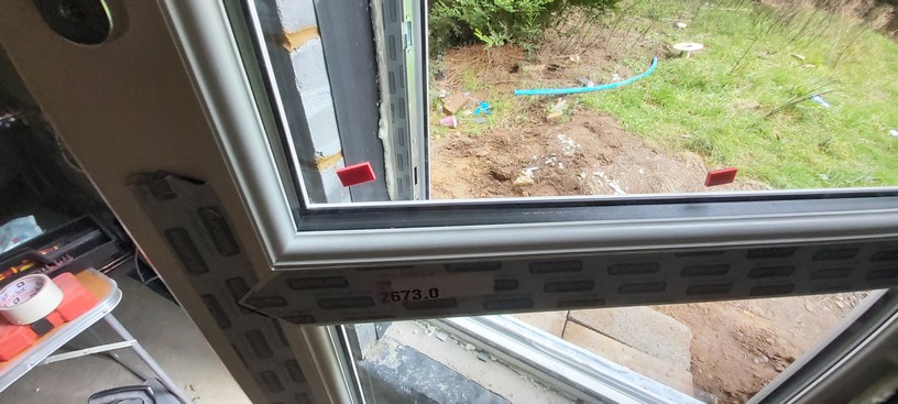

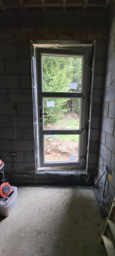

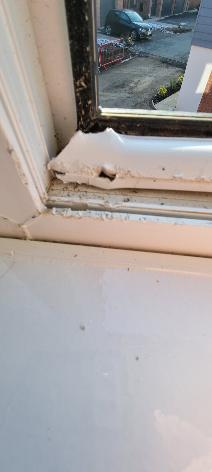

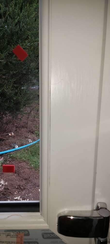

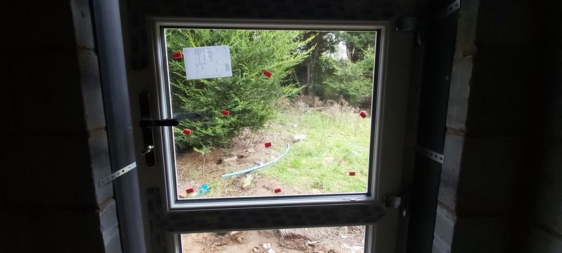

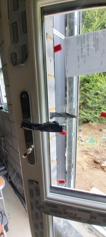

I took some photos today, it was a bit dark inside, hope you can see the beads. On the close up photo you may be able to see how I have damaged the frame and the bead by trying to prise the bead out using the chisel/knife. On another photo you can see how I broke one bead by tapping it too hard, but there is no other way it might go in!
