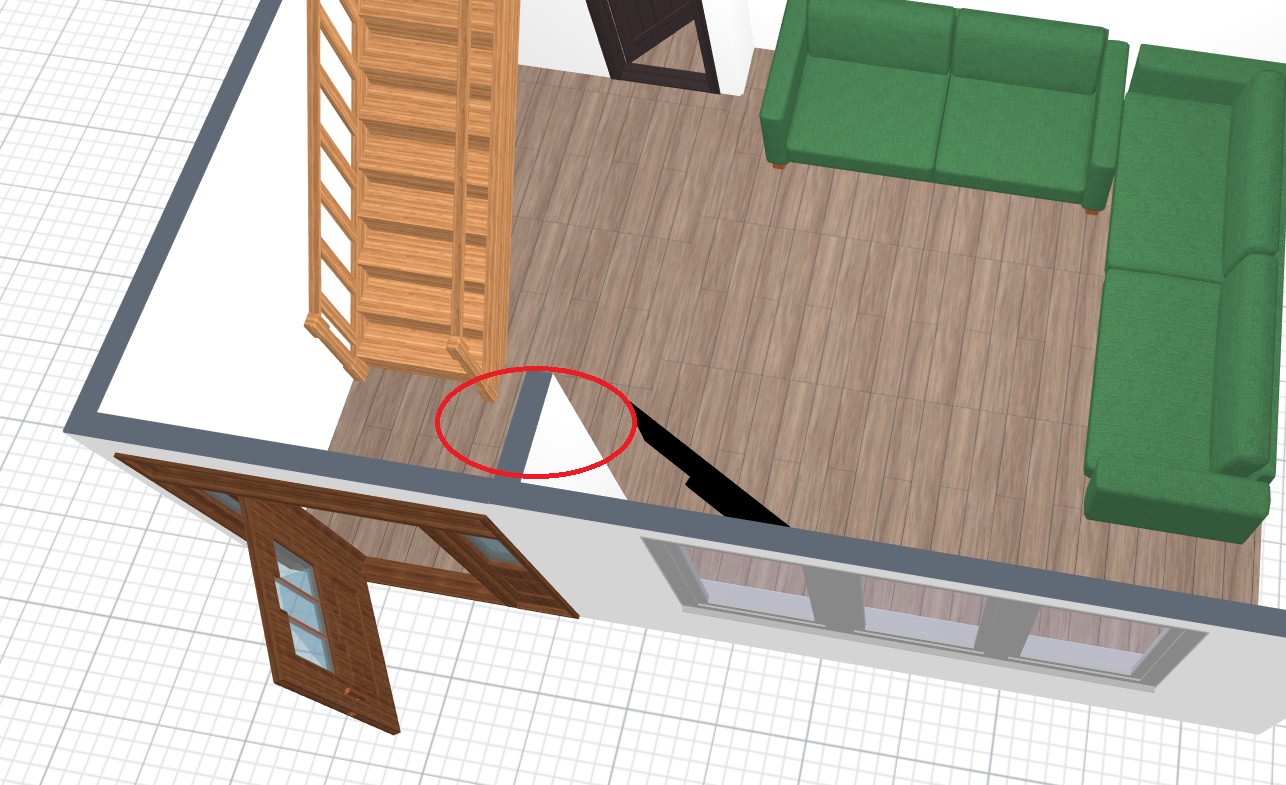

The other question is that my front wall has a door opening then a column of about 600mm wide then a large floor to ceiling window *Shown bricked partailly up in the pic attached. Intersecting the column between the door and the window on the inside is a wall dividing the hall and the living room shown circled in red on the pic attached. This wall is currently much longer with a doorway in it and only goes up to the ceiling level. Do you guys think it is a buttressing wall seeing as its not the full height of the front elevation and if its not can I reduce it right down to 150mm so its just enough to sit an RSJ on?

With the first part, building control would probably only be needed for structural work. As you say, the structural engineers report will throw up that answer.
As for the nib, nibs are there to add strength to a wall as a wall without a return is flappy in the wind. Also, the size is often determined be the size of a lintel sat on it. When your structural engineer lands to look at the chimney, ask him to look at the nib as well.
You will need a b/regs application for the chimney and stack removal and they will need to check various things apart from the structural aspect.
That internal wall is not butressing anything, so can be removed. You wont even need a 150 nib, and can set the steel beam on the external wall.
I would agree with that.
