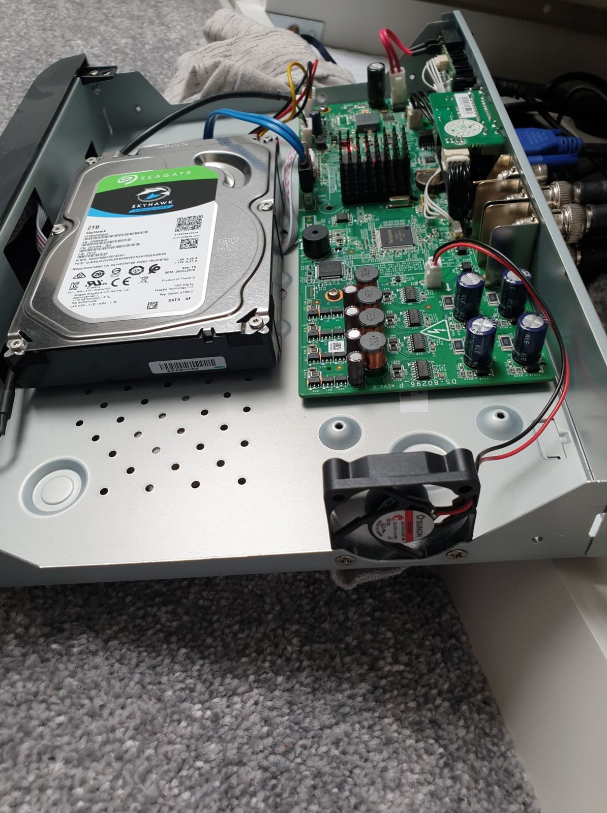

We have had a loft conversion and during that time we fitted a HikVision CCTV system.
The DVR is under one of the draws so as noise proofed as possible but can still hear it at night when there are no other noises.
Has anyone fitted a quiet or brushless fan to the DVR?

Had the lid off it today and just be taking the lid off the noise went down 12 DB.
The noise is not just the fan but the air being forced through the small holes in the case/lid.
I have ordered a silent fan to see how much difference it makes.
Does anything exist that would enable me to move the fan back away from the case? Maybe ducting for a pc and if that would make a difference.
Only other option would be to cut out the 'holes' and make so its one big hole that the fan vents through but thats a last resort as the unit is under warranty still lol

If the total size of the small holes in the case/lid is smaller than fan hole size then fan will be noisy as under strain.
Also all those small holes will be noisy themselves (effectual whistling) as they increase the moving air contact with the metal.
Would be tempted to make a big hole (or perhaps increase number of small holes).
SFK
I left the top lid off altogether, disconnected the internal fan and mounted a large computer case fan facing an inch or so directly over the PC board. Almost silent and far more efficient cooling.
A thermostat switches the fan off below 10C as the cooling isn't needed in winter.
