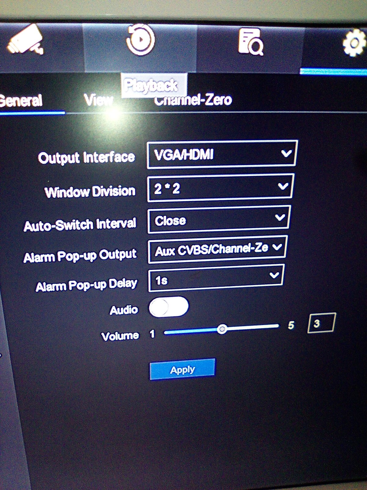

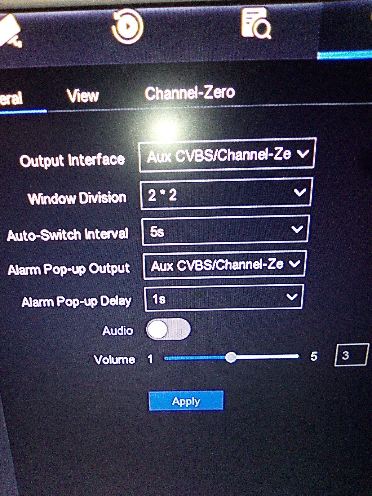

I just upgraded to a new IDS-HTHI-7208 M2/S
All good but I cant get the output to my AUX monitors to be 2*2 with the layout I set in this page.
I keep trying to set "output interface" to aux, but as soon as I leave to the next tab, it keeps resetting itself to VGA/HDMI. Either way I can get the screens to what I want on the live view on the HDMI screen, but not on the analogue connected screens.
(The pop up alarm setting works well and appears on the aux screen.)
I have tried all I can see both on th DVR and via the web interface.
What am I missing?

Yes, I worked it out. It is a toggle type of setting. Once you set the required output and save, it will switch back the option to the default, but the output is as selected.
Thanks to all.
