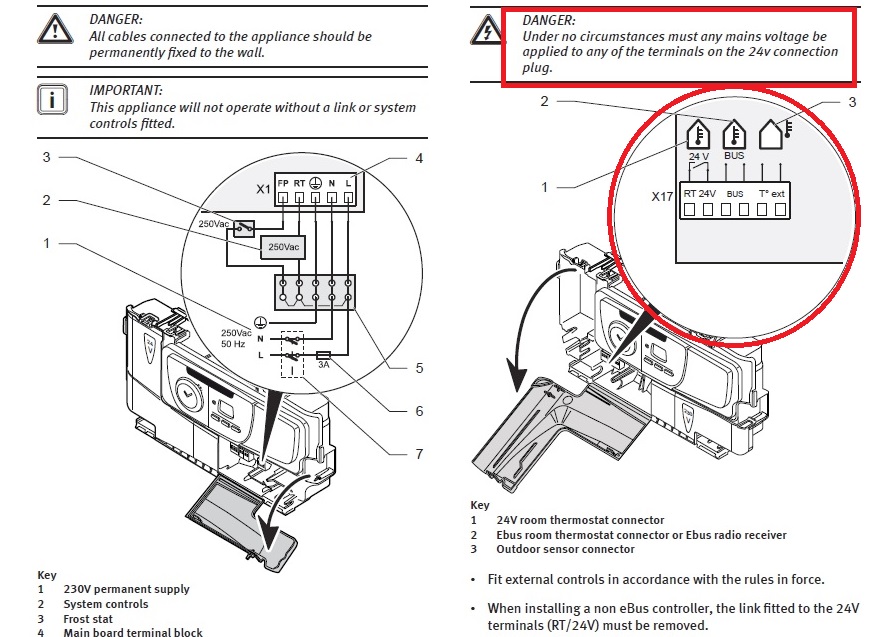

Fitted hive to my combi boiler last year and worked fine.
Family member bought the same thing and I said I’d fit for him.
He bought the heating only version and on the box it says Hive Heating (the hive heating and hot water seems to be advertised as Heating and Hot Water)

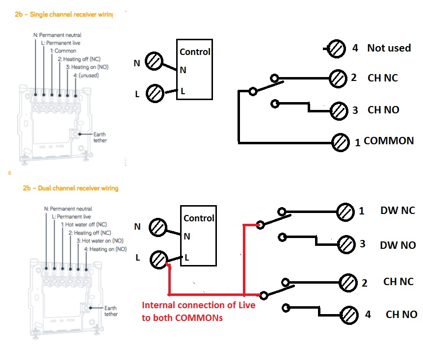

Copied the wiring from how I did mine but boiler has not come back on.
Turns out he’s been sent the heating and hot water version. Coulda shoulda woulda checked but didn’t. So have wired up as single channel receiver whereas it’s a dual channel receiver.
Boiler is Glow Worm Ultimate and now just wont power on at all.
Please can someone help. Family with kids now boiler-less and thankfully not cold but without hot water and I’m awkwardly in the bad books.
