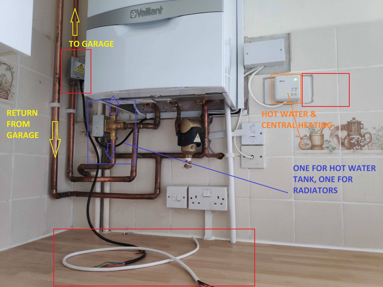

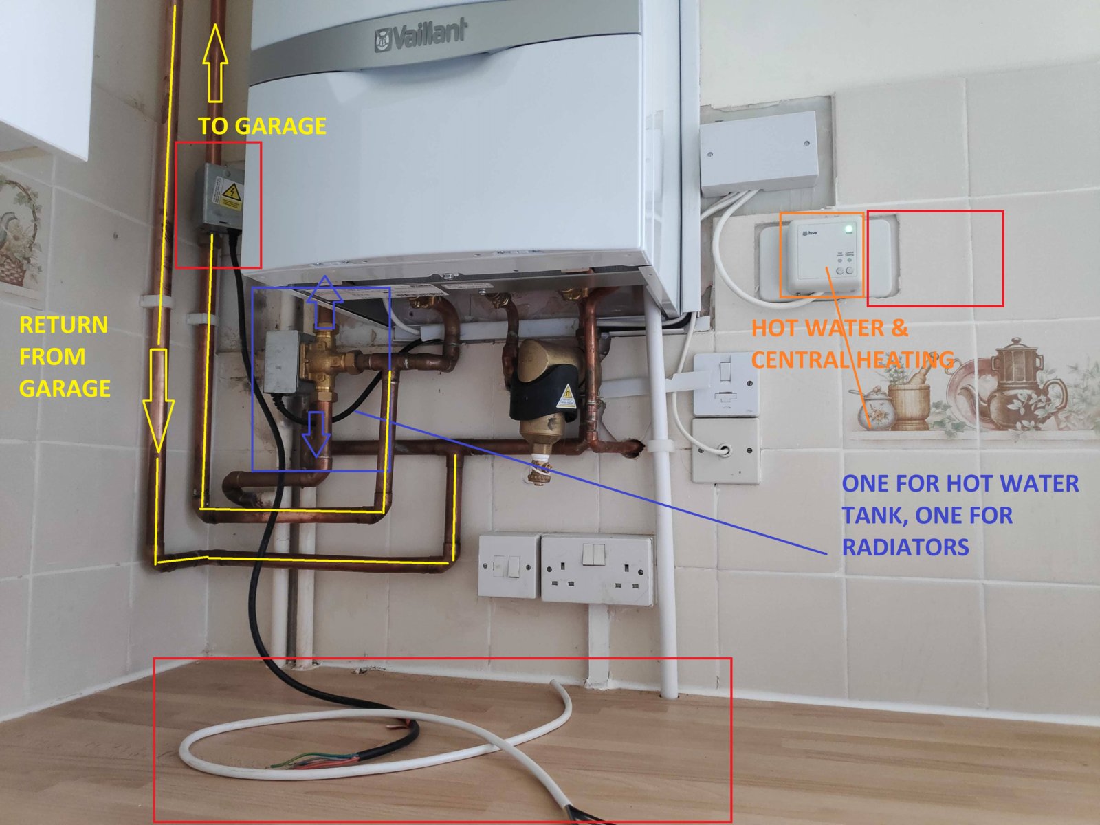

Could someone please take a look at my Boiler/Hive set up and let me know what I need to do to install:
1 x HIVE single channel Receiver
I have;
1 x heating valve installed and ready to go (black wire in red box), which will feed my garage conversion consisting of 3 radiators (heating only, hence single channel).
1 x white cable to connect HIVE receiver.
Hope the picture does most of the explaining.
If anyone is kind enough to reply, please assume limited knowledge and basic instructions :)
Many thanks.
wont work you will have to change the 3 port valve for 2 x 2 port valves and have 3 x single channel hives if you want to control the garage seperately from the CH in the house
Will they not need x3 2 port valves then? They need hot water as well.
Edit: just got what you mean, change the 3 port for x2 2 ports and wire in the additional 2 port for garage. (n)

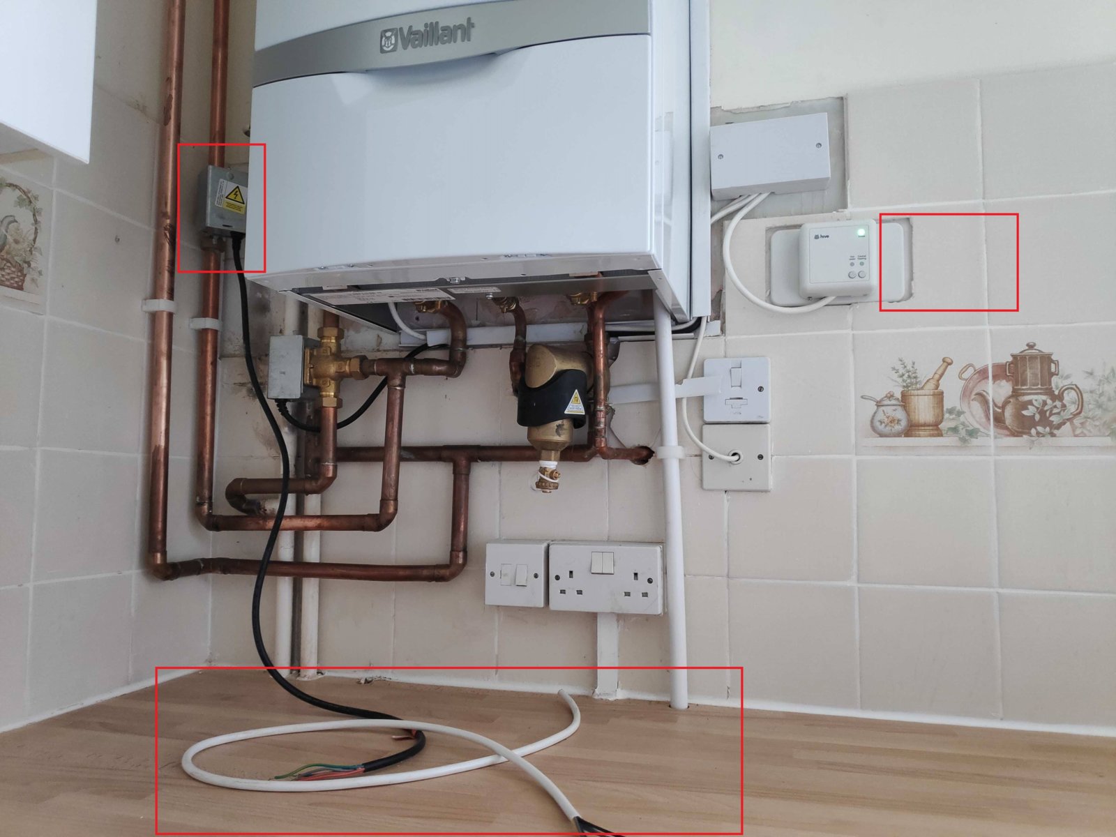

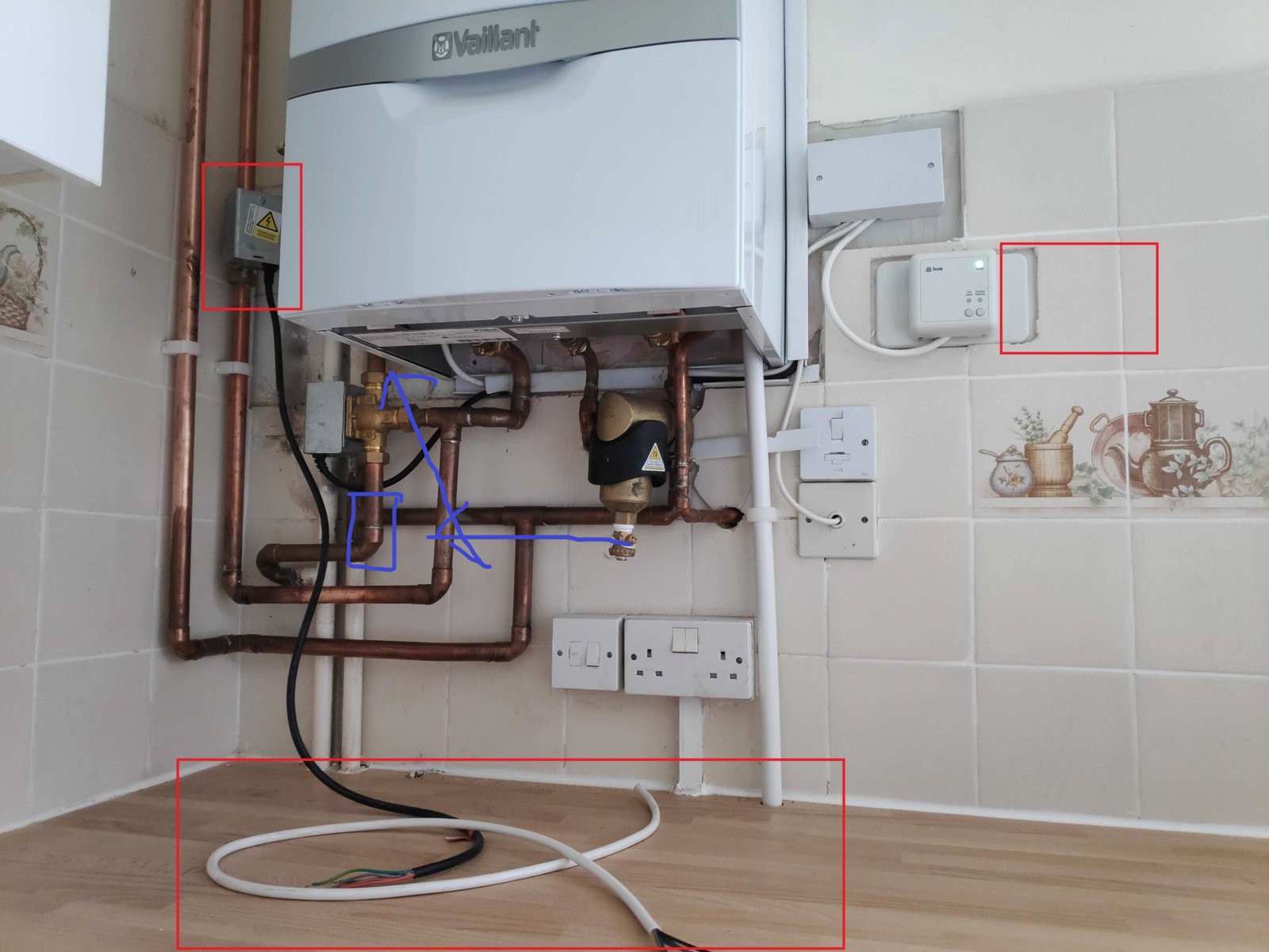

Just out of interest, why wouldn’t this work?
The current active valve has a Hive receiver for the hot water tank and the radiators.

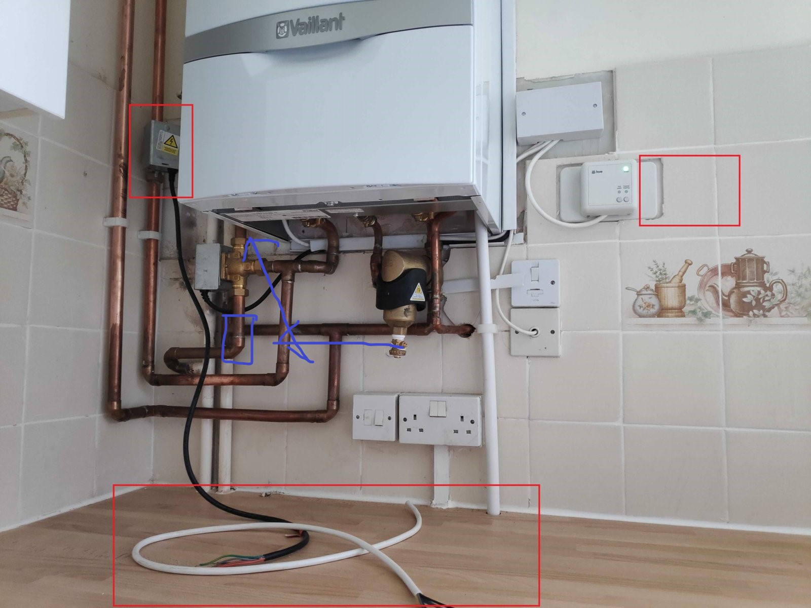

I need the new hive receiver to open/close the new single valve? The 22mm pipe work connected to the single vale has been added and only goes to the garage. So I was hoping to install a new hive receiver to open/close just that valve and leave the existing system alone.
I have added a new photo with more details
because the three port can only move to mid position , heat only or HW only, it can not block off both ports so when both circuits are satisfied it switches the boiler and pump off, the extra zone valve when activated will keep the boiler and pump running so will circulate through whichever port is still open on the three port, usually the HW

no need for that, if you swap the three port for 2 x 2 ports you can use the existing twin channel hive to control them , then just a single channel hive to control the new zone valve for the garage

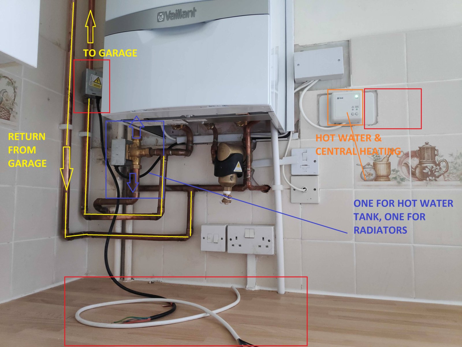

with 3 x 2 port valves it is called an S plan and easily wired
here is the positions of the replacement 2 port valves , just have to be on those legs not exactly where I have maked, new zone valve is fine where it is and only 1 new single channel hive to be fitted , existing two channel hive will control the other 2 valves
