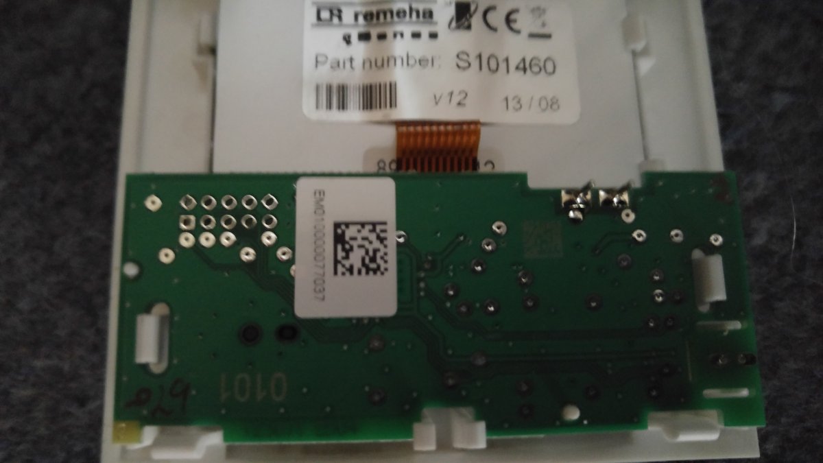

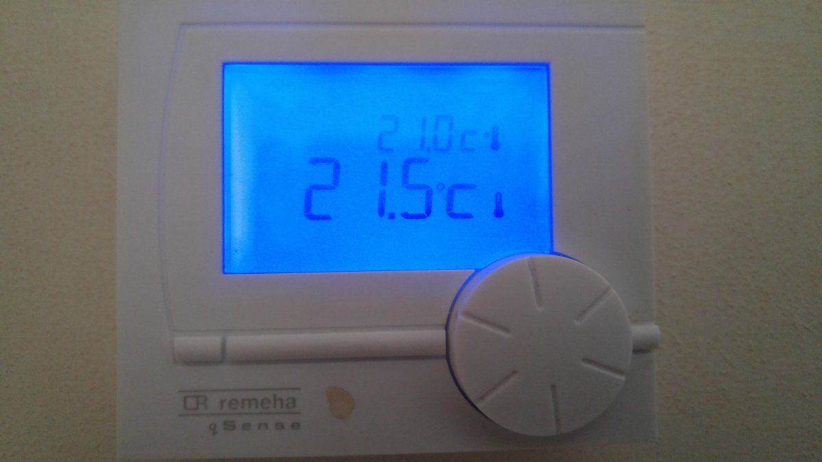

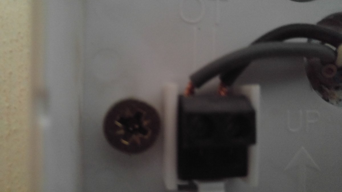

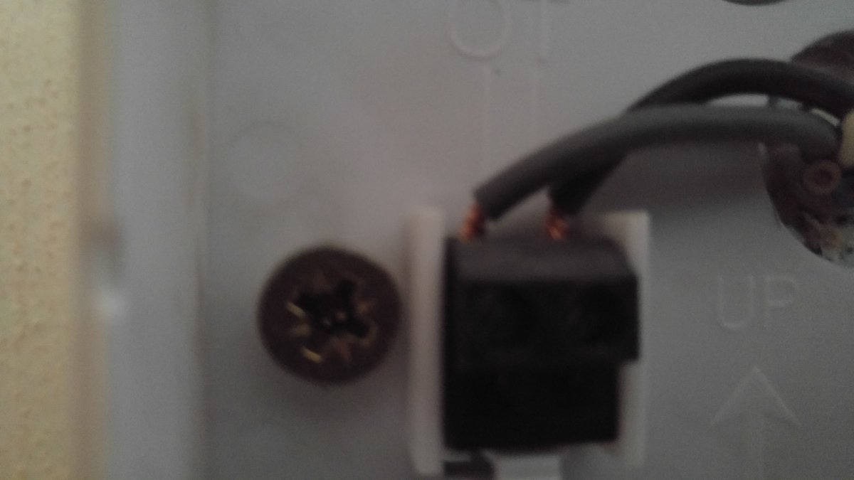

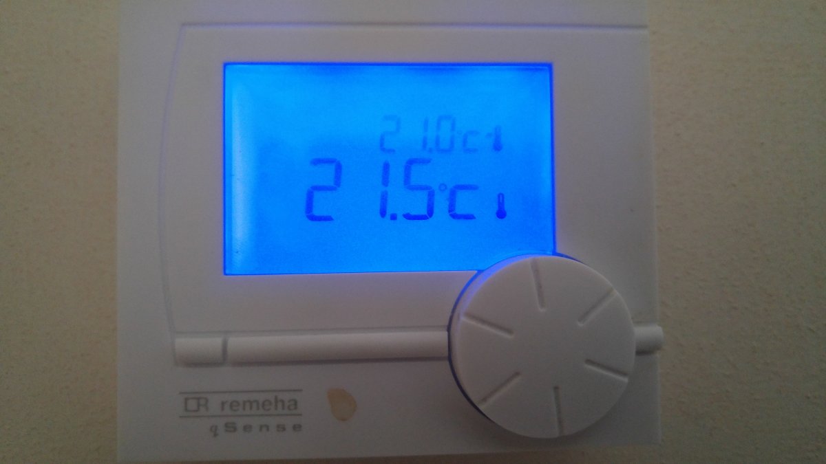

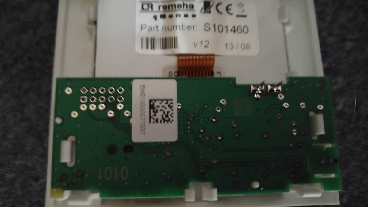

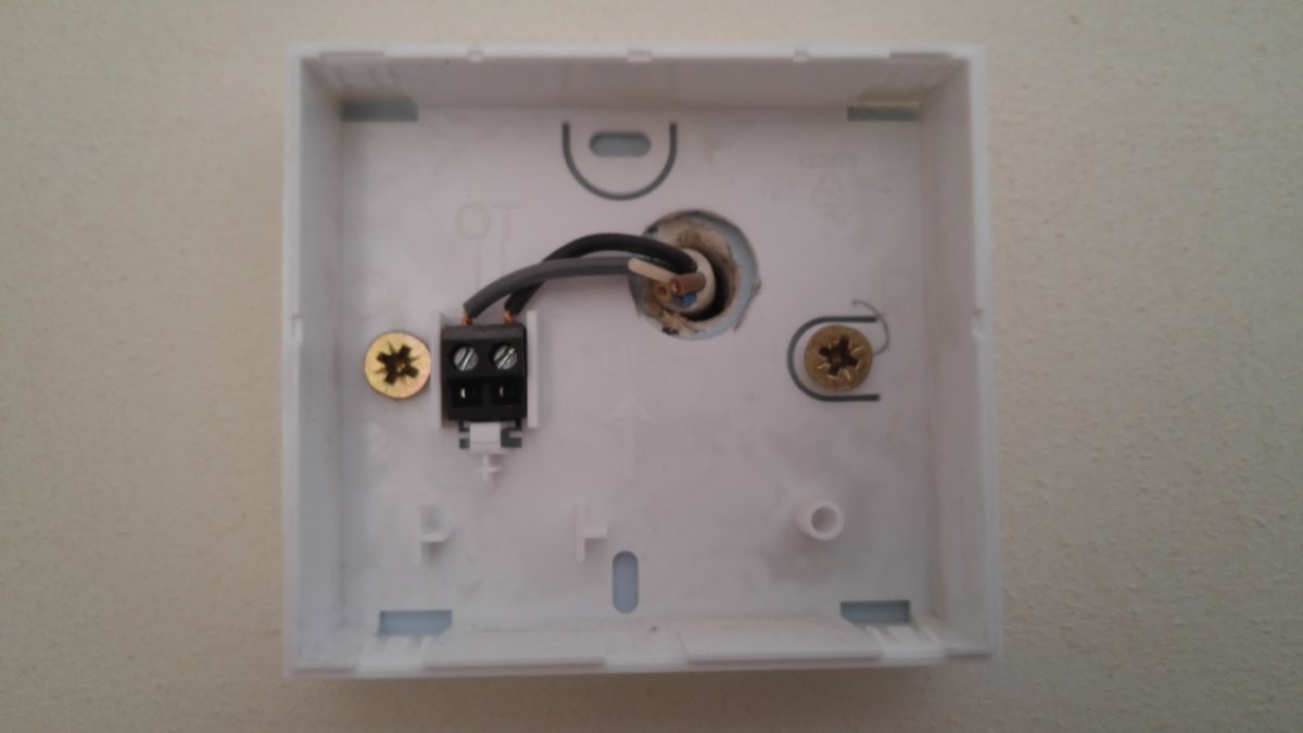

Hi i was looking for some assistance installing a Hive receiver please ?
I have a Remaha combi Bolier and Remaha Thermostat.
There's only 2 wires in the stat ( i was expecting more)
Which terminals in the Hive receiver do these 2 wires go to ?

To answer your question, normally, neither of them would go to the Hive. The Hive receiver usually would be wired into your boiler and the existing thermostat and wires shown in your photograph would be removed.
Having said that, there seem to be quite a few unused wires in that cable so you may be able to utilise it, but the extra connections would still have to be made at the boiler end.
