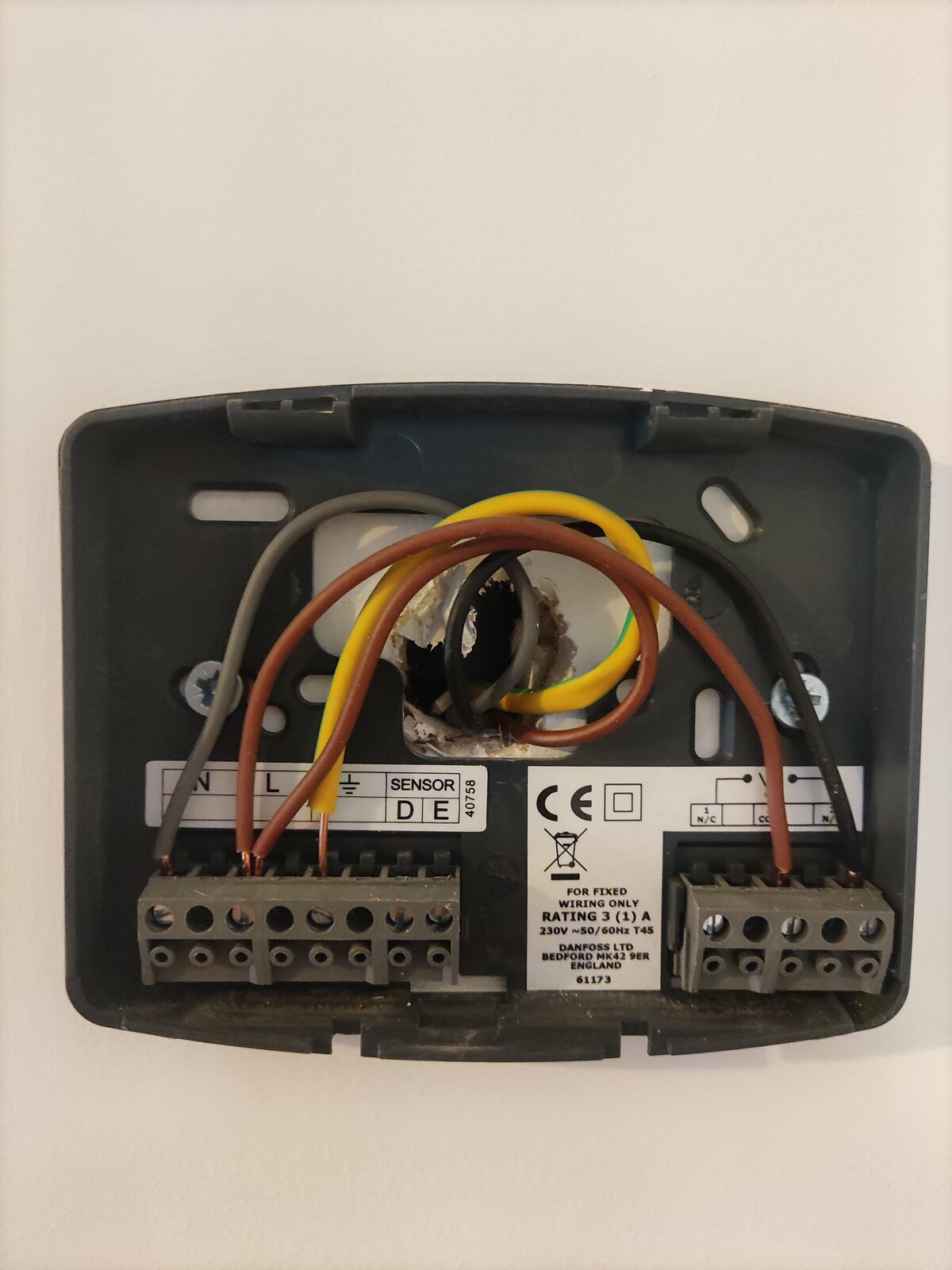

Hi,

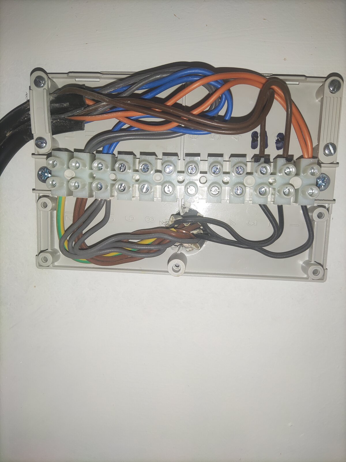

I'm trying to install two Hive thermostats. I've got upstairs and downstairs which is controlled by Danfoss HPA2 Port valves.
As I understand it, in the wiring control centre the top wires stay the same, they control the valves.
I'll need to:
Remove the two grey cables which connect to the blue cables.
Same with the black which connect to brown.
Same with brown which connect to grey.
Connect 4 core cable.
Brown to grey
Blue to blue
Black to brown
I'm not sure about both sides of Earth cable or if I need to connect any colours to each other within the receiver.

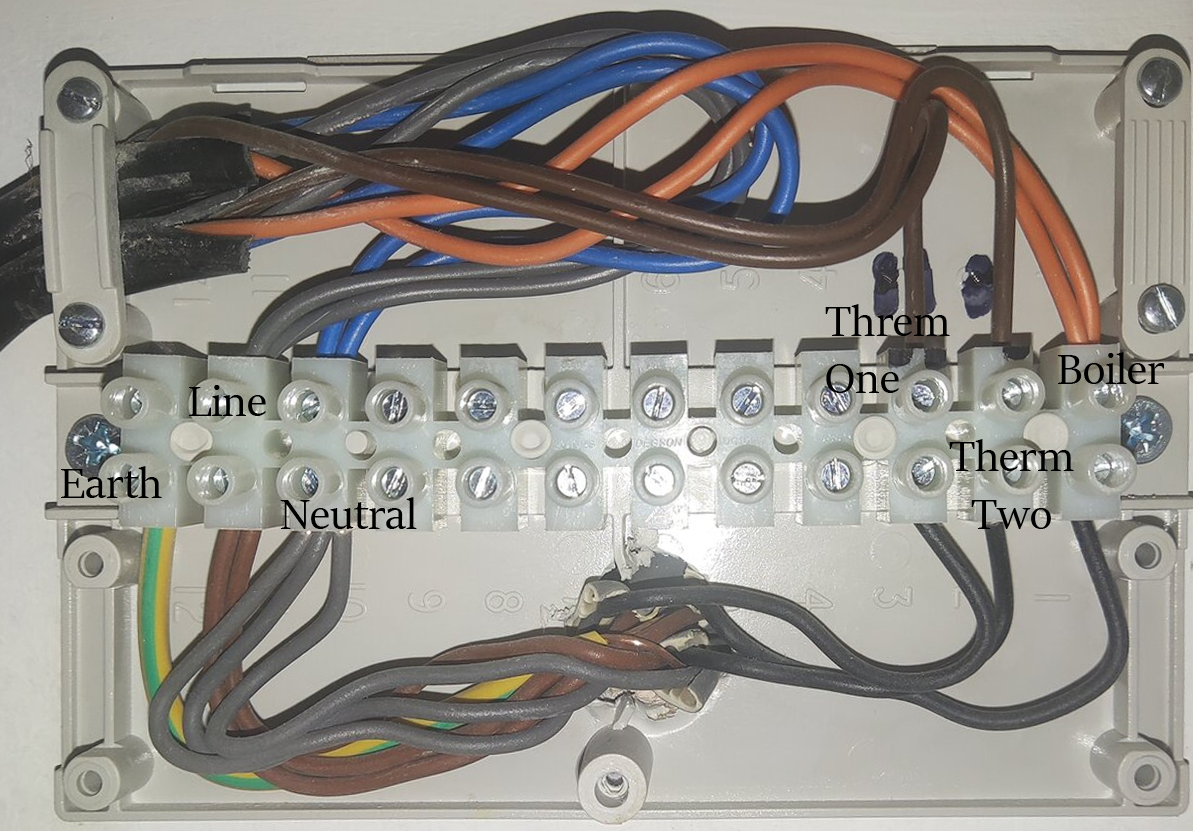

The two terminals second and third from the lefy with sharpie marks on the back from the left look to be the switched lives for your two zones with a three core to each stat position, so you want to take the baclsk out of there (label them up first), you also want to take the associated lives (browns) and neutrals (greys [should be sleeved blue]) out as well, but only the ones associated with the switched lives, you'll have one of each left along with the black which joins the oranges which want to stay in there (this is the three core which appears to go back to another joint box near the boiler (I presume)

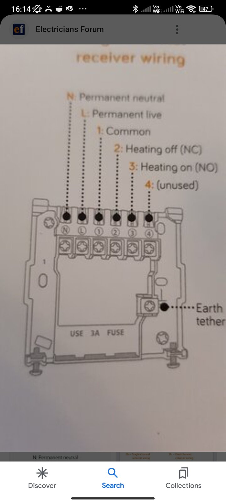

You'll need a five core flex, earth to earth, blue will be your neutral, brown is your live, and you'll have a grey and a black left which sleevd brown will be your two switched lives. Depending on how the receiver is, you might need to jumper live to common of the relays, or this might be done internally and the common wont be presented to you
If you’re not concerned about the receivers being on display, and if both Danfoss’ are wired up the same, why not just put the Hive receivers in place of them, transferring the wires over?
The wiring centre in your case is easy as the motorised valves wire colours show what everything is.

I'm a little confused about the jumper live to common... is that just a single brown wire from Live to 1?
