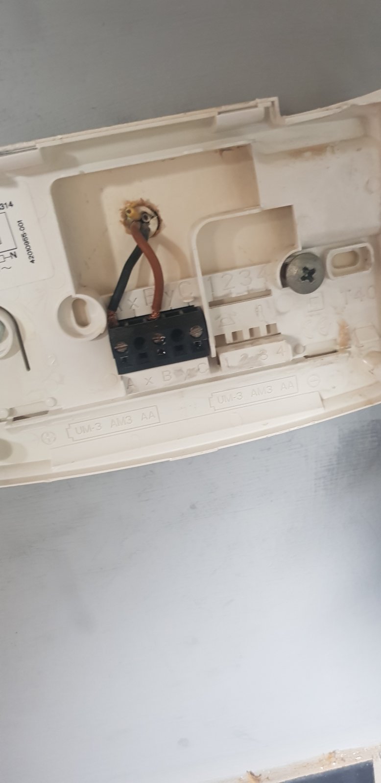

Can some one advise me on how to connect a hive single channel receiver to an ideal logic combi 24 boiler?
This is the current thermostat i am using

You don't give the make / model of your thermostat, but if I had to guess I would say it's a Honeywell CM707
If so, the wires presently in A & B are the switching wires and would go to the Hive single channel receiver terminals (1) Common, and (3) heating on. It doesn't matter which way around they go.
Your present thermostat is battery operated, but the Hive receiver is mains powered, so needs a 230V supply. As Muggles has said, you shouldn't open up the boiler casing, but instead you can connect the Hive (N) & (L) directly to the N & L 'load' terminals of the 3A fused spur that supplies the boiler, thus avoiding opening up the boiler casing.
Ianmcd is right about the positioning, but you could move the cable to have the receiver in a different location if you wish, and then the Hive Thermostat could be located where the existing one is.
Thanks every one for the replies, Stem that thermostat is a cm907 and i thought those two wires that are there are live and neutral? Where the hive will get its power from

That's OK the wiring is the same.
I thought those two wires that are there are live and neutral
No, they are switching wires. Don't assume they are L and N from their colours. When the CM907 switches the heating 'on' the two wires in A & B are electrically connected together inside the thermostat (it's just a simple on/off switch) and you would never connect a live and neutral together.......BANG!! :eek:

The Hive Thermostat is battery powered, and I made a suggestion already as to how to get 230V supply for the Hive Receiver.
