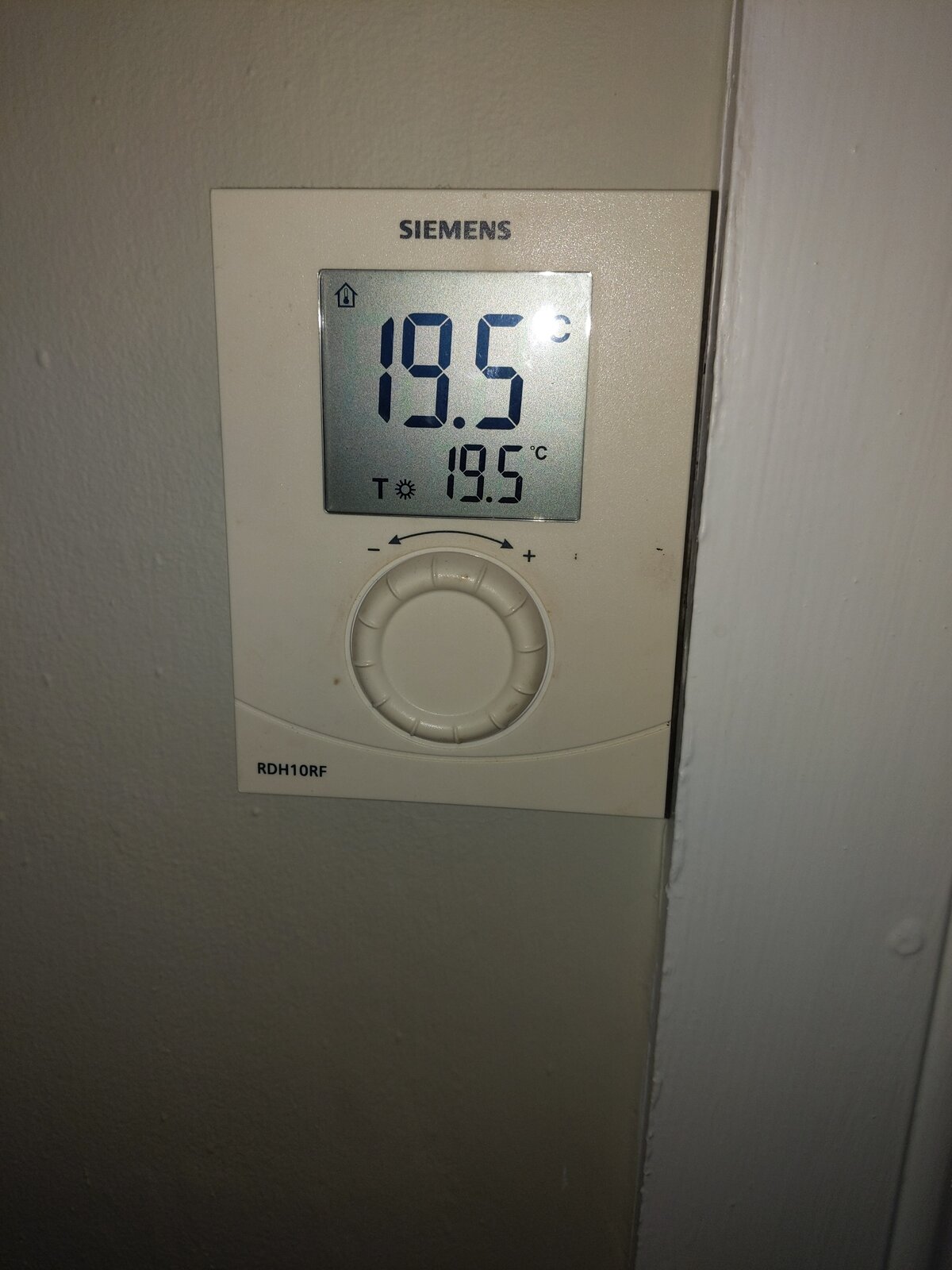

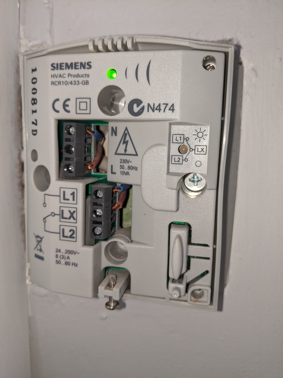

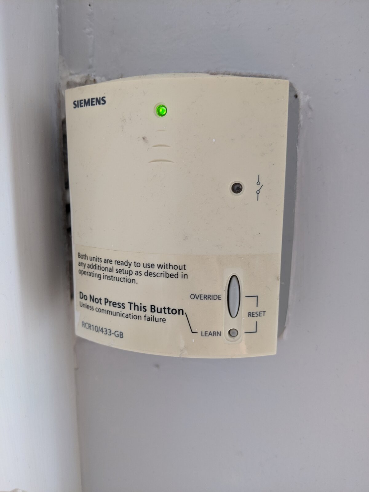

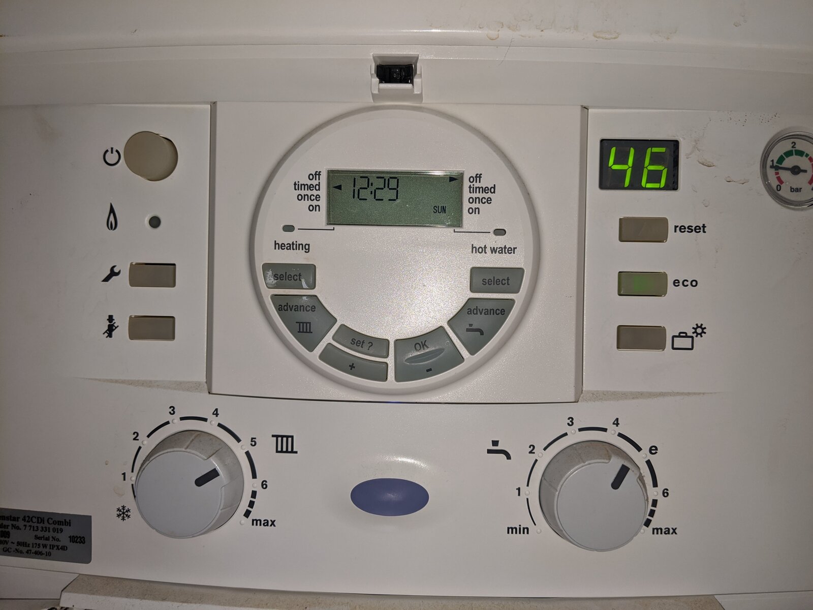

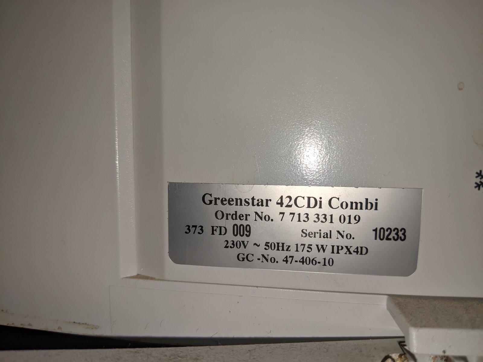

Hi I'm looking at getting the hive thermostat is it a easy enough DIY fit with my current set up. I currently have a Siemens wireless thermostat that I use just for temp setting. Programme such as what days and time for heating to come on is done via boiler thanks

yes single channel hive very straight swap, but you will have to disconnect the ribbon from behind the existing programmer on the boiler facia, or the hive wont work

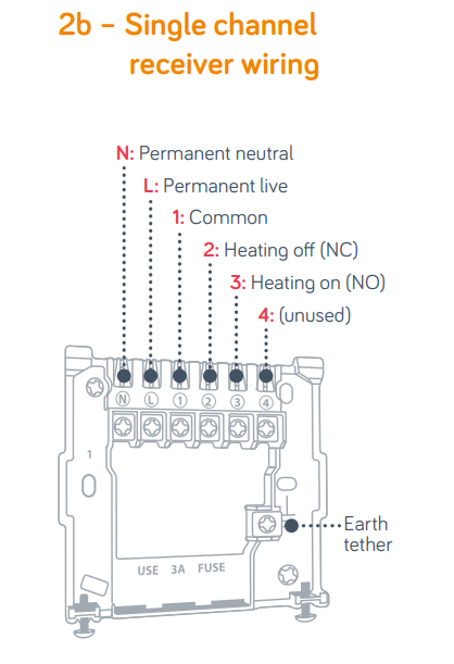

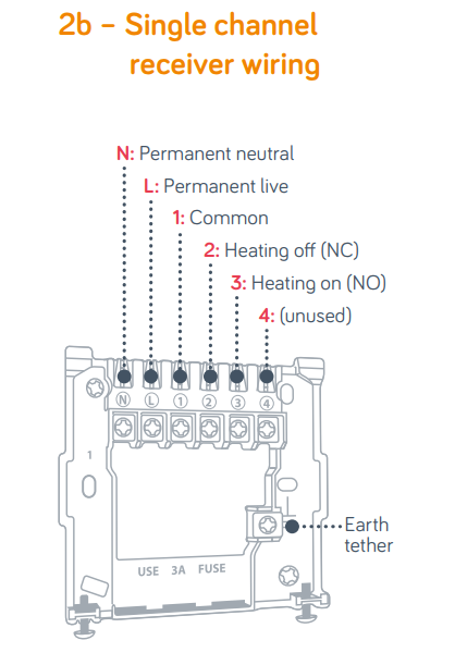

Thanks for quick reply would you be able to confirm where the wires need to go to the hive I think I know but want to.double check
L to L
N to N
L1 &LX to 1&3 on the hive doesnt matter which way around, but as already said you will have to disconnect the ribbon, no links needed
