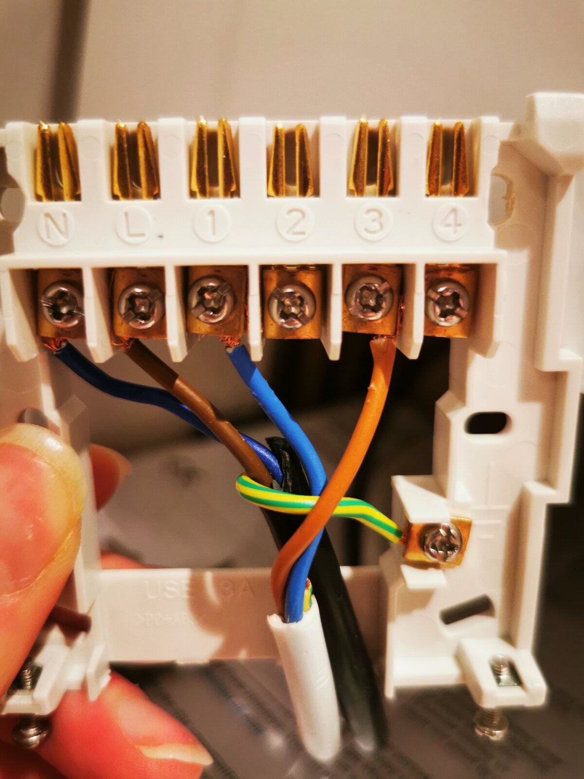

When I turn the switch on, with the wired settings I've attached, the boiler starts up automatically and stays on. Whatever I do on the app/thermostat it won't turn the boiler off, but I'm convinced i can't be the wiring if you guys suggest it's ok.
I'm using a Biasi combi boiler and the hive receiver is a Dual Channel receiver wiring, not sure what else to do from here

That would explain it.
Why do you have a dual channel Hive, when your original controller was single channel and you have a combi?
You've also added an unnecessary link between L and 1.
Ps. Single channel Hive was mentioned in post#2! ;)
Note to self, always ask if the Hive is single or dual channel...

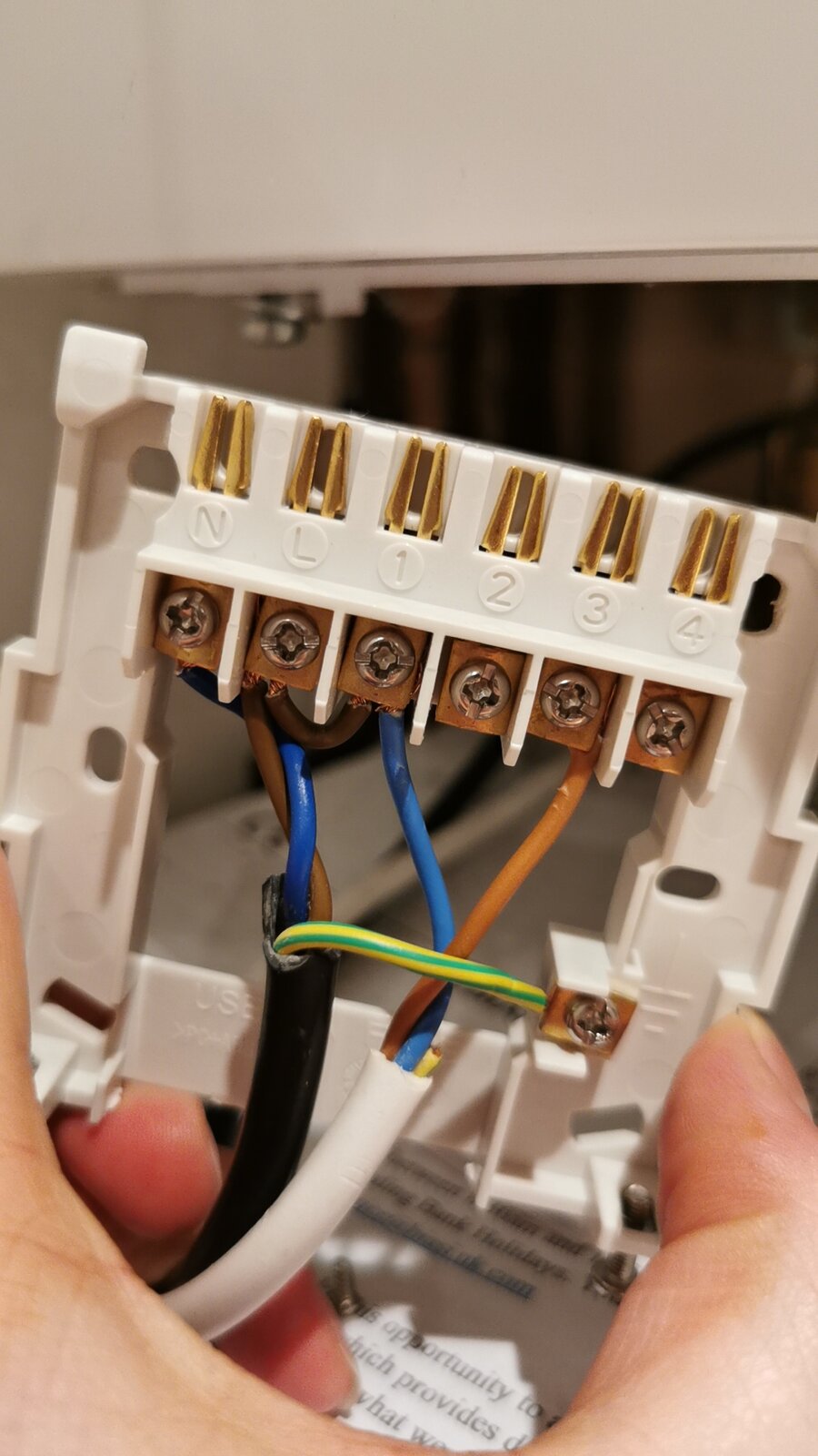

Ok I've done what you said and attached a photo of the new setup, this will still work on a combi boiler with a dual channel?
Leave blue out of terminal 1 and safely isolate in a connector block, move brown in terminal 3 to terminal 4 and see how you get on.

The one you wanted would have been named Hive Heating, or some call it Hive for Combi.
Your previous thermostat had volt free switching.
This meant that when there was a call to heat, it simply connected together the blue and brown wires.
The dual channel Hive works differently, it connects the terminals directly to Live.
You may have been very lucky. Some boilers use 24V switching - sending live down the cable, as you have done, could have killed the PCB.
As your boiler is still operating, it will probably be mains switching anyway.
As @CBW has said above, safely isolate one of the cables and connect the other to terminal 4.
As your heating was constantly on before, I suspect you need to connect the blue wire to terminal 4.
