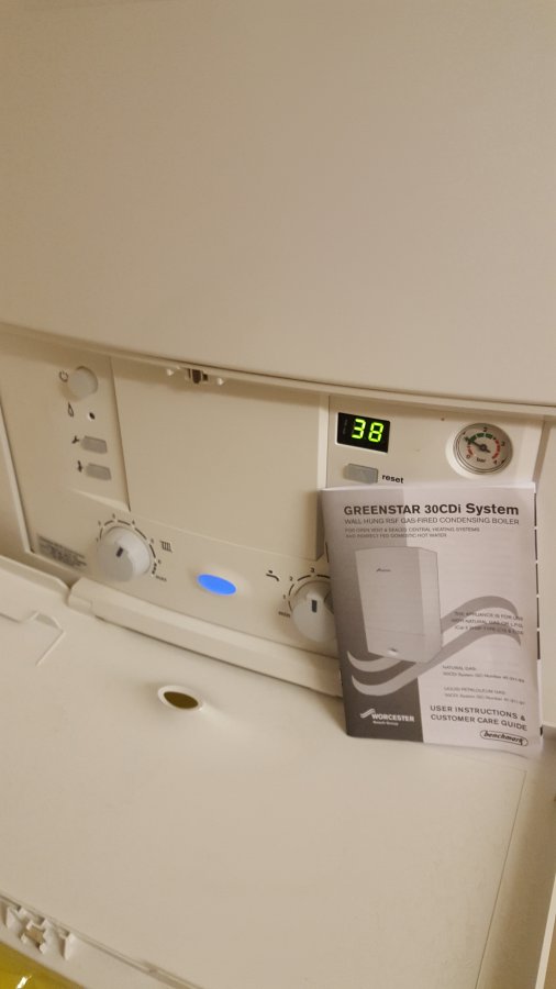

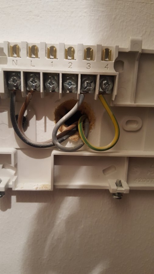

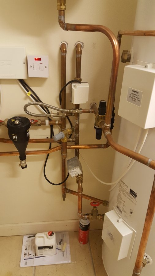

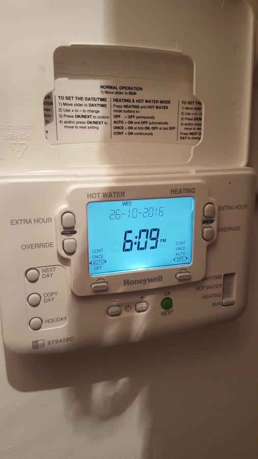

Thank you very much for your response. I've uploaded a few pics showing current programmer (honeywell), wiring in current programmer, and pic of boiler and tank. Hopefully these will help. My new hive device appears to require 6 wires, but my current honeywell programmer only has 4 wires going to it - earth, 2 lives and an earth. Can I simply use these 4 wires or is it more complicated and additional wiring needs done? If it's more complicated I'll of course get a qualified electrician to sort the job, but I was just trying to sort it myself if easy job.
Thanks.

Thanks for the photos that makes it much easier.
Yours looks a reasonable modern installation (some resemble more of a rats nest) so it shouldn't present too much of a problem. Unfortunately the green / yellow wire is being used as a live conductor, which is bad wiring practice. However they do correspond with the Hive nicely as below, so it will swap straight over. But do make sure your hive is the dual channel version with hot water control. Your type of system doesn't need any connection to terminals 1 & 2
Terminal N Black wire
Terminal L Brown wire
Terminal 1 (Not used)
Terminal 2 (Not used)
Terminal 3 Hot water 'on' Grey wire
Terminal 4 Central heating 'on' Green / Yellow wire
If you have an existing room thermostat, that won't be needed anymore as the Hive takes care of this function. So, you have a few choices.
1. Leave it in place and set it to the maximum setting, the Hive will then take control
2. Remove it, and connect the two switching wires together
3. Disconnect it from the wiring centre and connect the two switching wires together there
The preferred option would be number 3, the the room thermostat and the cable to it could then be safely removed, and there won't be unused live wires left in place. I can't advise further on this as you didn't give details of it.
Thank you very much.
I'm not why that live wire is earth colour, though I presumed it wasn't actually an earth.
My programmer has a wireless thermostat which I've located in a different room, so no wires to worry about then I presume. It will be redundant.
I'll give that wiring a go later when home from work.
Ah OK, if it's part of the programmer, then it will be a straight swap.
