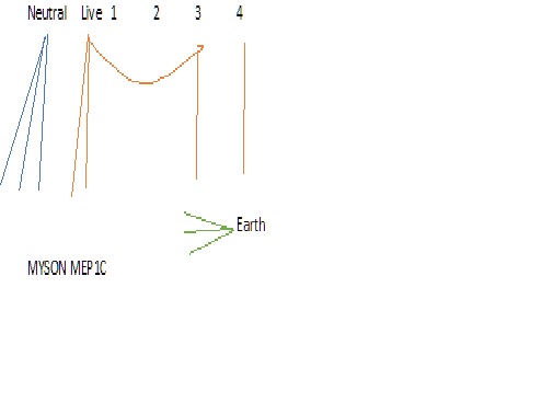

Logik 12 boiler with hot water tank with Myson MEP1c programmer.
Dual zone heating system- downstairs controlled by Myson wired stat in the hall and upstairs by wireless stat. (I only want to control the downstairs heating and HW at this time).
Now that we are all locked at home for the next few weeks I'm trying to install a Hive heating system I've had for a while.
When I install the dual Hive receiver using the wiring above I cannot get the Hive to take control of the central Heating- the Hive hub, receiver, and thermostat are working okay and the green lights on the receiver respond to the Hive thermostat but it won't override the stat in the hall; doesn't matter whether the hall stat is off or full on, the Hive receiver is doing nothing to heating.
The receiver does seem to turn the hot water on and off though.

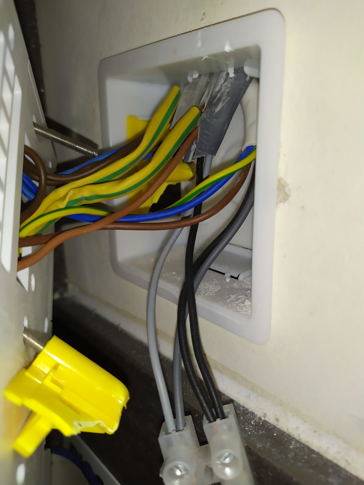

There are a couple of grey and black wires behind the receiver that are linked together- I don't know what they do.
Much obliged for any advice anyone can offer! Thanks.

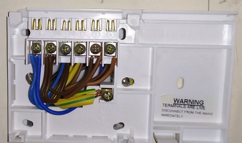

It seems I have been lead astray, the Myson MPRT is a programmable thermostat not a programmer. I have looked at the MPRT MS and the MPRT RF neither seems to line up with the internal pictures shown, the same base plate can be used for single, duel or three channel programmers, since terminals 1 and 2 are unused and 3 is linked to line I would assume one you show is a single channel wired back plate, Myson it seems does not use terminal 1 where Hive does not use thermal 4.

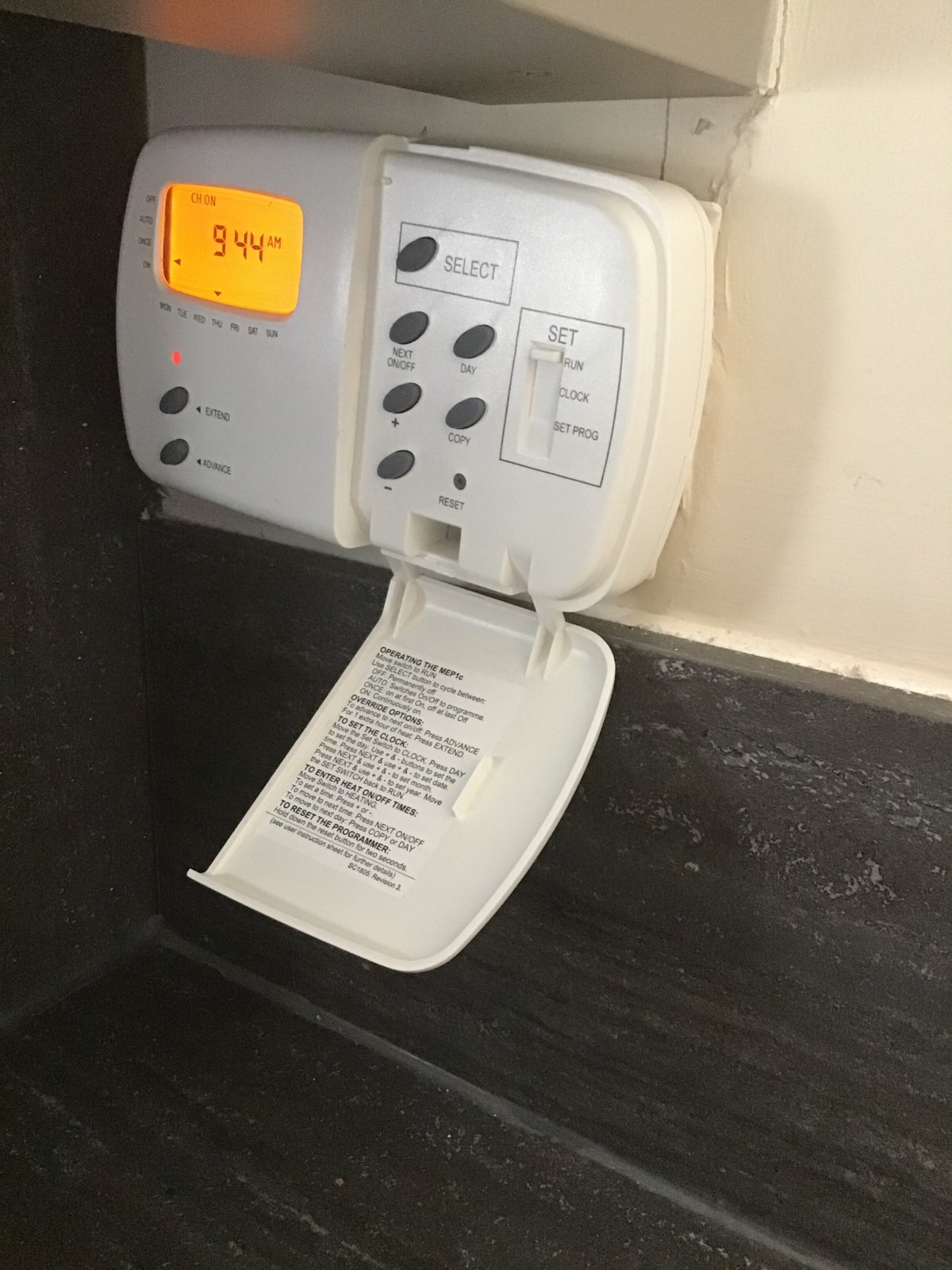

So as I understand it. You have a an Myson MEP1 controlling only the hot water heating, ie this:

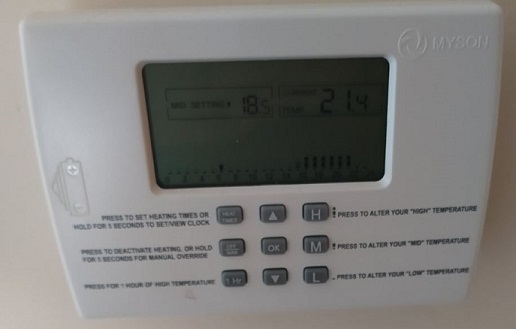

Then a Myson MPRT controlling the downstairs heating. ie this:

And you wish to replace only the wired MPRT controlling the downstairs heating with a Hive (if so Single Channel Version is required) is that correct?
However, I am puzzled why you want to do this. The MPRT is a reasonably sophisticated device, it has advanced control facilities that the Hive does not. It is smart in that it learns your heating requirements, varying start-up times to ensure that your home is warm at the time you want it to be, and saving energy. In my opinion you are replacing the Myson with something not as good.

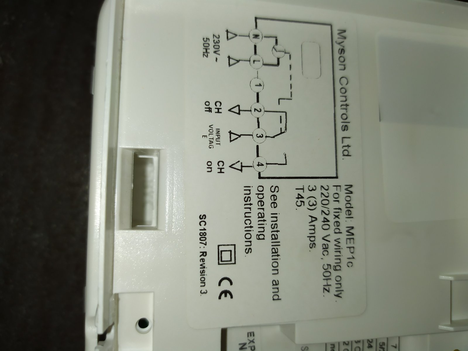

There is a brown wire in the programmer linking the live terminal to terminal 3 which I think powers the HW. I have removed that link with no effect on the CH.
Terminal 4 on the hive receiver is marked as CH ON which coincides with terminal 4 CH ON on the Myson programmer-see photo.

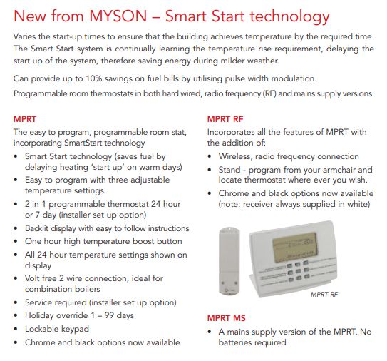

Exactly as you describe! I’m sure the Myson is a not a ‘learning’ thermostat. It does its job quite well however I managed to get the Hive stuff at a really good price and i just fancied having the option of remote control using an app on the phone!
The problem you have is that the MEP is controlling the hot water and the MPRT the downstairs heating. The Dual Channel Hive does both in one unit. So, if the MEP and MPRT are not located closely together, then there could be some rewiring involved to bring the wiring from both together at a common point. Much will depend on how the original installer chose to wire the system.

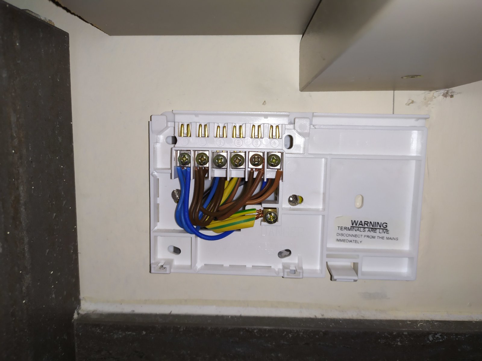

Lets start with the MPRT. It should have wires going terminals like the drawing below, but with a cable cover over the top.
I would expect to see two wires connected, one in each of the bottom two terminals. Is this correct? and if so, where do the wires go and what is connected to the other end of them?
Info on the Myson stat below, AFAIK, unless it's been added recently, Hive doesn't have a learning algorithm:
Thanks for your time on this. The MPRT is how you describe with 2 wires into a wall. It is in the hall with the MEP 2 rooms away in the utility room. I now remember reading about the Myson smart Start!

Feel free to shoot me down -the MPRT in the hall, which controls the downstairs heating, backs into a cupboard where I can probably access the 2 wires that Power it. The cupboard also has a 3 pin socket. Can I take the 2 wires from the MPRT, use them in the hive receiver and power it by a plug (or wire it into a socket) and then control the receiver with the hive thermostat? Just a thought!
