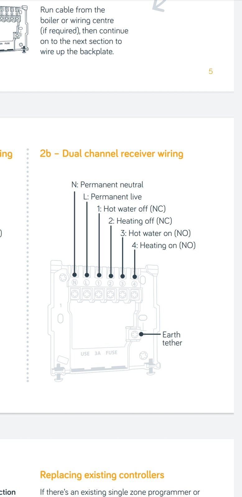

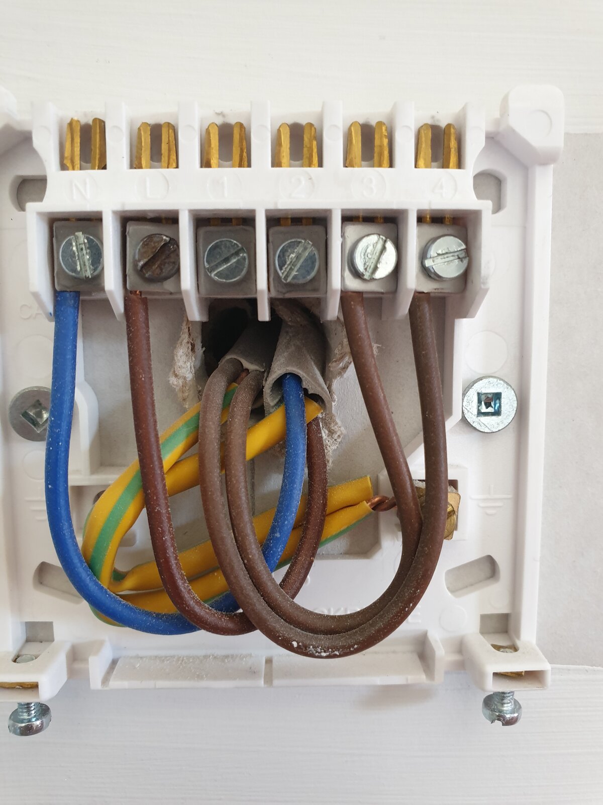

can anyone help with wiring my hive heating system the wires same to be different on the old controller.
Is that the back panel of the controller or a thermostat? Please state make and model, or photo the wiring assignments.
Its the controller. Its a centaurplus c21 series 2 horstmann.
This is what I need as per the hive manual
The dual channel Hive is a direct replacement for the Horstmann, it will probably fit onto the old backplate.
If there is a separate room thermostat, that will need to be removed and a link installed instead.

re a link. You need to understand how most systems are wired. When the time to enable The heating comes around, the programmer (your Horstmann) sends a live out to the thermostat(s). If it’s cold, the thermostat returns the live back to the boiler which switches on.
The Hive has its own thermostat. So you will need to disable(link out) the old thermostats. If you don’t, you’ll only get heat when the Hive stat is on AND the old stat is on. And you don’t want that!
The best place to disconnect will be at the wiring centre. You could do it at the thermostats themselves, but you done want to do that because you’ll want to take them off the wall and plaster over the hole.
So, find your Wiring centre, that’ll be where the heating valves are connected.

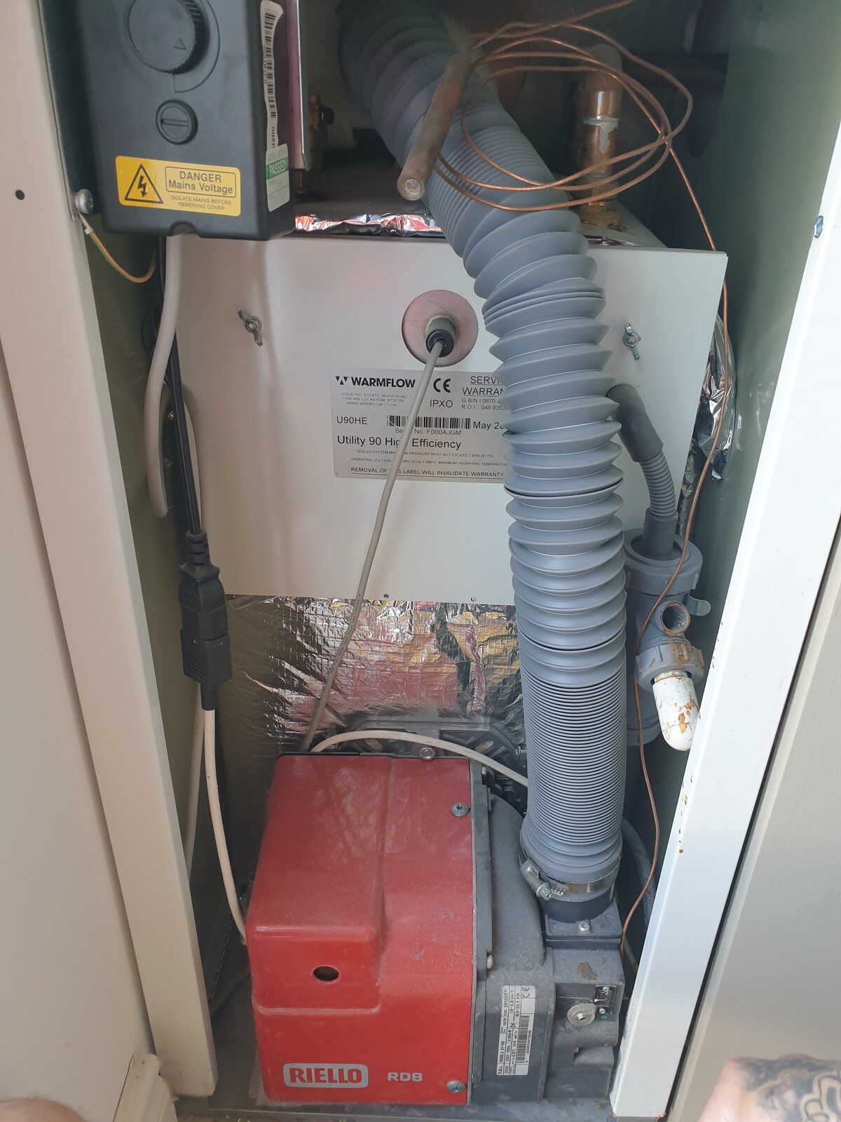

Yeah I'm happy enough just having it the way it is if possible. At the min I have an upstairs thermostat and a downstairs. Just not sure what I need to do to them if I connect the hive controller. My heating is oil fired also
Likely if oil fired it is not likely OpenTherm so Hive is likely good option, however we don't know how your system is set up, I also have an oil fired boiler and I had to fit relays to get independent control of main house and flat, but that is mainly as I have two pumps, and two motorised valves and thermo syphon domestic hot water with no water temperature sensor, or DMW motorised valve.
Pictures are good, non of us have a crystal ball, need to know what you have.
