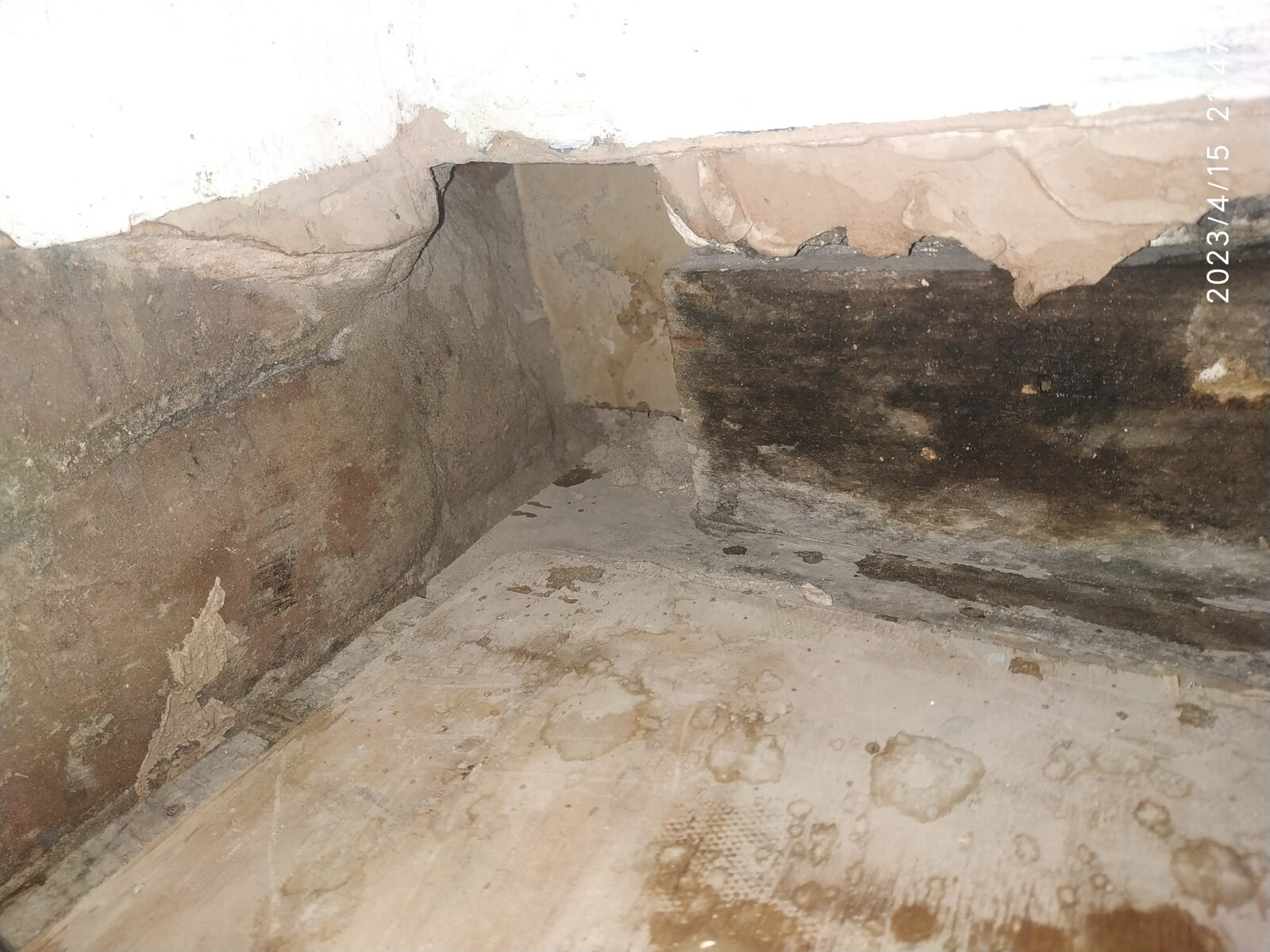

Hi Gents,
After removing old skirting boards I discovered a hole in the wall. Not sure if this is some old school ventilation in the bathroom but it's too big to my liking.
On the picture on the left is the outside wall, on the right it's internal wall made of plasterboard.
Should I brick it up?
This is almost a century old house. They had all sorts of tricks back in the days. What I also noticed these wood pieces between the bricks I reckon to cleverly exchange moisture between inside and outside. But this is something I discovered downstairs not in upstairs bathroom.

Sounds like they are what we call 'twisted plugs' to me -- little pieces of timber cut down and hammered into the the gaps between bricks (in place of mortar). Their function was to allow the fixing of skirting boards which could be nailed into them. A fixing method used in lots of other applications, too but rarely seen anymore.

Great. Thanks for explaining that because I removed one from the wall then I thought it maybe serves a different purpose.
Obviously can't be sure without a picture, but that's what they sound like. They won't be used to exchange moisture otherwise they'd have rotted decades ago.
I think you are right because this solution is from previous era when nails were the thing before wall screws

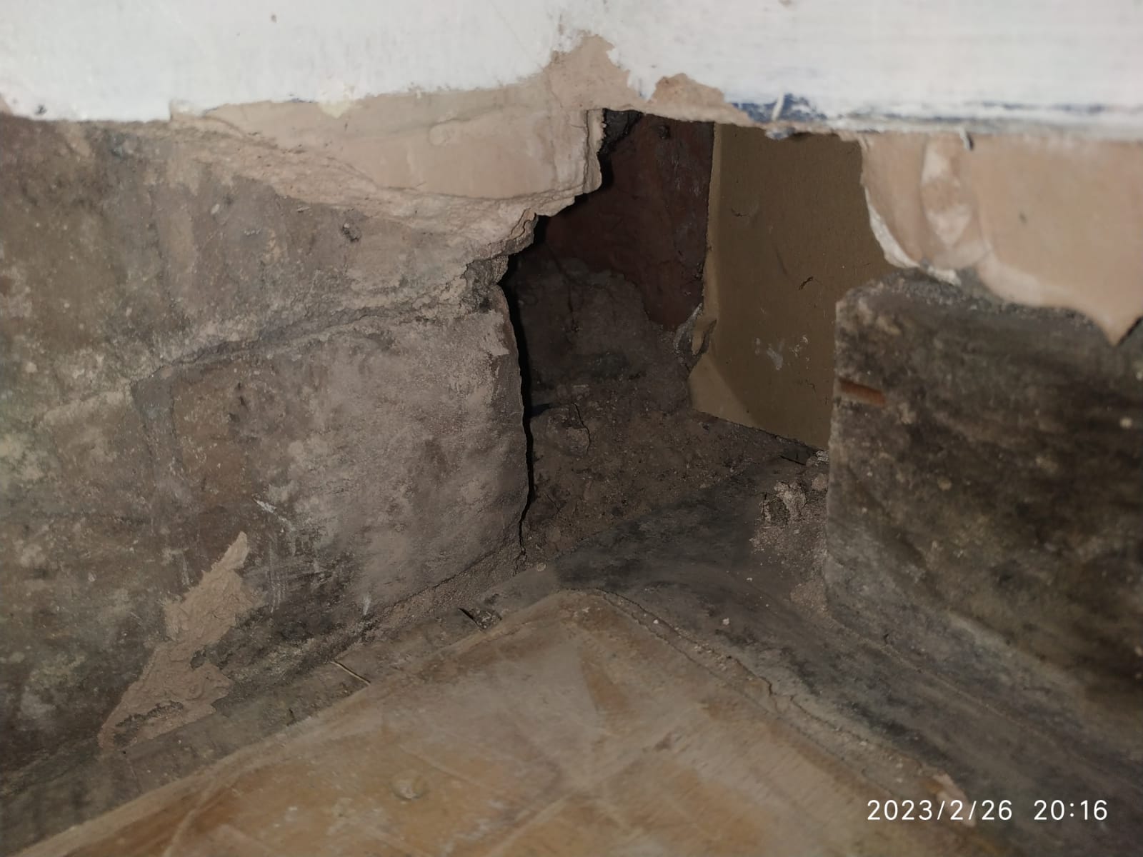

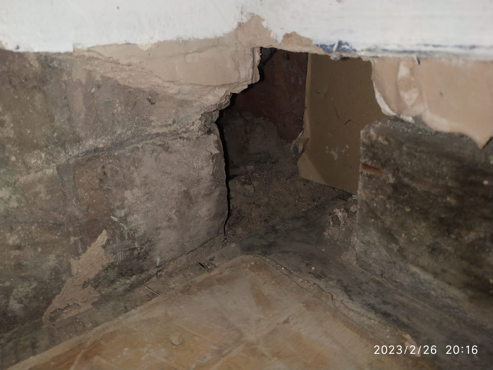

This is how it looks now.

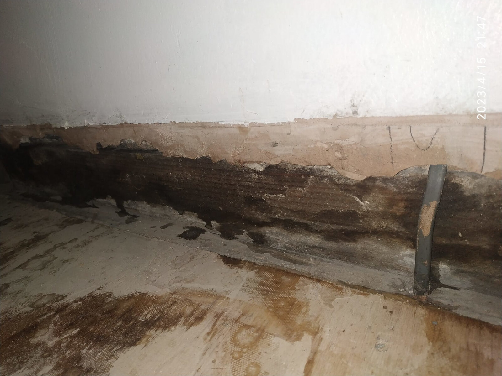

I have to now plug the other bit. This old house has this wooded something.
How should I fill this? Can I plaster over this wooden thingy?
Do they put this to attach skirting?
